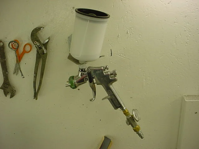

Radd Cruisers said:
Really really nice work.
What gun are you using to spray with?
How did your countertops turn out?
Rob
Thanks in the compliment
The gun I use is a Campbell Hausfield DH7900 HVLP gravity feed gun. Not the most expensive thing in the world, but works very well. The friend of mine who is a body man for a living has some expensive stuff, we can never tell the difference from what he sprays and I spray.
