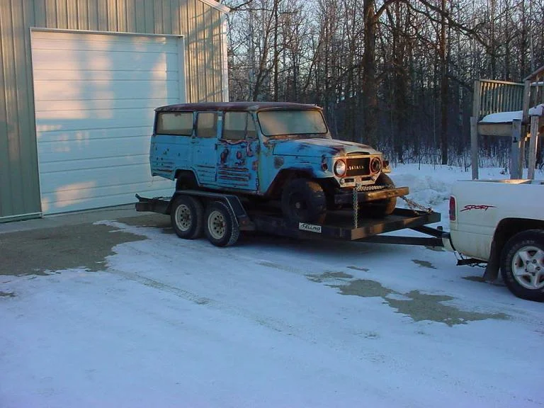

What Brett said, he's the guy I bought it from down in the So.Cal area back in Febuary. I would imagine most in the Minnesota area have been re-claimed by the earth.

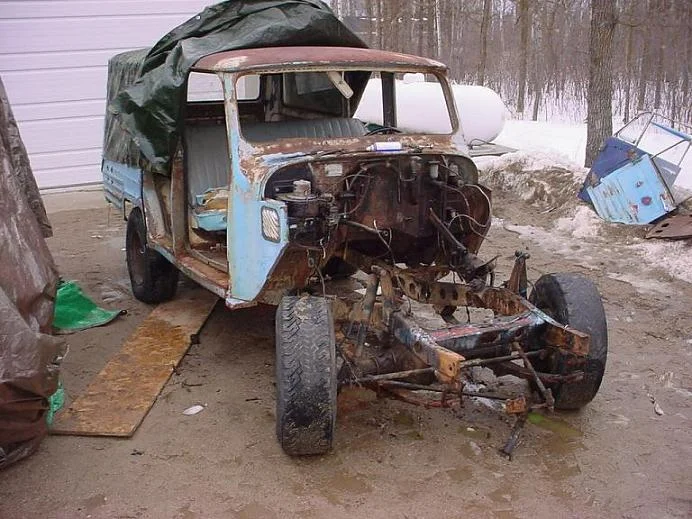

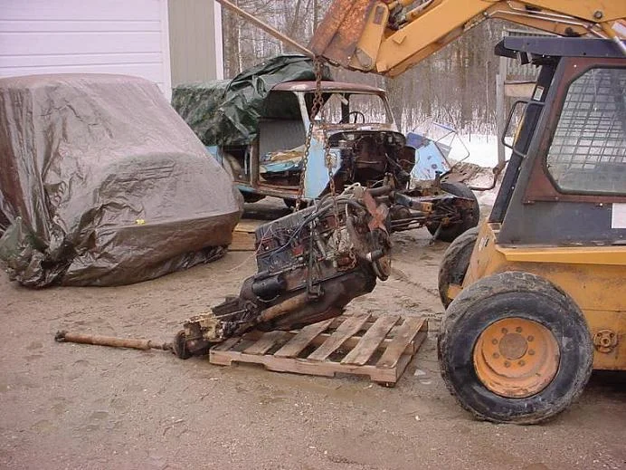

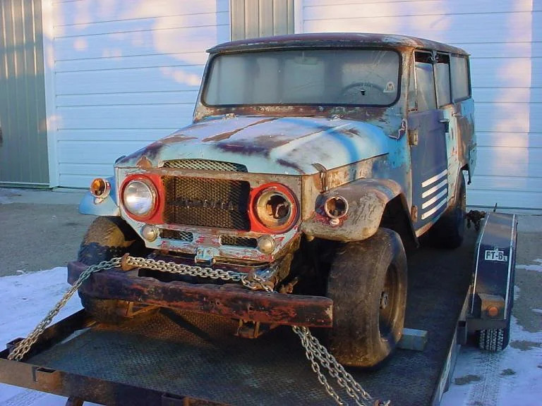

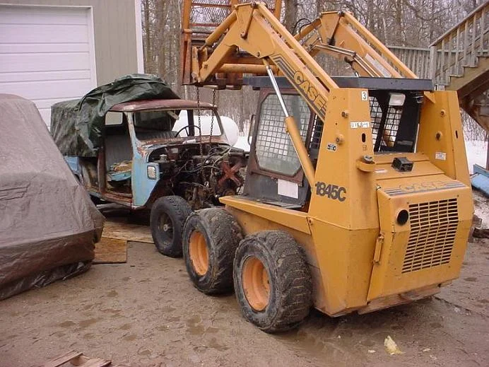

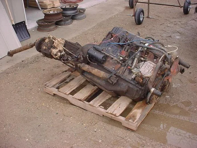

I will keep the pics coming as progress is made. I tore apart the front clip, doors and other misc. things yesterday afternoon. Plan is to pull the stock motor and drivetrain this evening. I am probably going to trailer it up to friend of mine on Tuesday who is a body man, he has a frame rack. I have boughten all new / used parts for the front end. Every front clip part was bent up and full of bondo, just wasn't worth trying to fix. After pulling the bumper and parts I noticed the frame is slightly swayed to the driver side, not bad, but it has to be put in a frame rack and pulled straight before I weld in the motor mounts and saginaw plates. I imagine it was hit in the front end sometime during it's life, hence all the filler in the front sheet metal.
Plan is to get the new drivetrain in this weekend, should have lots of pics after that. Bought some steel a few weeks ago to build a body rottisseri, gotta weld that up before the weekend. I'm going to mount it to that so I can roll the body inverted and start on the bottom.

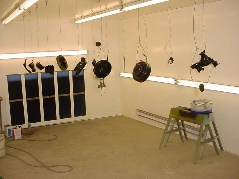

Few more pics of fun from later this afternoon. It looks crude, but I want to get this messy stuff out of the way outside before I bring it in the shop.

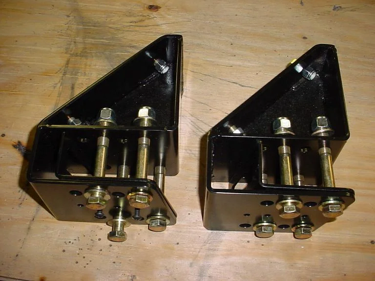

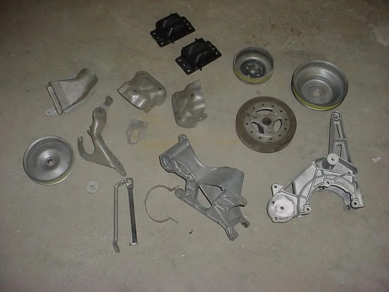

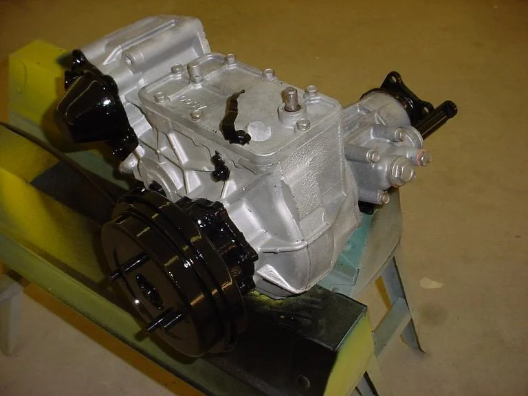

Worked on the 350 a little this even, got most of the acc. bolted on, few pics
Also, do I have my mounts correct on my rear AA T-case bracket? AA says small donut on the bottom and large on top, but in the pic in there instructions the small donut looks like a smaller dia. Both mine are the same dia., just one is thinner.
Thanks, Matt

Loaded up the LV tonight and brought it up to a friend of mine who owns an auto body shop. He has a frame rack and I wanted him to take a look at the front end, since I noticed the frame was swayed to the driver side slightly when I took the front clip off.
After some quick measuring on his part he determined the front end was about a 1/2" out of square to the driver side. Frame rack not needed, but porta power and torch was. Some precision heating, targeted porta powering and a little BFH'ing, all is well and square now, amazing how fast he did it.
When I had it up there this evening I noticed the passenger side shock tower was bolted on instead of buck riveted. With a cast piece like a shock tower, I imagine if it got hit on the side it wouldn't have bent, it would have broke. With the amount of filler in the front tin and the shock tower, must have been hit in the right front corner sometime during it's life? Oh, well....nice and straight now. :)
