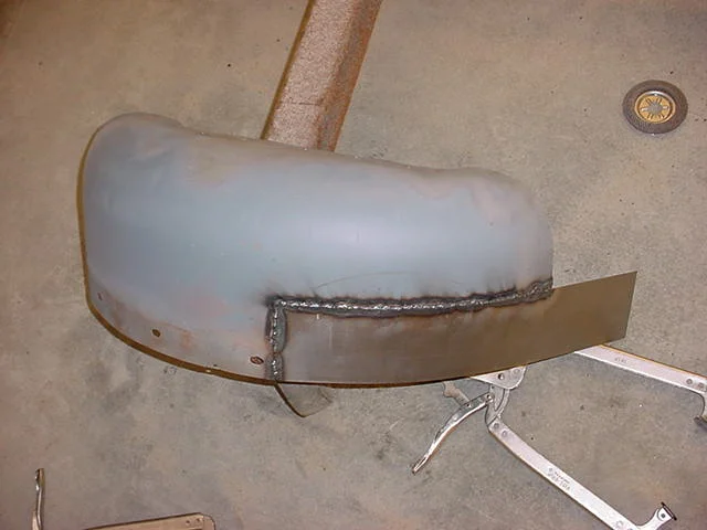

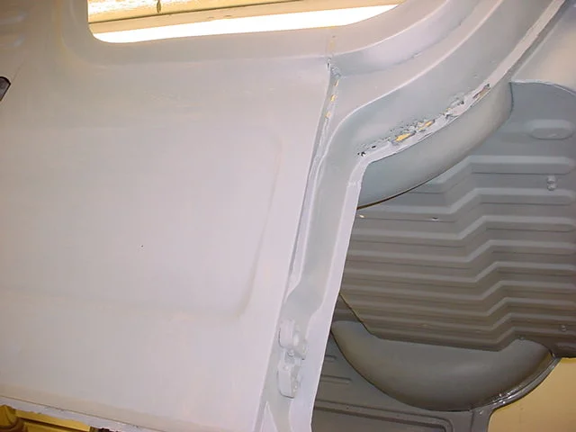

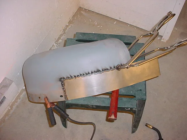

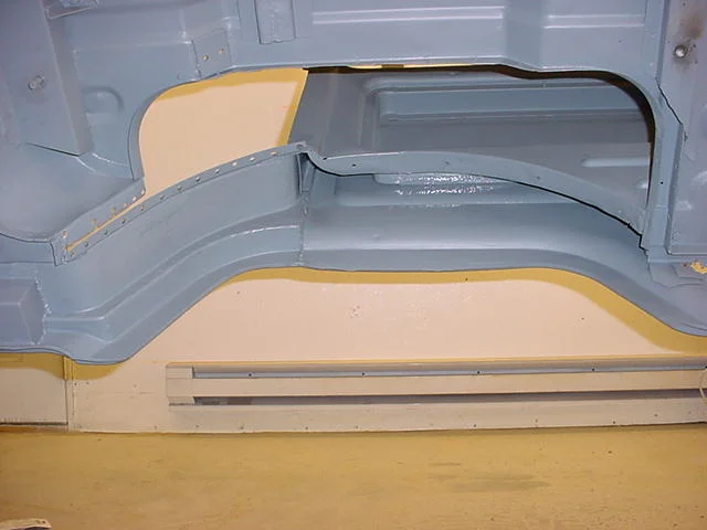

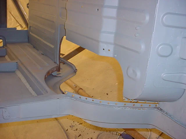

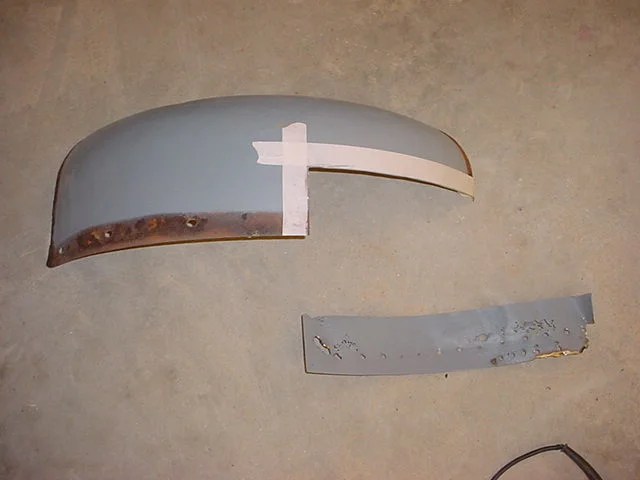

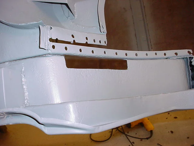

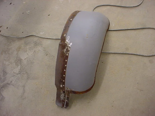

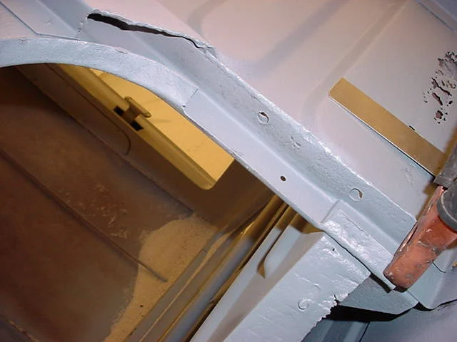

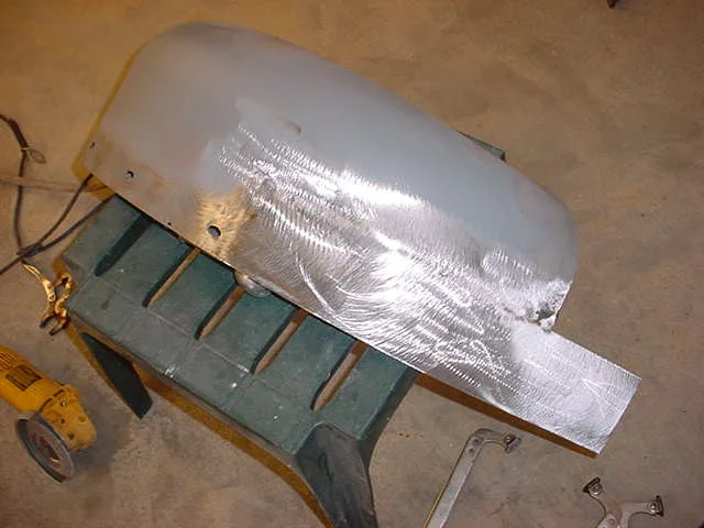

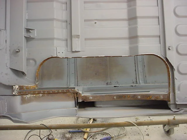

Not a whole lot to show, got one of the wheel wells out. Had to cut some more metal and weld new stuff in. Both on the body and the wheel well it self.
Not to hard, but about a 8 hour job for that wheel well. The other one might take a little longer because it is worse. Also, might a have to tear into the rear quarter panel on the other side because the C door post is bent in. It would be a little easier to straighten if that quarter panel was off.
Anyway, lots of pics. Also didn't get to work on it Saturday, only Sunday. I hit that car show Saturday afternoon. That was good, because it got me pumped up again. :)

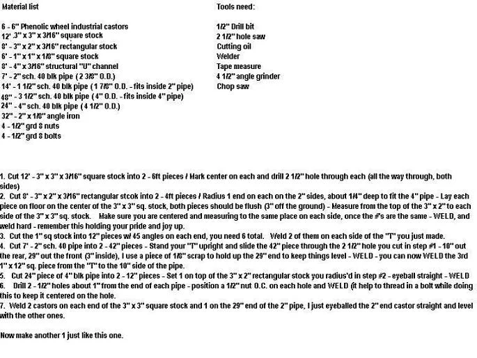

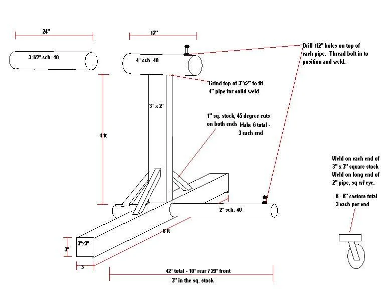

Just wanted to bump this thread.. Going to try to build this. Buck, could you measure the floor to the highest point of the wagon when its on the rotisserie for me? I want to see if this plan will have enough clearance... also, how much room do you have to play with from the bottom long pipe to nearest point on the truck?
thanks In advance.
buckroseau said:
I didn't plan on posting this, but I've had 2 fellow mudders email me about this. So I figured if 2 people are interested there might be more.
I whipped this up using Microsoft paint very quickly for the first guy that emailed me, so it might not be the greatest to understand :confused:
If someone is interested and has a problem understanding it, let me know and I will try to clarify it or change it.
Matt
I will run out to the shop tomorrow at lunch and do some measuring.
I do have a general guestimate on the overall height right now. The inside of my paint booth is approx. 8' 6" from the floor to the ceiling. I can't rotate the body inside the booth into the full upright position. The drip edge will hit the ceiling when I try at approx. a 45 degree angle or maybe a little more?
But, if my paint booth door was taller than 8'. I could rotate it fully upright and then roll it in. I would guess that when fully upright, the roof would be roughly 8' 4" ish......
When the body goes fully inverted, there is roughly 12" + between the roof and long pipe when it is upside down. I would say that the 2 uprights on the end could have been shortened by maybe 6" or more? I may have been able to turn it a full 360 degrees in my booth if they were 6" shorter, maybe?? The way it is now I can get it in my booth when it is sideways or upside down. I can rotate it about 320 degrees, I just go back in forth, works fine.
Now if I understand this question correctly, "also, how much room do you have to play with from the bottom long pipe to nearest point on the truck?"
I just answered it in the previous paragragh, correct? But I will confirm my measurements tomorrow.
Matt
yes you answered it correctly... your on the right track. I think i have 100" or 8'4" of height to use up.
Sounds like I have enough room if I take out a few hallogen lights... however it will be planted in the garage.. no outside spraying as the doors are about 84"
Mike,
Took some measurments at lunch today, I only got one though. If you need more, let me know but I will have to pull the lv out of the booth to find out the highest measurement. I don't think I will have to because I will give you the bottom measurement and the height is just is what it is.
When I rotated the body at a 45 degree angle with the roof drip edge at the closest point to the lower pipe. This would be the lowest the vehicle can get at this angle. There is approx. 7 1/2" of space between the roof and lower pipe. Now, one thing that shortens this measurement up is my 2 - 1/2" set screw/bolts welded into the lower pipe to set width. If I take that into consideration it is about 6 1/2". You could weld the set screw/bolt on the side or bottom, that way it wouldn't be in the way.
As I said, you could shorten that 3" x 2" upright from 48" to 42". When you get ready to mount the body let me know. I can take some specific photos and measurements as to where I mounted on each end. You will need to know, because your tollerances are going to be tight. 1" or so wrong in height it might hit?
Let me know if this is what you need?
Matt
