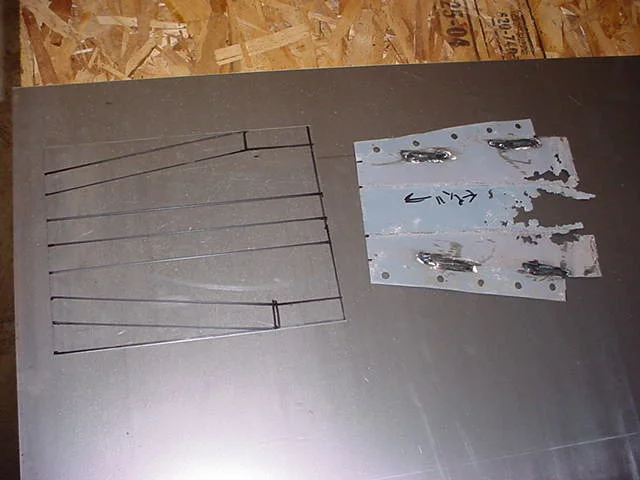

Shear, Dewalt DW891 heavy duty shear, handles up to 14 gauge metal. Dewalt and others make lighter duty one, but I have the heavy duty, never know if you'll have to go through some heavy stuff? My bench shear/break is a 52", but it can only handle up to 20 ga. Sometimes the hand shear has to do a little heavier stuff. All my replacement parts yesterday were made in my bench shear and break. I did have to hand bend one of the bends on the rocker, because of the radius.

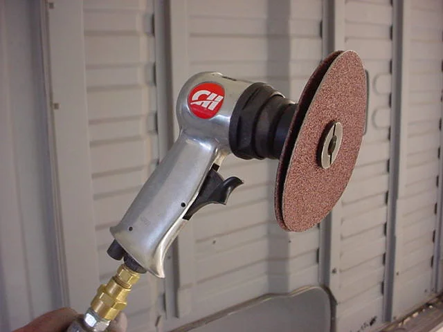

Yes, I grind all my welds flush. 2 tools used to do this: Any 4 1/2" angle grinder, I use a 36 grit 4 1/2" flap disc, I'll take a pic today and post it tonight, works WAY better than a grinding disc. Smoother and more control. Also an airgrinder, I use 2 - 4 1/2" resin dics stacked on top of one another. The airgrinder with the discs has more flex, so it works well in corners and uneven surface's. I'll take a pic of that also.

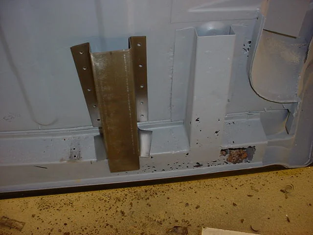

After I cut that metal/rocker out, I sandblasted everything in that area. The took pics, but didn't clarify that in the pics, you can see surface rust in the first few pics, then blasted, then primed. Then I started welding metal.

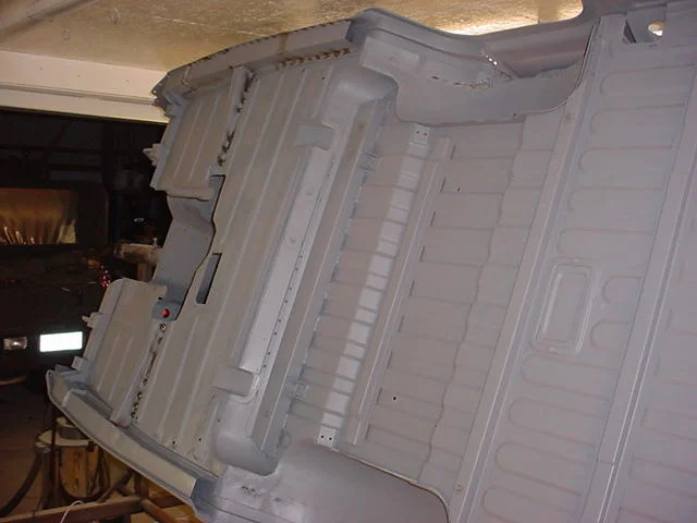

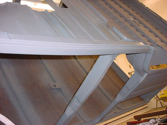

About a 10.5 hour day today :) I know it doesn't look like much, but this is ome time consuming s***.

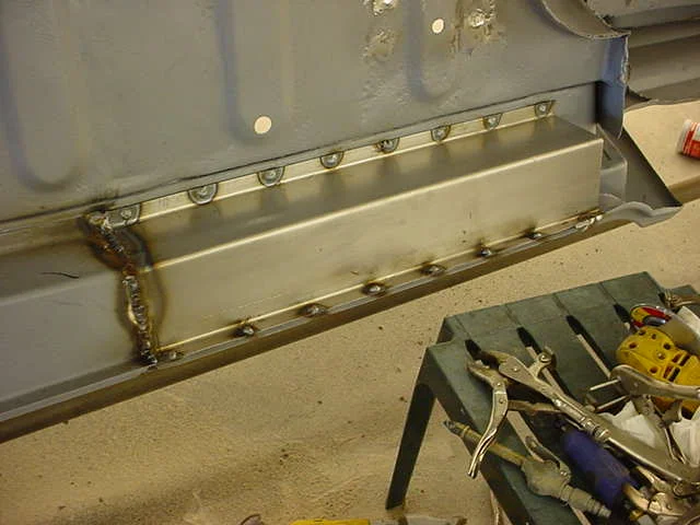

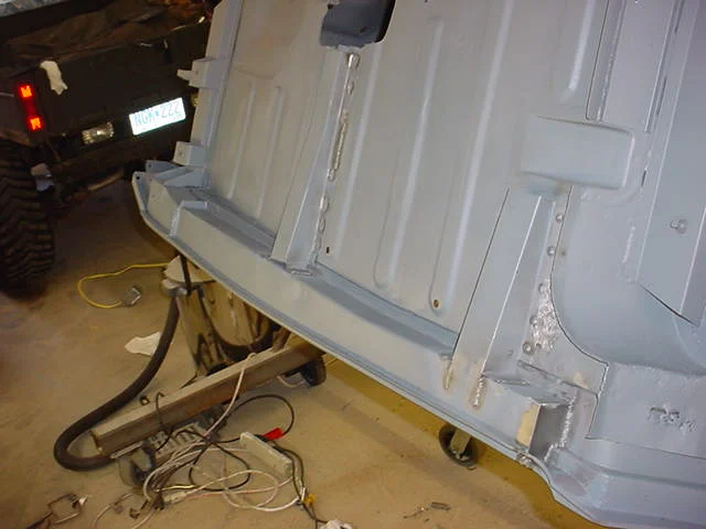

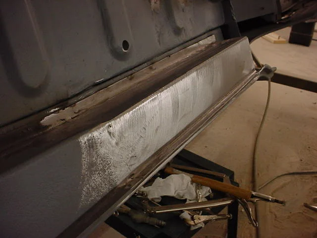

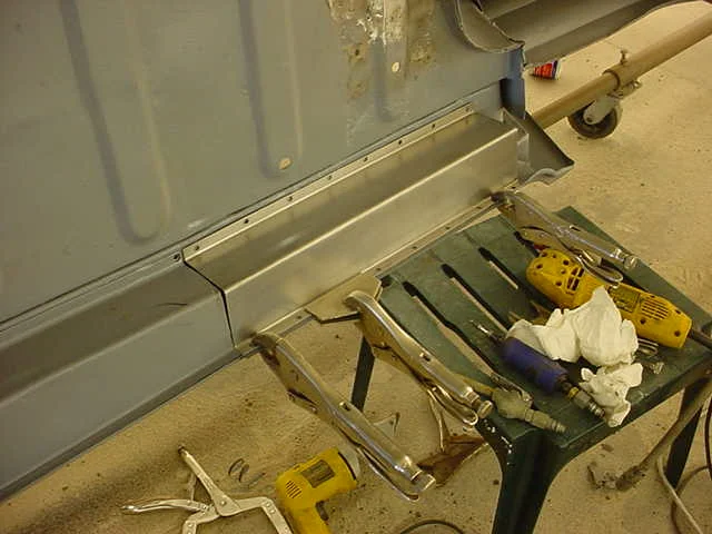

Started on the other rocker side. I didn't have to cut out quite as much on this side. The other side needed an entire new rocker box made and most of the outside panel. This side about the rear 16".

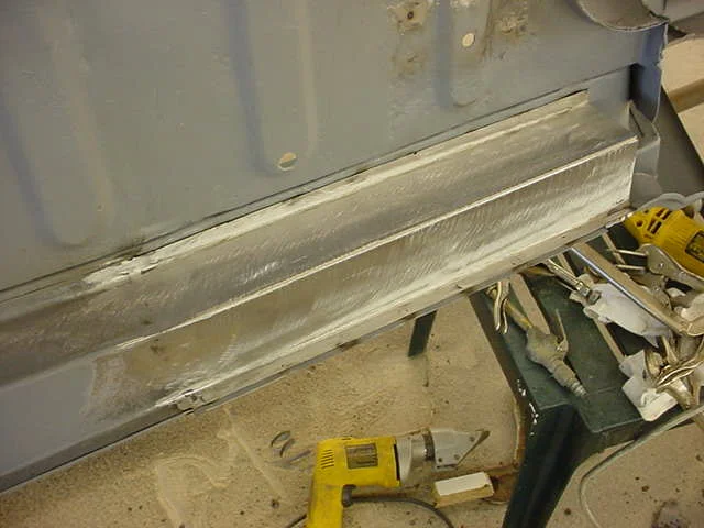

Cut first, then sandblasted everything, including the inside of the remaining rocker box. I stuck the nozzel in there and let'r buck for a few minutes. Shined a flashlight in there and amazingly clean. Then I stuck my paint gun in there loaded up with PPG DP50 and sprayed for a good minute or so with a lot of pressure. Primer was running off everything in there, made it all the way to the end. I was pretty pleased with that. I wish Toyota would have just did a little priming on the inside of the panels from the factory, then we wouldn't have this problem.

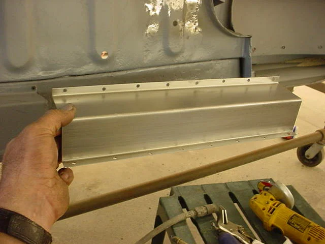

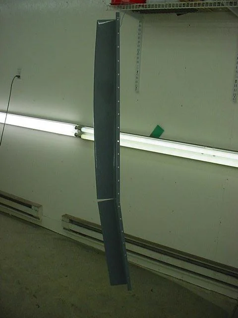

Bent up the pieces for the outside of the rocker panel and the inner, butt welded them in and ground them off. Pics show it all.

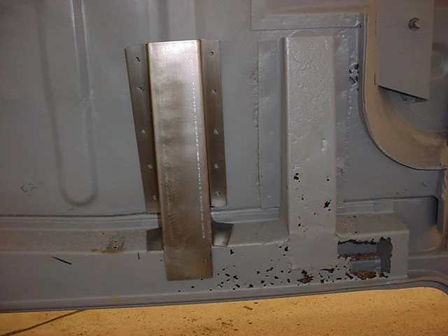

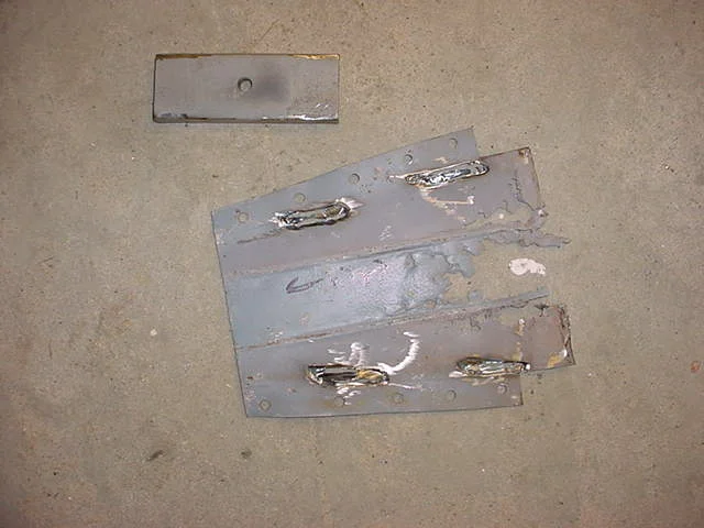

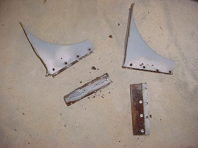

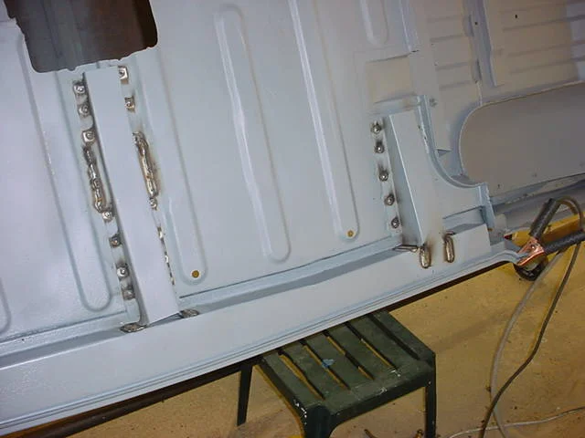

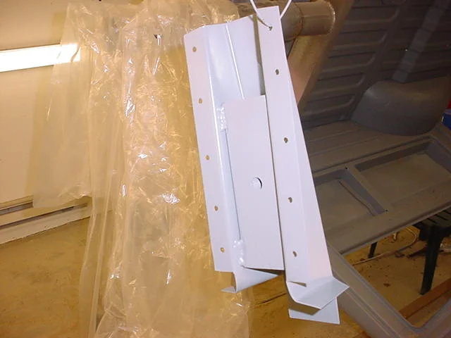

I made the 2 rear brackets, that hold I think what are the seatbelt mounts? I bolts threaded into the rear of the floor. One of these brackets was pretty much gone, and the other was on the way. I had to cut out the heavy iron plate on the old brackets, sandblasted them, primed and welded them into my new brackets.
I should be able to finish up all of the rockers and brackets in about 3 to 4 hours tomorrow. Then I will be moving back into the seat area on the inside, re-working seat brackets and making some new stuff. Might get that done tomorrow, although I wouldn't count on it.
My goal was to get the rocker panels and floor done this 3 day weekend, and I think I will accomplish that. :)

2nd pic is the airgrinder I use, they come with a stiff backer pad, but if you double up 2 - 4 1/2" resin disc's it flex's quite nicely in the coners and curves. Looks kinda wierd in the pic, but when you spin it at 18.000 rpm it straightens out real fast :)

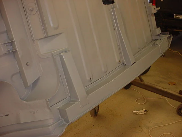

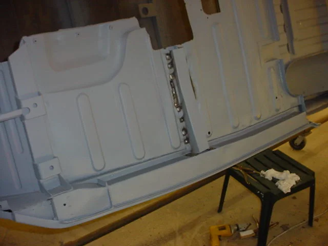

Well, didn't get a full 11 hour day in today, more like a 6 hour day. I had a few intertuptions so......
I still got all my floor up front and rocker panels completely done. Finished getting those rear brackets I made fit and welded in. I also boxed in the rear of the rocker panel. It was boxed in from the factory, but it was more of an inverted part on the inside of the rocker box and then spot welded in. I didn't make it like the stock one because first it was a major pain in the ass to do it that way and 2nd, it was another place for it to start rusting again. The way I did it was easier and less apt to rust.
I was hoping to get the brackets and channels welded back in for the seat, but didn't happen. I did get those brackets cut apart, blasted and primed, but they are all going to need a little lovin. That will probably be another 6 hours to get those brackets done and then a good day to get them all welded back in.
