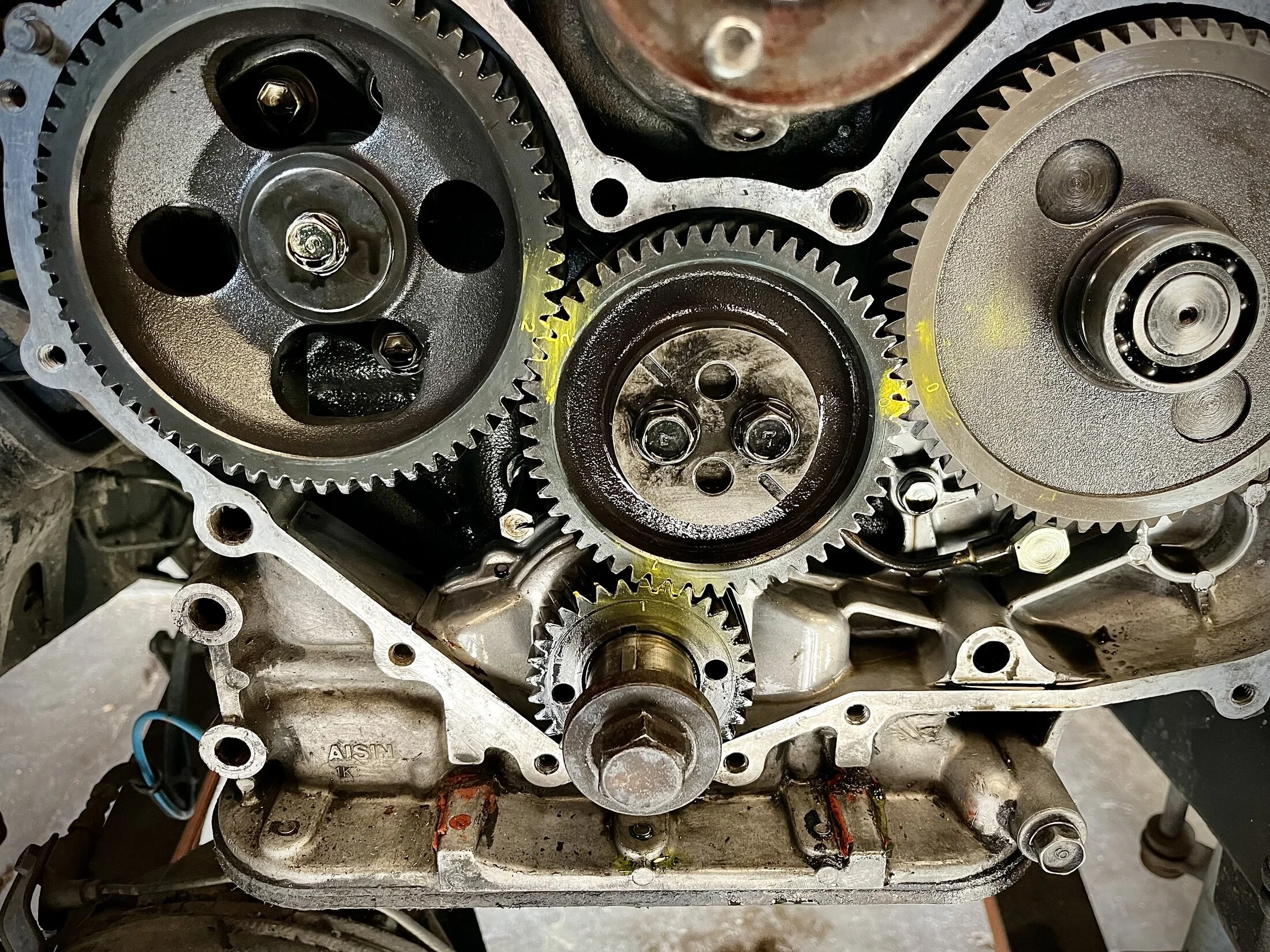

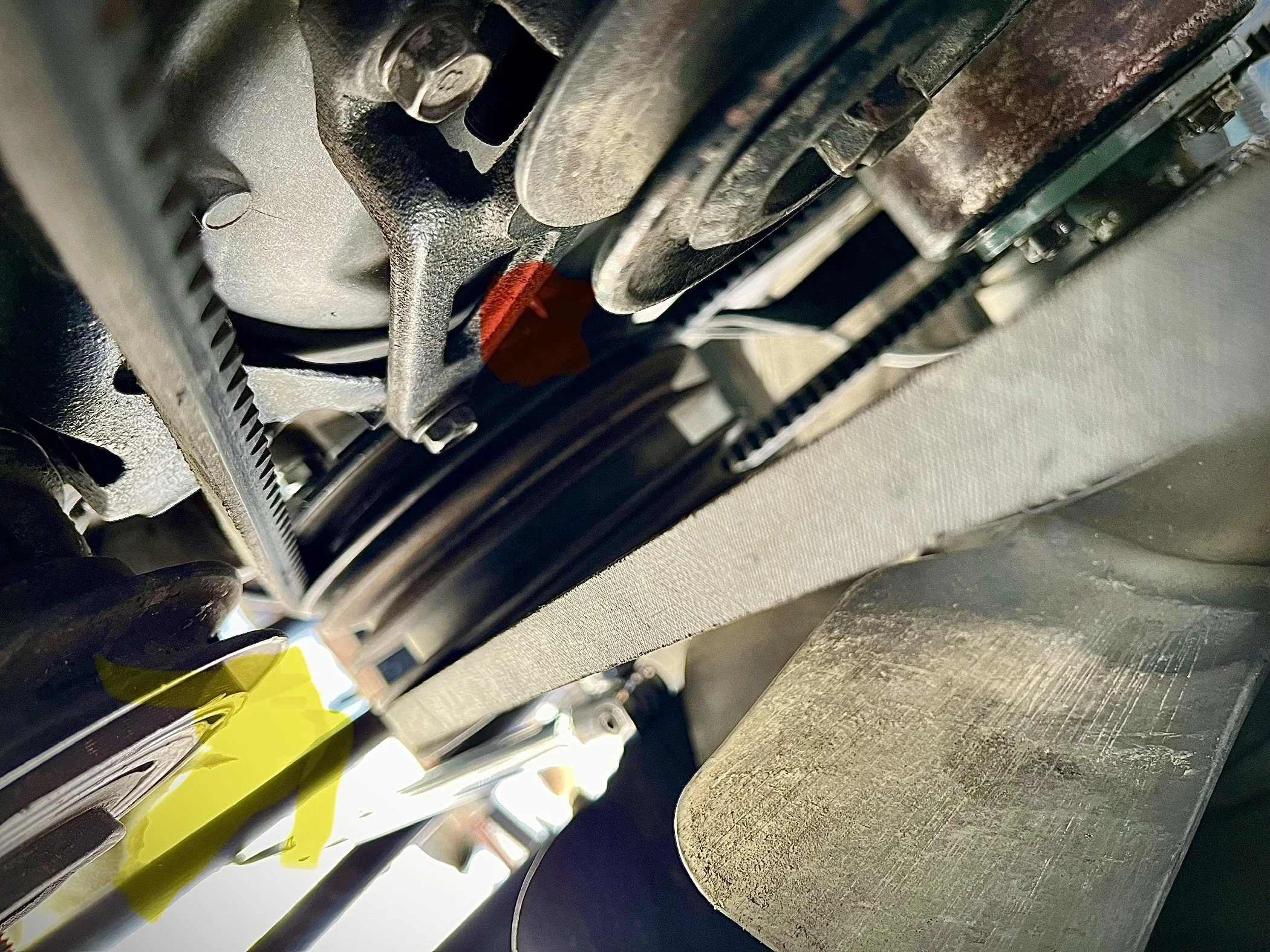

I spill timed it and…
The red mark is the timing pin, the yellow is where the marks are on crank pulley. This is the point the fuel spilled out.
bad news: I must have bumped timing somehow putting the gear back on. Ironing else moved so it must have been bumped while putting the automatic timer back on. 😕
Have to tear the timing cover off and spin spin up to 270 times to get the gears to line up and put it back together.
Huge mistake not just lining up the gears the first time. Assumption was since nothing moved (I believed) that I was good. Not so much….
Easier to pull the timing gears off, align everything and reinstall.
Yep. Timer will be off so only have to pull off the central idler.
I think you can just remove the central idler gear.
Yep that would be easiest to change for sure.
Thanks! I’ll pull tonight or tomorrow and see how it looks. I’m hoping the gasket doesn’t mess up. It shouldn’t since there werent any heat cycles.

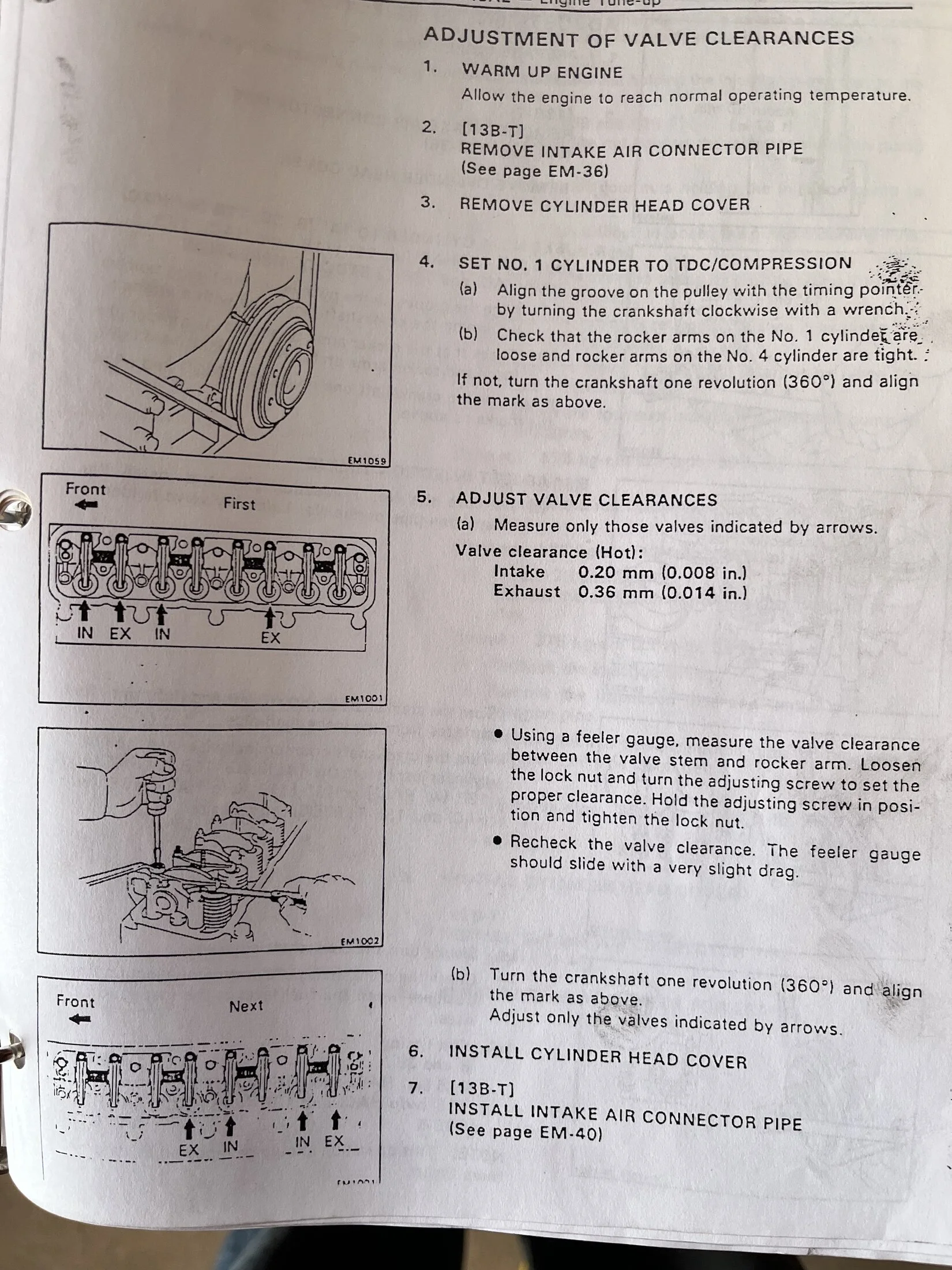

Am I correct in thinking I’m good to go?
I remember something about checking pushrods to make sure, I think 1 should be loose….4 not.
My valves/pushrods
1: loose
2: loose
3: loose
4: tight
5: tight
6: loose
7:loose
8: tight
According to manual:
So possible my number 7 intake is a little loose.
