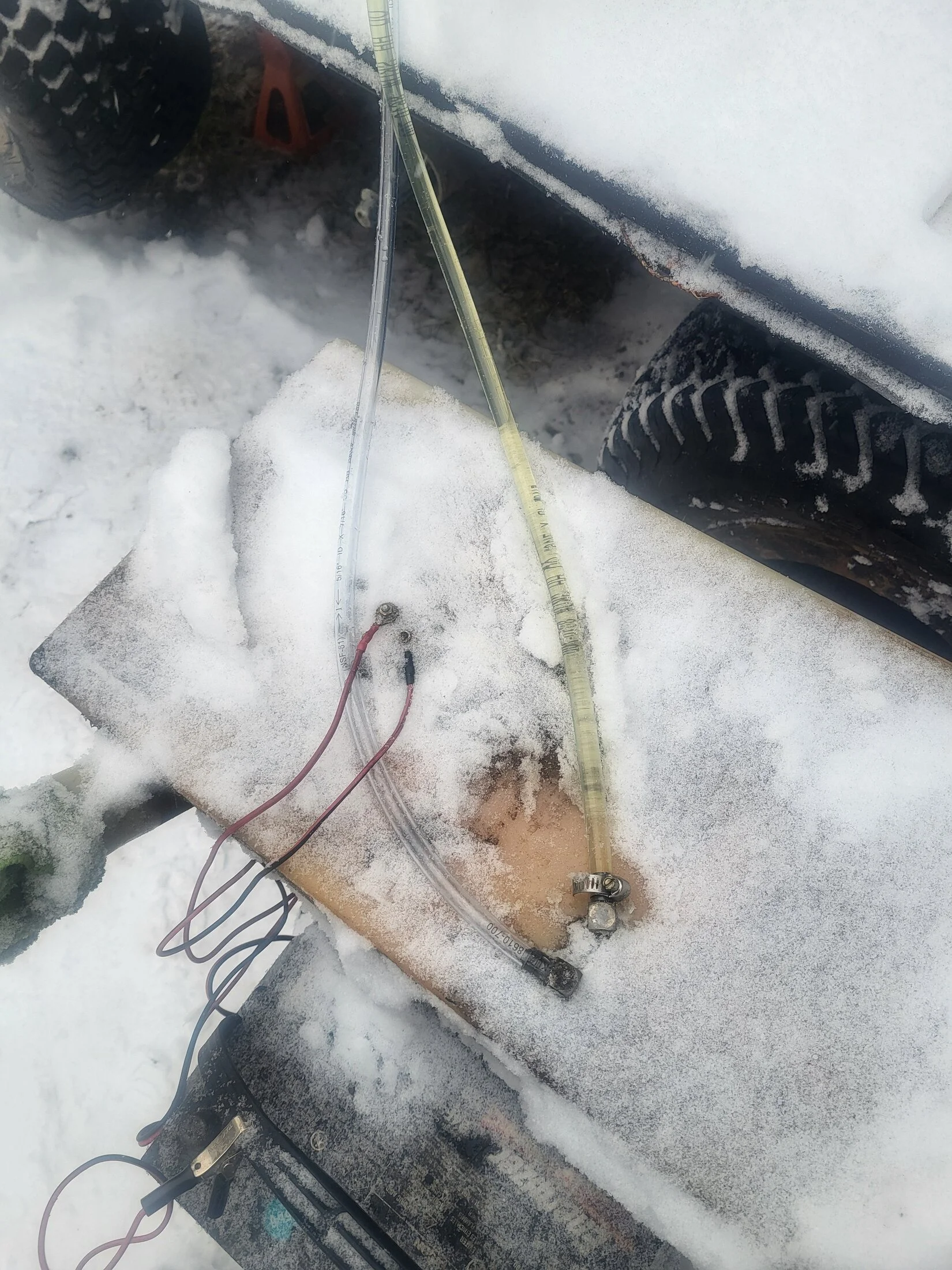

Clear fuel lines, look for fuel, not air bubbles.
Example.
Took the fuel tank out of this 2007 Argo Centaur with a 950cc Diahatsu diesel.
Wanted heat in the cab, so ran some clear hoses to intake and return.
Hoses were a bit oversize, but nothing a good clamp couldn't handle.
Pull fuel before the primer, you should get clear fuel...no air bubbles.
