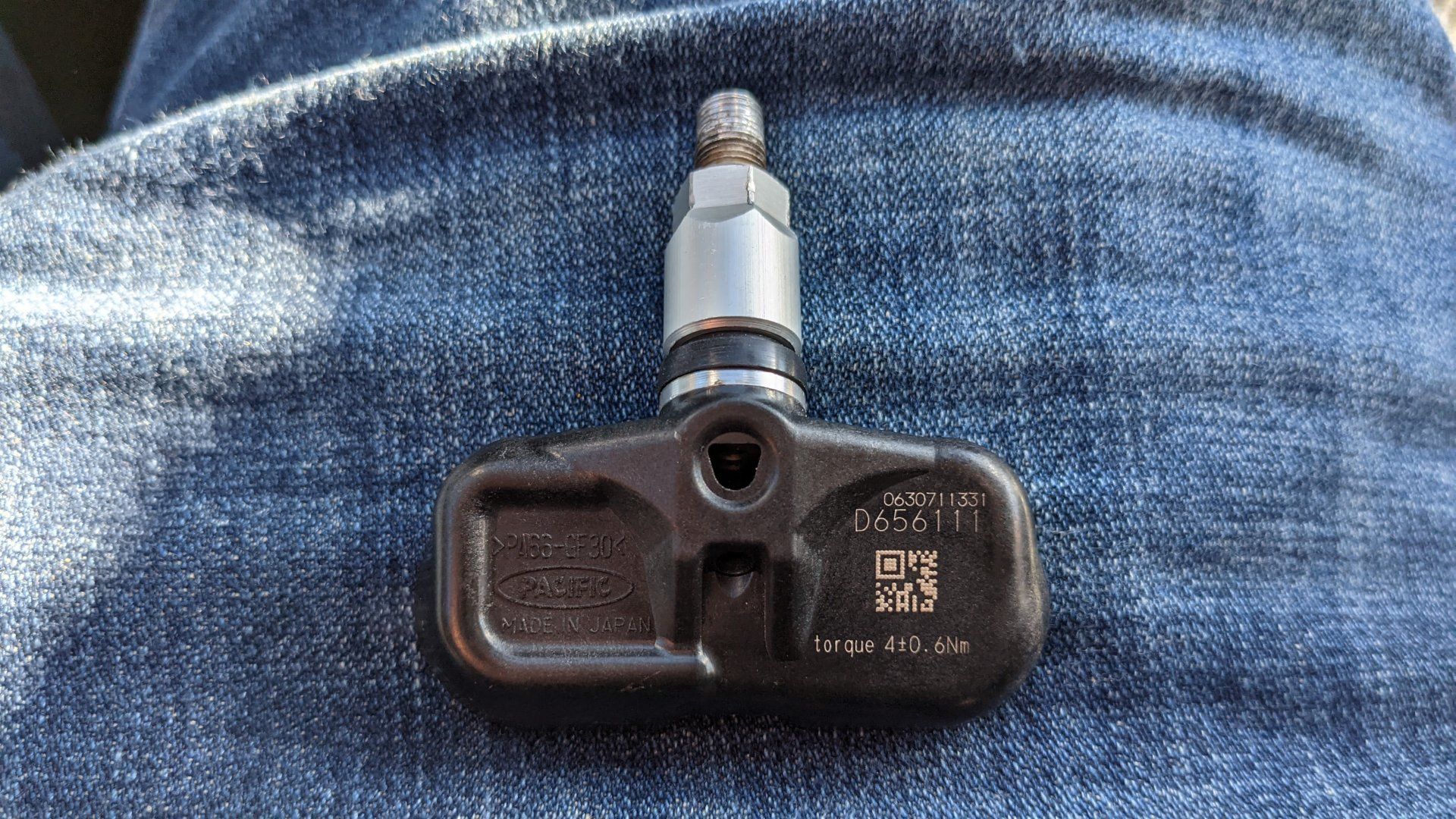

A thousand miles later and after a new set of tires, the TPMS light starts going off but this time flashing. I'm guessing these sensors are on their way out and possibly have never been changed and I want to get rid of the light once and for all but wanted to avoid paying the $70 a tire that Americas Tire quoted me.

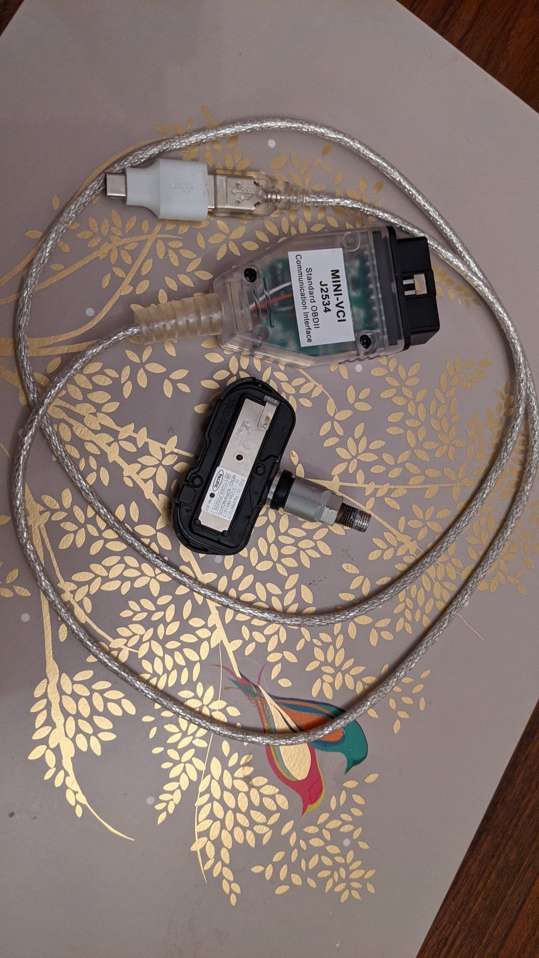

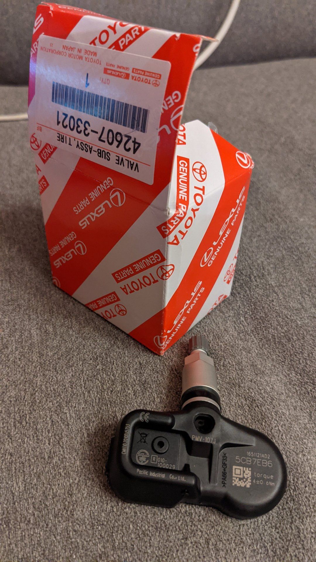

I ordered 2 x 4 of these from eBay: 4X Genuine 42607-33021 TIRE PRESSURE SENSOR TPMS For Scion Toyota Lexus PMV-107J | eBay

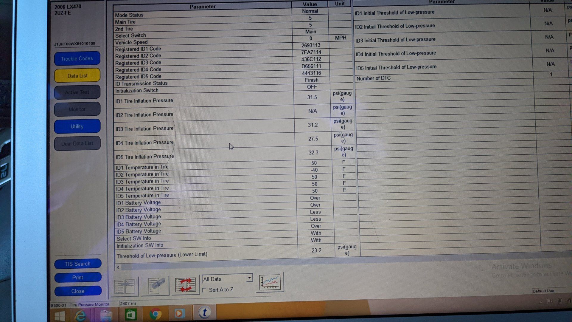

I'm wondering what the next best step is - should I get the existing IDs from TechStream and then buy a cloner (or perhaps does anyone out there have a cloner handy?), or get these fitted and then program the vehicle with the IDs using TechStream? Any procedures to be aware of to activate these or turn them on?
