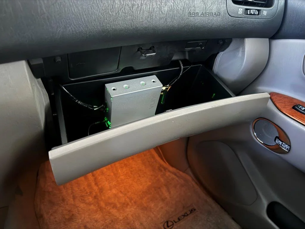

Several threads on Vline that answer the questions you have on placement. I had mine in glovebox for a year. Someone recently posted photos of it in the passenger footwell carpet that gave me back my glovebox space. That’s where i have it now.

Thanks! I’ll probably put it in the glovebox

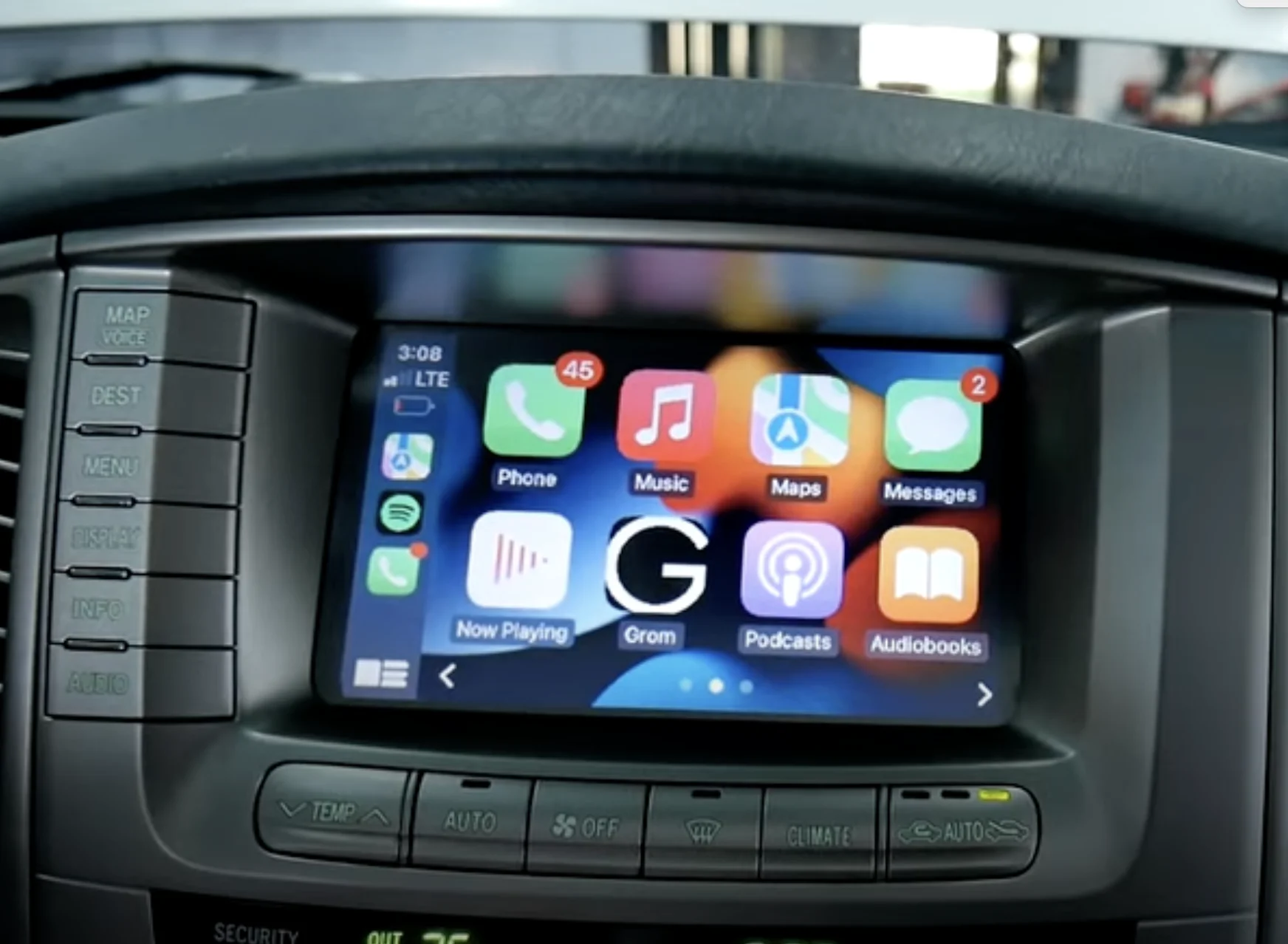

Thank you for this! I have the BT-45 and it does mention the Bluetooth Connected and it does sound kinda tacky lol. I'll definitely take your advice on the audio sounding muddy, though I'm not sure if that might be due to the Lite version maybe not having as stronger of an amplifier compared to the higher end one but I have no idea. I have to say it does look really good for the screen and I actually purchased the same MagSafe phone mount on eBay sometime last year and just have it in my center console when the one on the dashboard loses its grip. One question... does the CarPlay activate on startup or do you have to press the DISC button every time and does CarPlay go away when you shift to Reverse and come back?
When I start the car, I see the Lexus screen for a few seconds, then the VLINE boot screen. After that boots, my screen goes to the NAV screen by default. I just press the audio button and it goes to the Grom unit and then after a few more seconds, like 20-30, Carplay will show. It goes right back to carplay after going in reverse.
