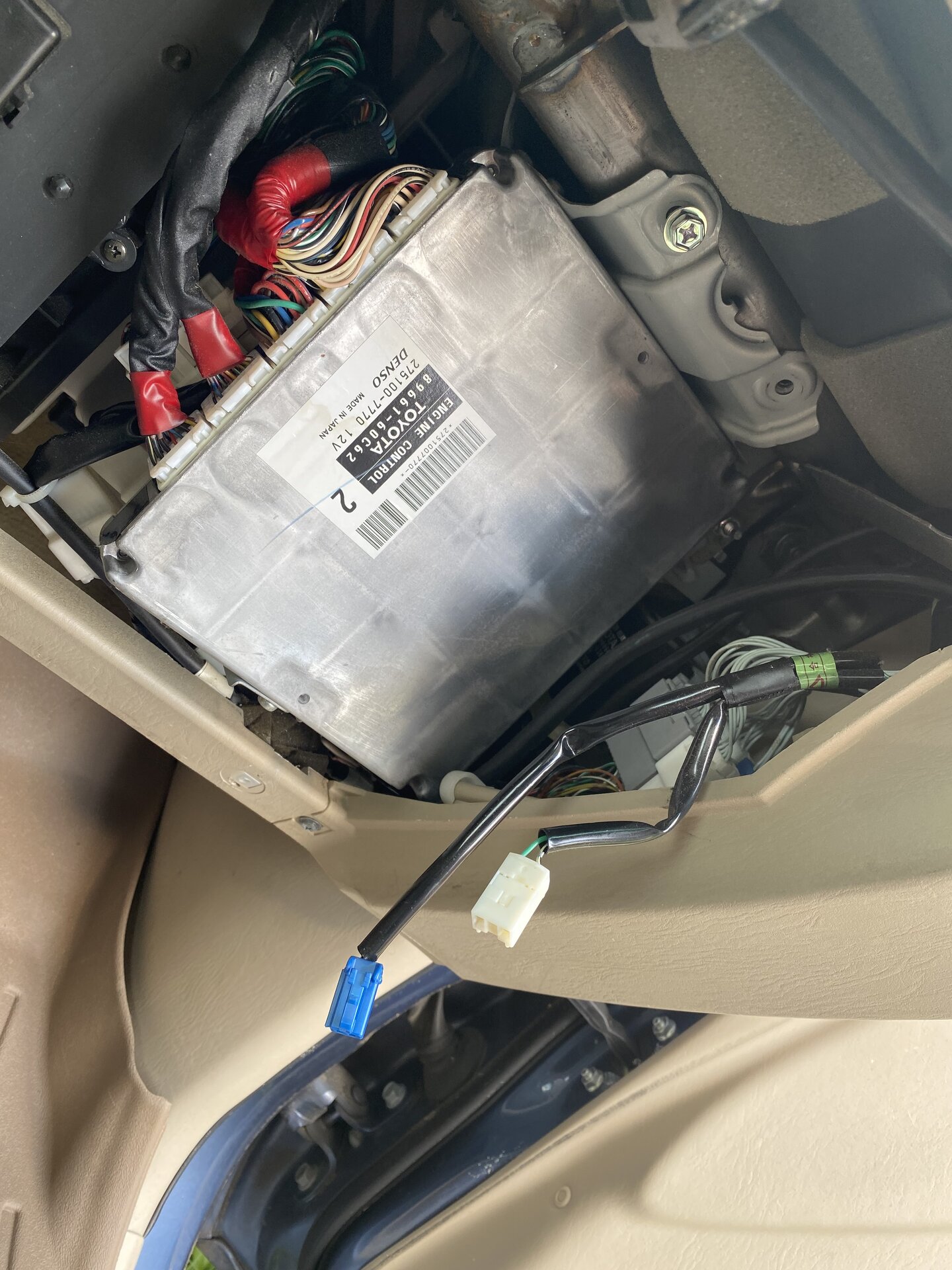

Instructions:

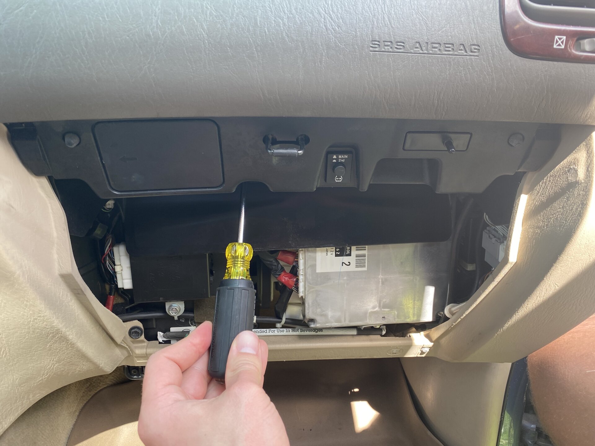

1. Remove your glovebox. 2x screws at the base as pictured. Just lifts up and out.

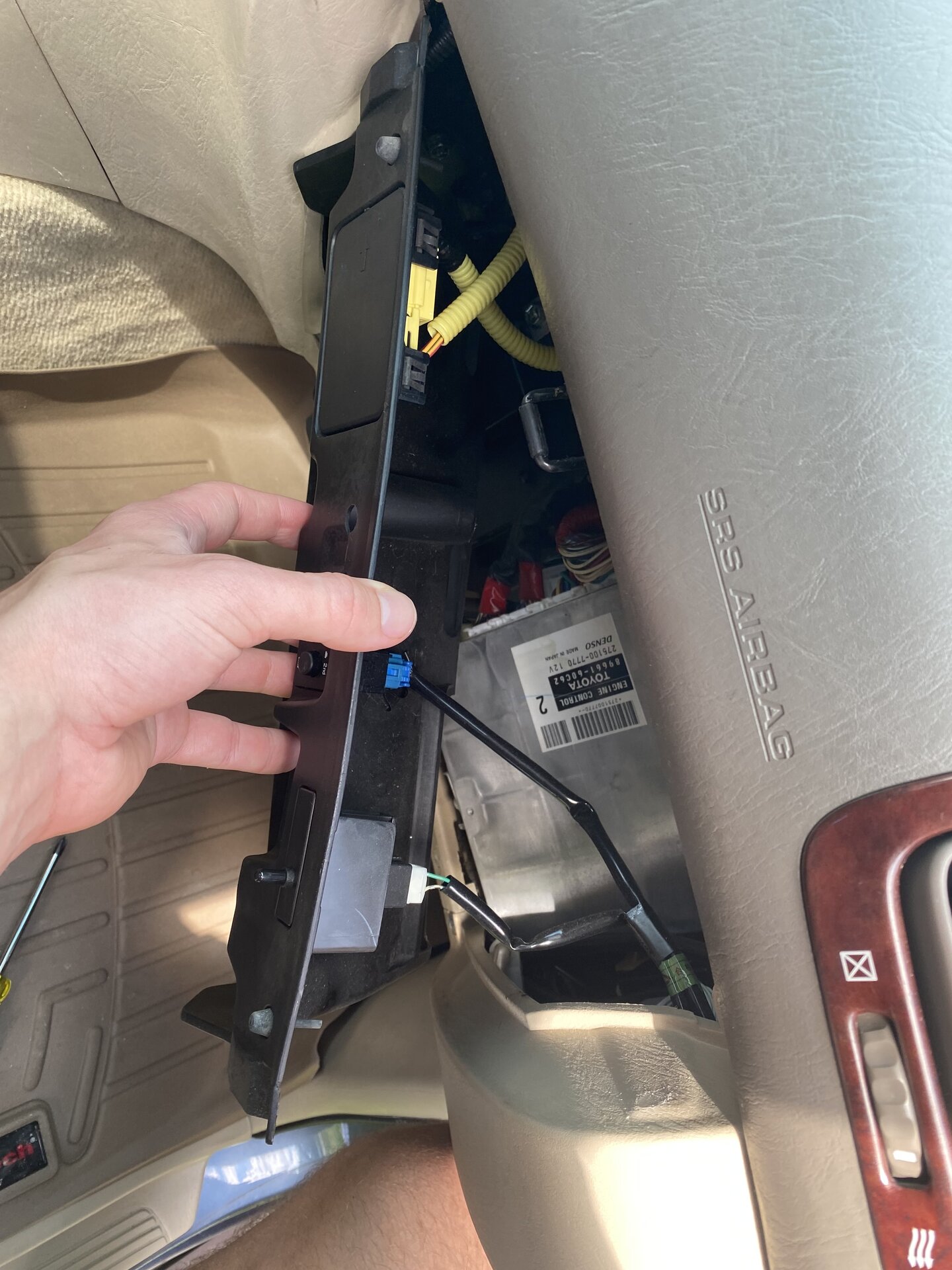

2. Remove the upper plastic trim. 4x screws as pictured and it fits kind of snugly, had to take one side out at a time. It will make sense when you see it.
3. Once this is out there are 3 wiring harness attached to the back of it, disconnect them and get the black plastic trim out of your way. The yellow one doesn't actually have to unplug, as it is just mounted to the back of the black plastic.

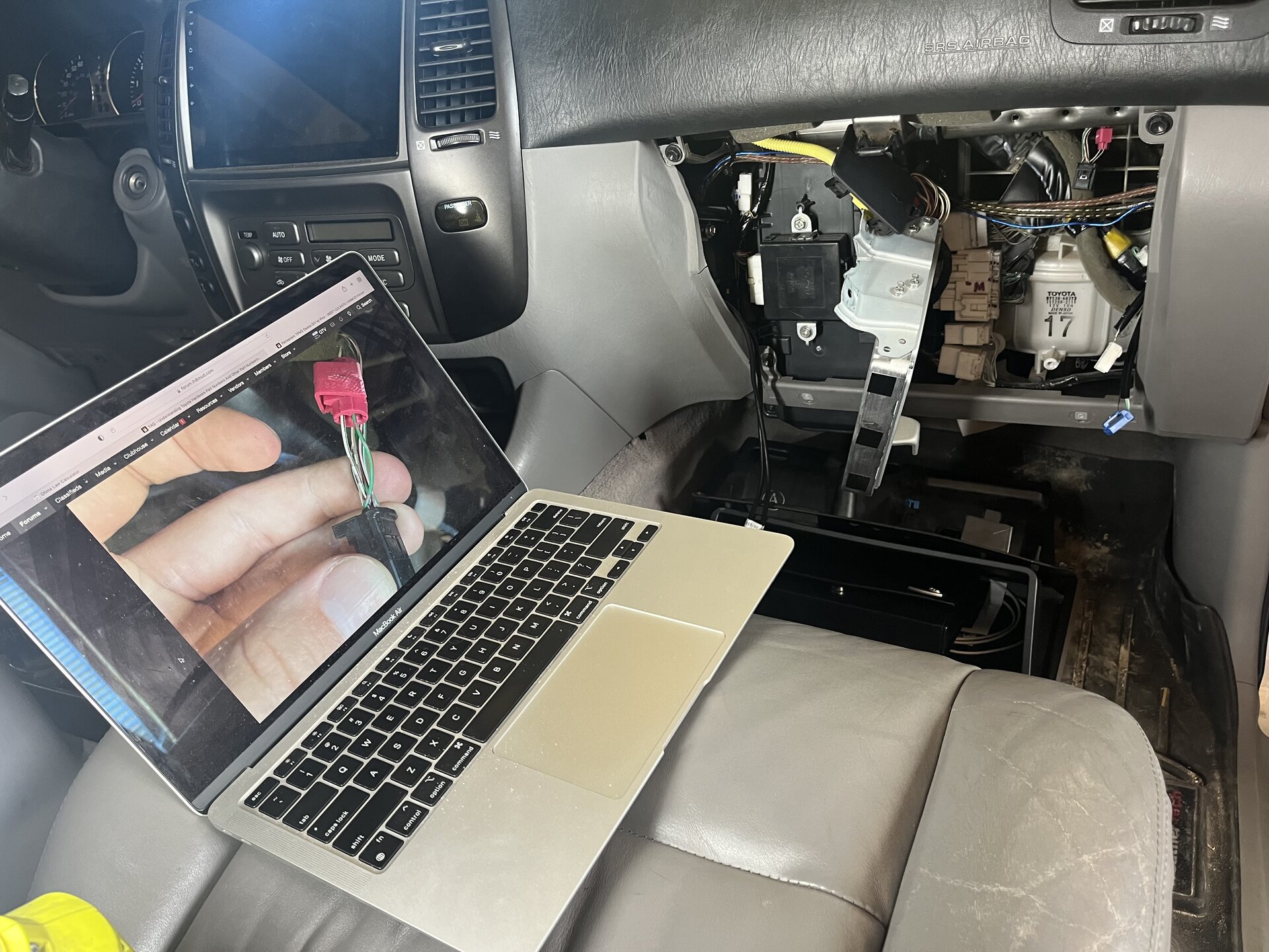

4. At this point you have your ECU and various control modules exposed but none are really accessible.
5. You need to remove the 3 phillips/10mm screws that mount your ECU to the crash bar. You do not have to unplug any of the wiring harnesses. Once unbolted there is enough slack to just move it out of your way.

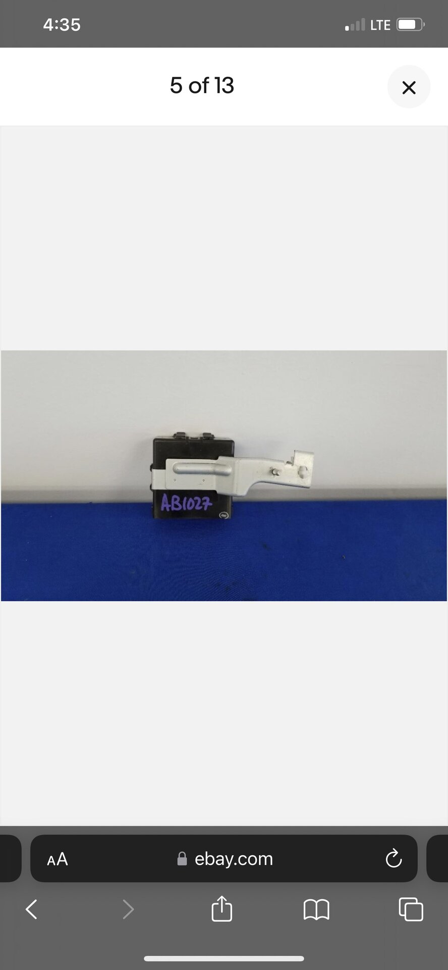

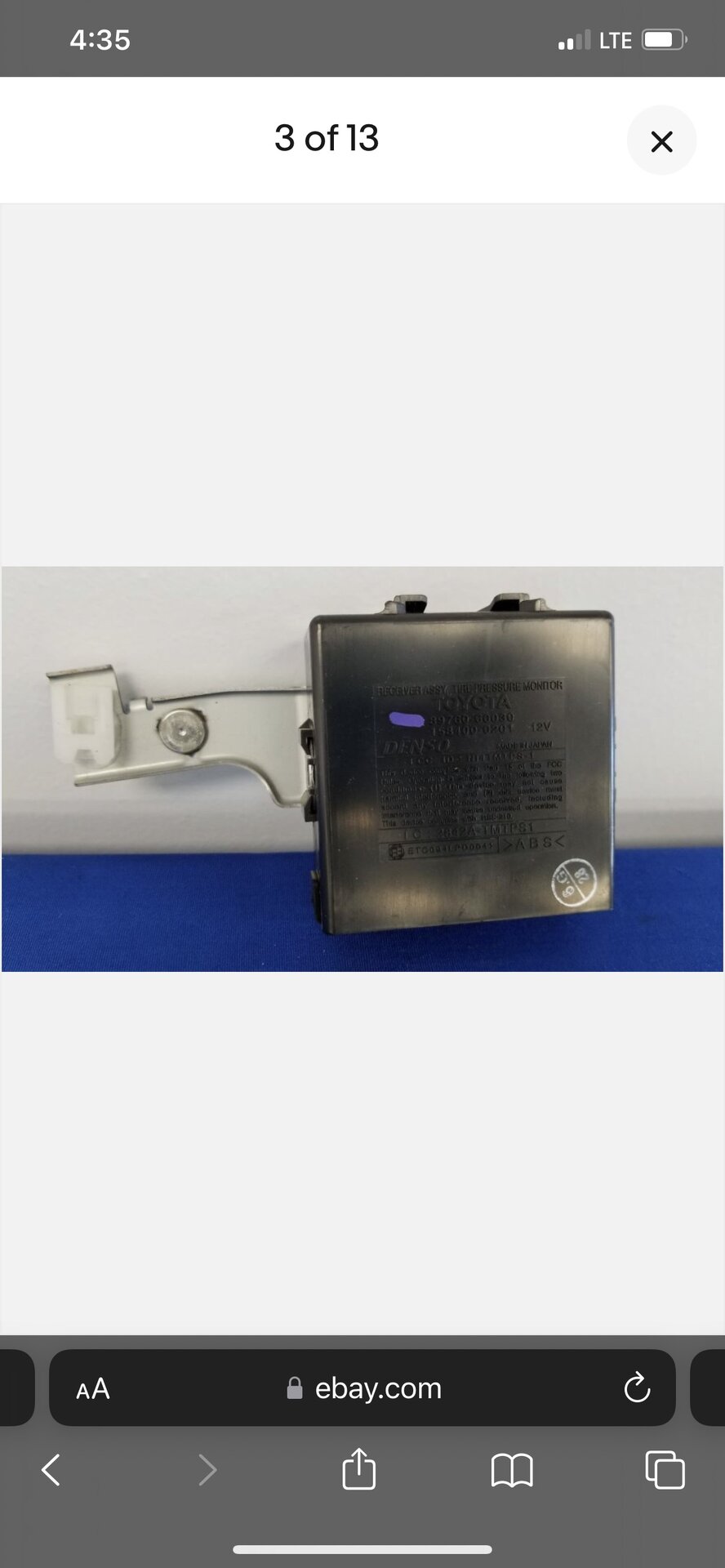

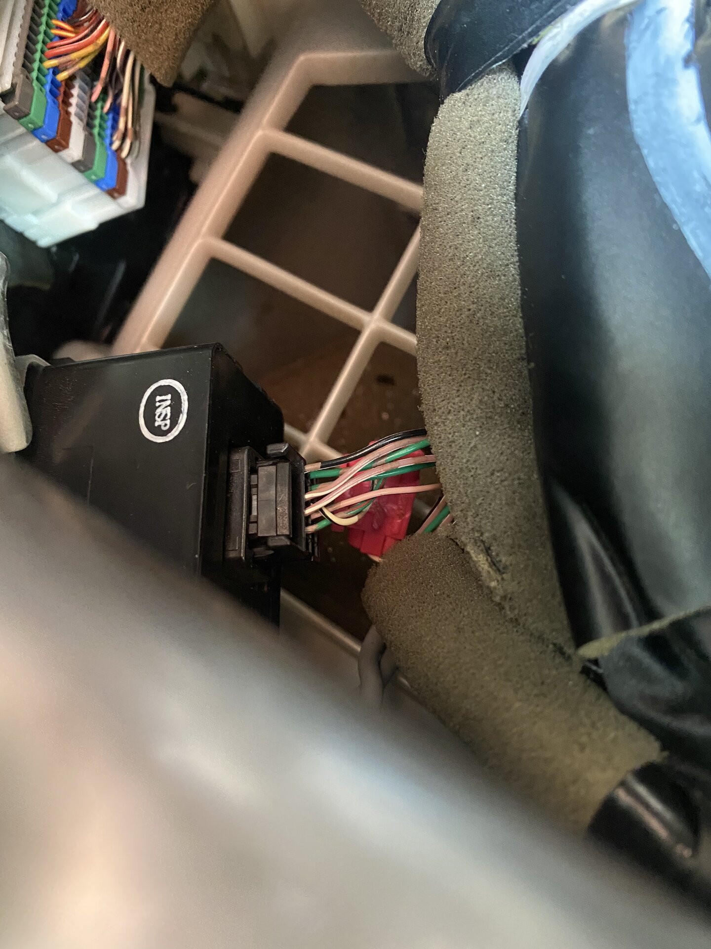

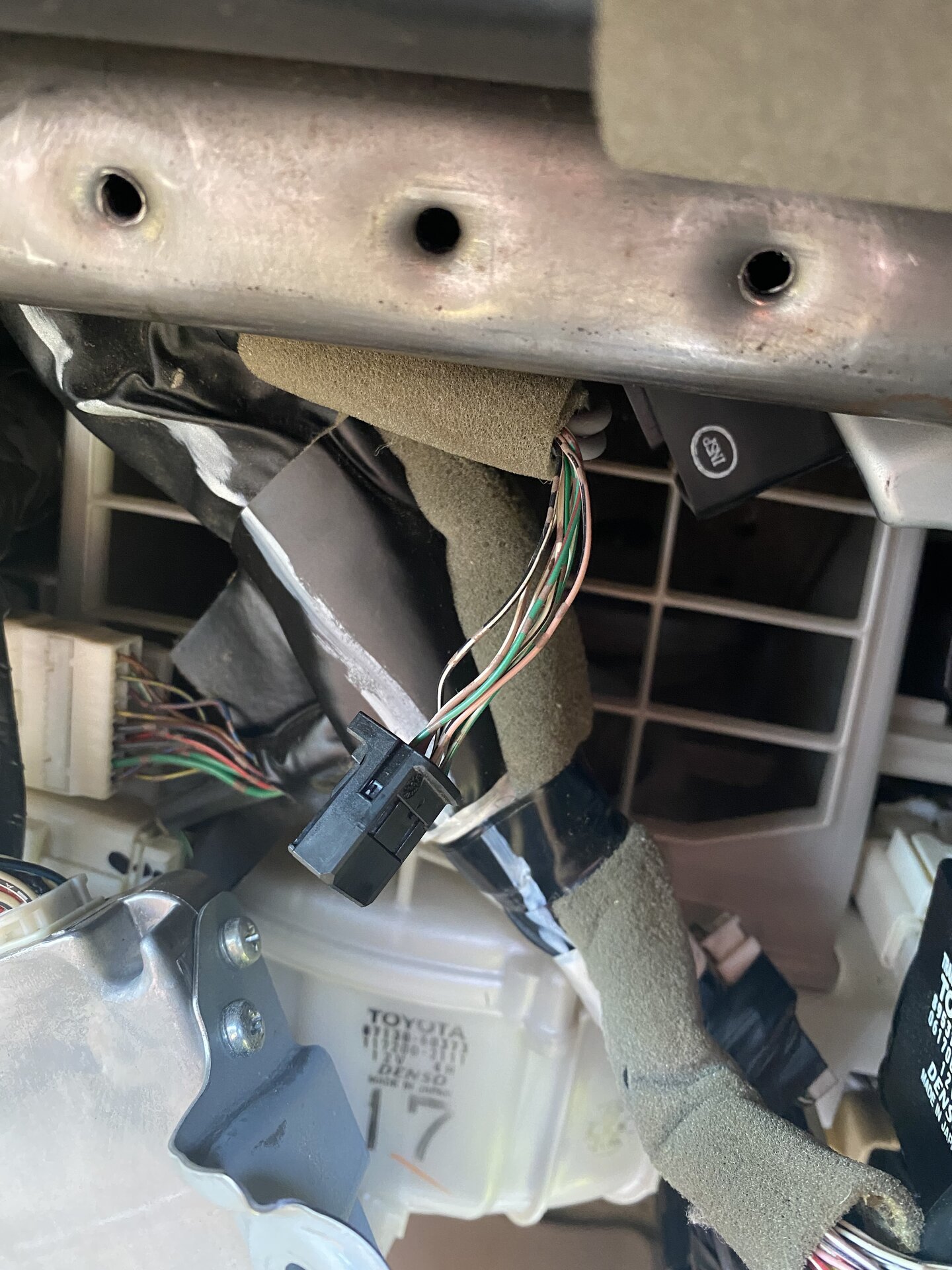

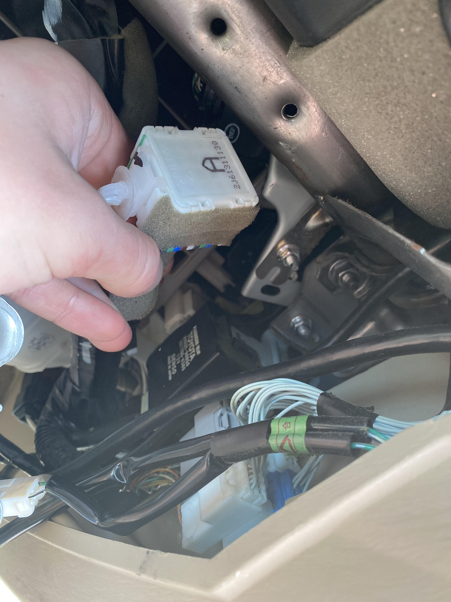

6. Look up and to the right mounted behind the ~2" steel crash bar to find your TPMS module. It is mounted to a metal bracket and oriented up towards the dash. It does not need to come out to do this mod. I actually tried to remove mine just to confirm it was the correct module but couldn't break the 10mm mounting bolt loose, it was bending the metal bracket so I aborted and resorted to internet research to confirm. Found an ebay listing for the module that came out of the same truck. Matching the box/mount/wiring harness sites to pictures of one removed from the truck was enough to feel confident I was dealing with the correct box/harness. Pics are below so you can get an idea of the module you are after.
7. There is a white relay mounted to the bottom of this bracket, it pops out easily and can be moved out of the way for better access to the TPMS control module.

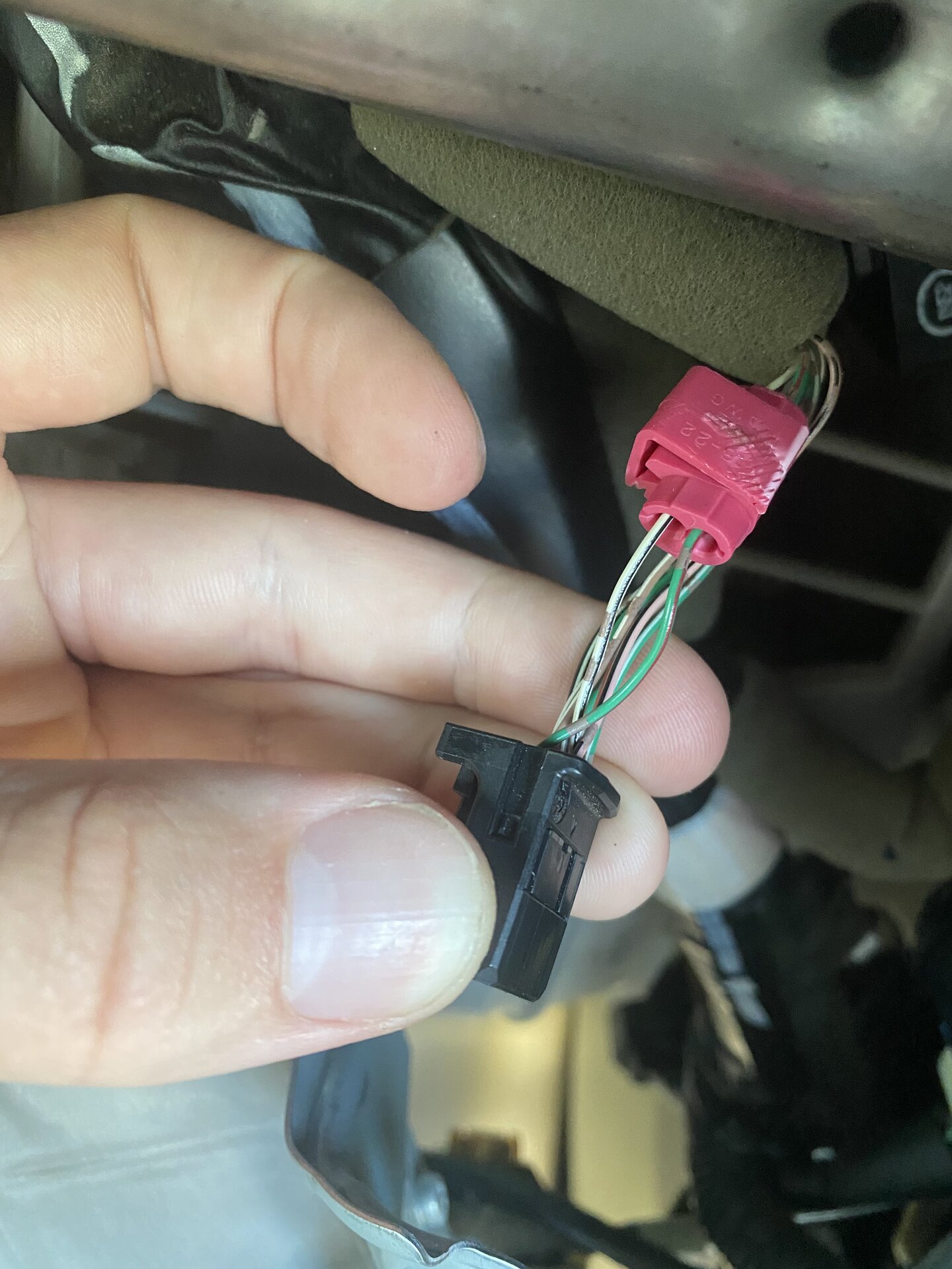

8. There are two plugs going into the control module, one with 2 gray wires and one with ~8-10 small (~20ga) color coated wires. You are after the plug with color coated wires.
9. Unplug this and pull it down so you have some space to work.
10. The two wires you are looking for are a green wire with a red stripe at position 5 in the harness and the white/black ground wire. I was a little confused as DenaliJames had described this as green/magenta in his previous posts and many of the other wires contained a lighter purple that seemed like more of a magenta to me, but I closely examined all wires and cross referenced with a post from earlier in that thread that discussed the pin numbers and decided this was likely the correct one.
11. You will jump these two wires together - effectively "grounding out" the green/red wire at position 5. I used a T tap quick connector as pictured below.
12. Ensure you use the correct size T tap - first time it was unsuccessful bc I used a blue one I had lying around that was for larger wire and didn't make good contact with the wires. I ended up going and getting a smaller red one which was successful. Make sure you crimp it with some pliers or something to ensure the wires get pushed well into the metal bracket of the T tap and make good contact.
13. Plug it back in and turn your truck on to verify you have solid connections and successfully disabled the TPMS light.
