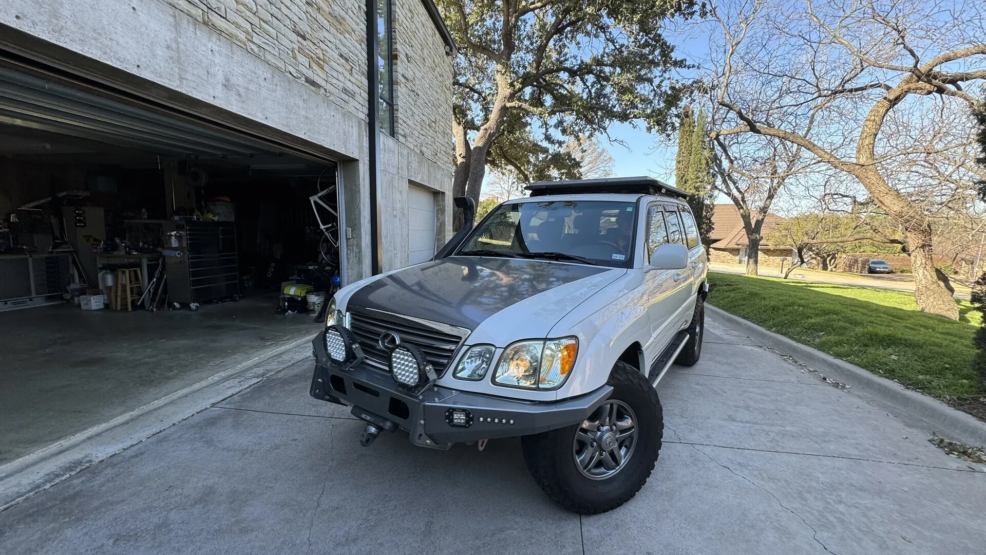

Hello everyone, I am excited to be back on Mud with my new to me 2005 LX470. My goal here is to say hello first, have place to document the maintenance and further built of this nice rig as well as to ask for feedback how to make this a more reliable and enjoyable overland truck.
I had a 200 series LC that I built fairly nicely and allowed me to explore Mojave, Anza, Death Valley and Ouray trails. I had a great time meeting and wheeling with the LCDC group two years in a row and I missed these trips.
Since I don’t get the chance to go on these long trips very often I settled for a 100-series with the goal of saving some money but with all the additional maintenance I plan to do it’s probably going to be as expensive as my former 200 series.
The LX is a great shape (181K miles), the prior owner did a great job building this rig but never took it out on the trails so I’ll do the honors . The LX has front and rear Dissent bumpers powdercoated in a great grey tone, Slee sliders and diff drop, SPC upper control arms, 33s KO2, Old Man Emu suspension, raised air intake, Warn winch, Dobinson drawers, after-market lights, dual-battery setup with Redarc controller and solar panel and an after-market head unit I still need to decipher (and figure out how to make the backup camera work). The timing belt, radiator have been replaced at ~155k miles so I’m good for a while. I’m not much of a mechanic but I planning to learn and do the easier jobs myself and let the dealer tackle the more difficult projects.

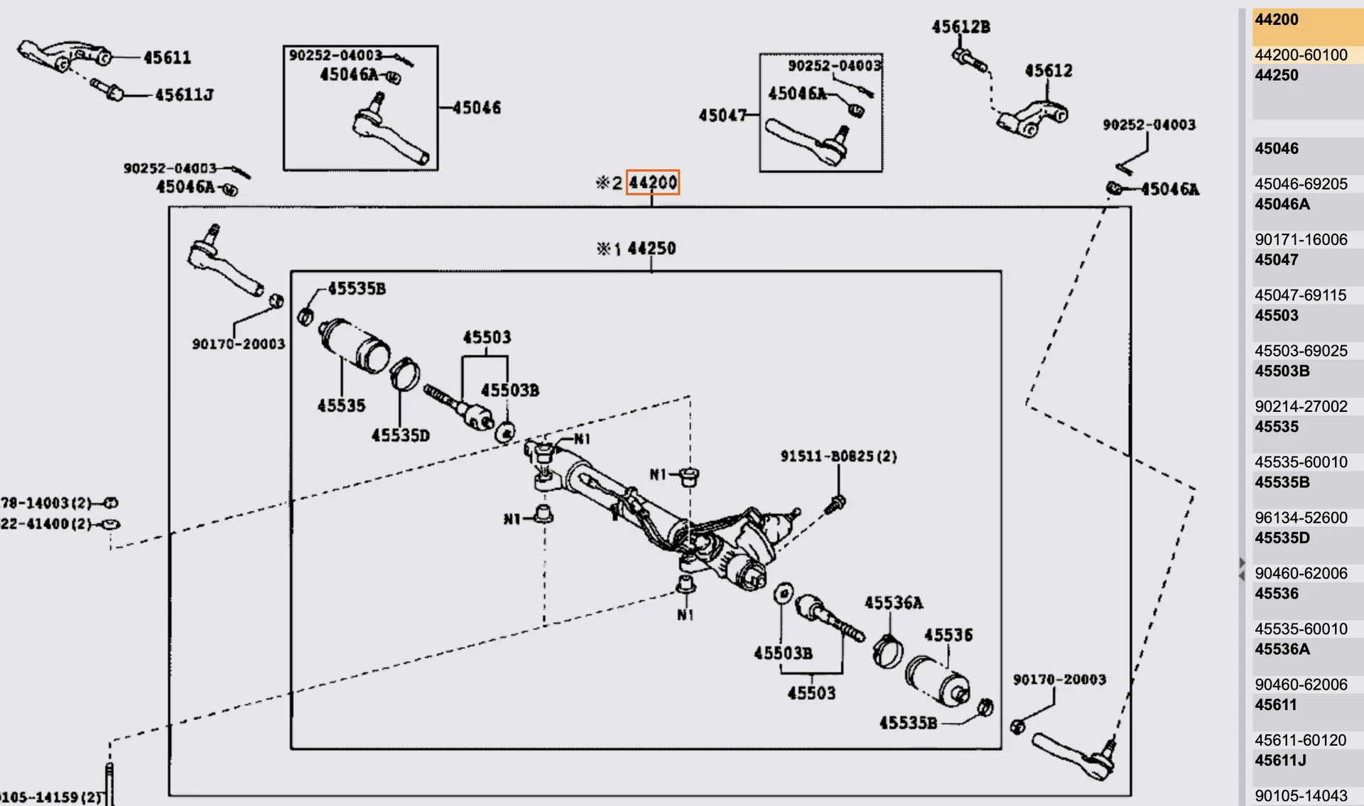

Are the 555 after-market outer tie rods just as good as the OEM? Do you recommend a different model?
OEM Out-TRE are best. A used OEM will out last a new 555. 555 boots don't last and rod get rusty.
@2001LC - do you know if a new steering rack would automatically mean the dealer would also replace the steering rack bushings or I need to ask for this specifically? Thank you!
New R&P, do come with mounting bushings.
For 2005 LX 44250-60120. Non of the rack comes with outer rod end anymore, it has been discontinued and superceded with rack without outer tie rod ends.

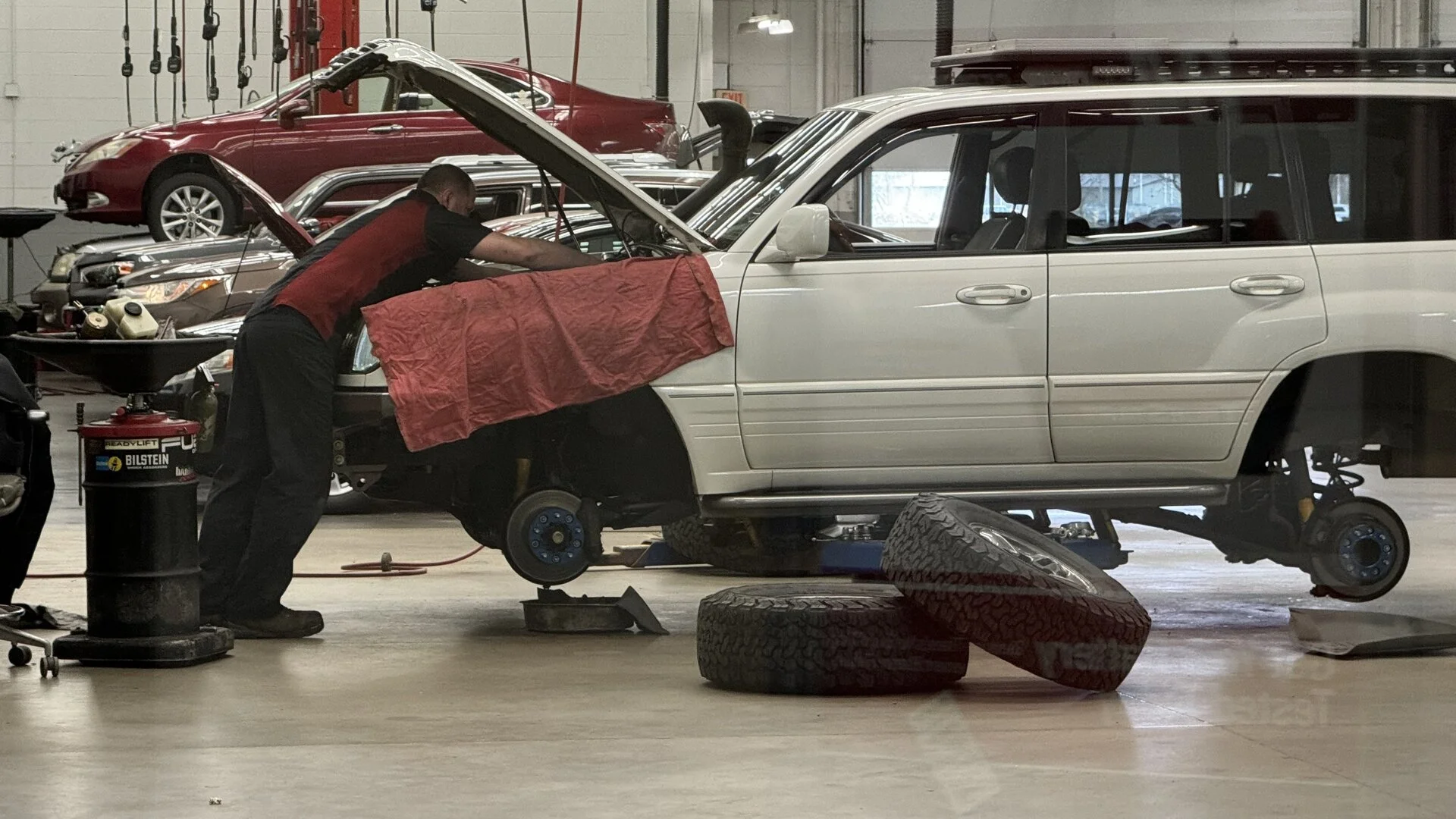

Making some progress with the baseline - I had the dealer replace at around 184500 miles :
- steering rack OEM Lexus and TRE (these don’t come with the rack) and flush the steering fluid
- brake booster assembly
- Slee steel brake lines
- OEM radiator - the aftermarket one replaced by the previous owner a few years ago had a tiny leak. Flushed the cooling system.
I cleaned the MAF and throttle body. Next, I’m planning to change front wheel bearings, rotors and pads all OEM and grease the needle bearings using the slee tool. I have to admit the maintenance is getting pricier than I expected. It’s worth shopping around at various Toyota dealers for parts and labor. I received some quotes for the brake booster that varied as much as $1200.
