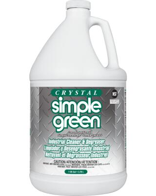

I have to follow-up on this post. I went ahead and did some more snooping around after purple power was mentioned. I saw that a few people posted success with Simple Green: Crystal on Garage Journal.
Crystal Simple Green® Industrial Cleaner and Degreaser
I went ahead and bought a 5 gallon bottle of the stuff and diluted it with ~4 parts water. Their instructions call for 1 to 15 parts in heavy duty applications.
I dumped it (and the water) in the parts washer and washed a few of the dirtiest, oiliest, greasiest, most disgusting parts I have in my garage. The stuff worked great. The two drawbacks are that the parts come out very slippery and they need to be rinsed off in fresh water after being run through the solution. Gloves are advised unless you want incredibly dry and cracked hands. The smell isn't nearly as pungent as the purple stuff, but I still like to keep the doors open. The best part is that it's not as harsh as purple power or ZEP purple cleaner. It's slightly more environmentally safe than the others too, though I wouldn't go dumping it on my plants.
Anyway, I figured this was worth a follow-up for anyone searching out a safer non-solvent based option. That said, solvent is still king with respect to parts cleaning.
