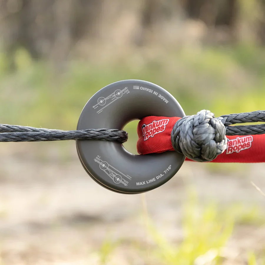

Yankum Off-Set Winch snatch ring
Dec 10, 2007
279
11,784
Anyone have experience using this gear:
Long but interesting video showing how it's used:
The Yankum has an offset hole, does that make a difference??

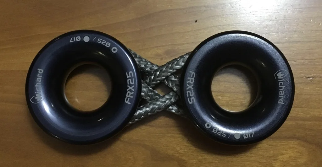

The rings are designed to be used in compression, not tension. Sure, you can make them big enough to handle a pull in tension - but it's poor engineering or just made for marketing to the offroad crowd who doesn't know any better. It's about 10 times as heavy as it should be to be strong enough in tension for no benefit. In short - that's a stupid design.

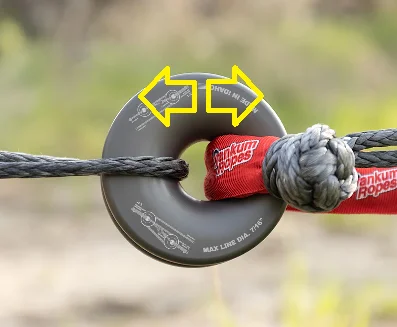

This is basic material science and safety. It's a dumb idea. Edit: Dumb is maybe the wrong word - it's unnecessary, solves a problem that doesn't really exist and to the extent it does has already been solved with a better solution. And it's less safe. If the ring fails in tension - it'll be a catastrophic failure and all the rigging is disconnected and free to create projectiles and/or the load you're pulling will be dropped. If that's your LC mid pull up a dangerous spot, that's bad. In the case of a compression rigged ring - worst case is the ring compresses to failure and the two loops are still holding everything in place. Nothing goes flying. But more importantly - it's very unlikely because you're just compressing an aluminum ring in a way that it is very strong. It would take a lot of force to compress the ring to failure which would typically look like the ring below in compression collapsing from top to bottom perpendicular to the arrows. I've never seen it happen, but I suppose it could happen.
The ring should be in compression. The ropes are in tension.
Compression:
Tension:
If you need another compounding loop - this is the better way to do it. Lighter, safer, cheaper. I would skip the gimmick and buy a few proper rings.

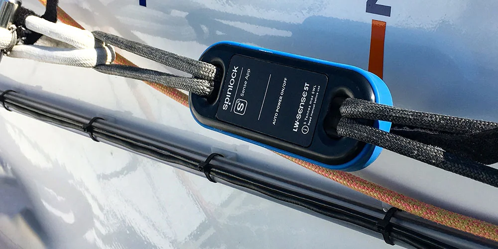

If you really want to nerd out on this - sailboat people are insufferably anal about what are really immaterial changes that cost more for very minor improvements. They're worse than road cyclists. Maybe even worse than me. But by using a spacer to slightly separate the rope on the inside loop it reduces friction and heat by some amount. So why not throw some $$ carbon fiber spacers in your recovery bag too? haha.

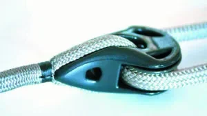

The idea of the spacer in that setup is that you re-orient the ring to use the outer channel and the ring will spin with less friction. They often call them "textile blocks" so they function like a traditional block (only more expensive). When you remove the constriction against the sides of the ring on the rope through the hole in the ring in a normal setup, then the ring will spins easily.
It basically becomes this. It's just a fancy plastic housing/spacer and a low friction ring. Still has more friction than a roller bearing. But I guess it's lighter. In my experience it's not really until you end up at 6:1 or 8:1 block sets that you really want roller bearings. The friction starts to become meaningful then. But that's mostly because you're doing it manually. In an off road winch situation - I don't see friction being a big problem unless a lot of heat builds up and starts melting stuff. Regular old low friction rings are a pretty great tool for lots of uses.
You need to watch the second video Casey posted as a followup. He discusses minimum diameter, heat dissipation, and shows attempted destructive testing of the ring. This recovery ring has far less chance of failing in tension than any of the rigging that would be used to hook it up. The whole point of being able to put the ring in tension like that is to be able to use the one ring for a compound pulley setup rather than having to use multiple devices.
