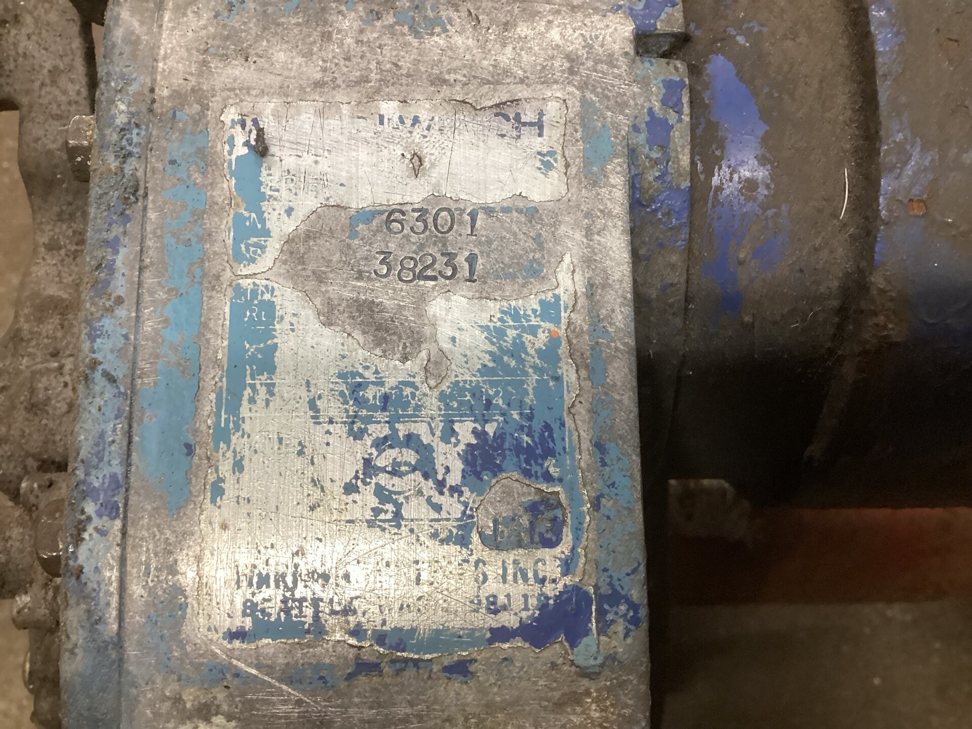

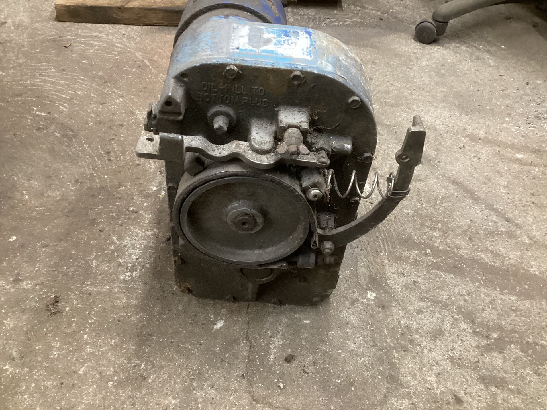

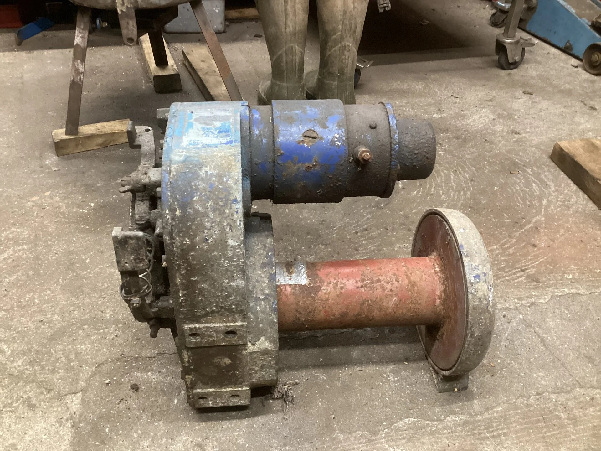

Would anyone be able to identify this old warn winch please?
It has 6301 and 38231 stamped into it but I can find no models that relate to these numbers so assume they are serial numbers.
Many thanks in advance.
That is a Belleview winch. Cable-operated brake. Not particularly useful or valuable unless you want a period-correct piece for a restoration. I had one sitting around for years that I got for free; finally sold it for $75 a couple of years back. Warn bought the company, put their name on the winches, and then continued developing the design into the deservedly-famous Model 8274.
The 5687 is a really well made winch. Belleview was a machine shop. They designed and built it for Warn. Machinists designed the 5687.
When Warn absorbed Belleview their #1 priority was lowering the cost to manufacture the winch and add some features. The 5687 became the 6014 and then the 8200. The 8200 is functionally the same as the 8274.
The 8274 was the next evolution of the 8200. The 8274 is a much cheaper winch to make. The reason why the 8274 housing splits horizontally like it does- In what seems like really stupid engineering- The reason is because they could only afford a small die casting machine and making the housing like that made it possible to die cast them without huge capital investment in a big die casting press. Accountants designed the 8274 (and all subsequent winches).
