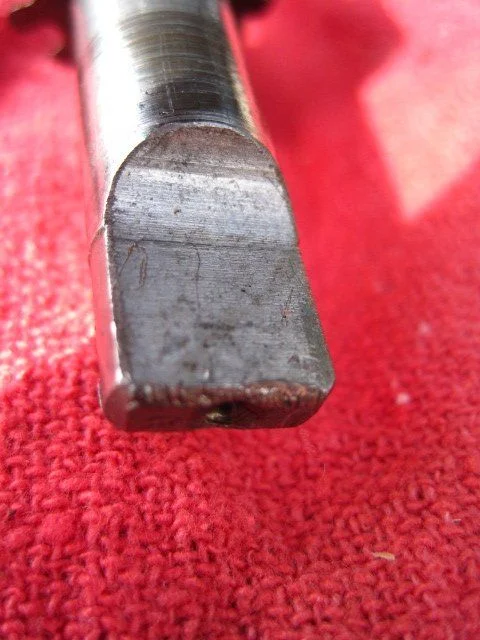

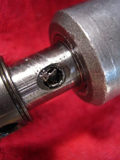

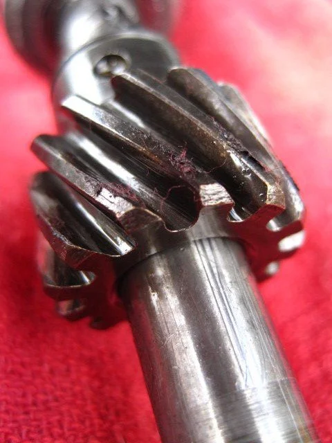

Carnage...
Pulled the dizzy...here's some close ups...
Shear Pin
Gear (red fuzz from wiping oil off...it's a little chewed up)
Looks like the bottom is hitting on something as it's chewed up too.

Correction to my earlier post... I have also seen one GM HEI conversion (a DUI unit) that sheared the pin. The aftermarket units (and the GM units) use roll pins. the OEM Toyota distributor uses a solid pin. MUCH MUCH stronger.

Mark, do those wear marks at the top of his distributor teeth look normal? If it was machined, I would imagine the surface to be smooth, unlike in his close up picture, rough.

These last 2 dizzys were ordered through the Firestone...not sure where the first came from. They are remanufactured and the dealership said they no longer make OEM ones (is that true?)
Firestone is obviously not my first choice, but the TuRD broke down on the Air Force base right next to it, so I let them fix it the first time and their parts are under warranty, so they replaced the it free. I didn't feel like paying to tow it home and I was busy with finals week, so I just had those fellas fix it.
The cap and rotor are brand new and I didn't see any dust or anything inside.
You think I should get some kind of solid pin, shove it in there and try the same distributor? Should I replace the gear since it's chewed up?
Does the end of the distributor touch something on the oi pump? I don't know if you can see in the 3rd picture in post #14, but looks like something is hitting the tip of shaft causing some wear.

The pins in these reman'd ones are definitely hollow. What should I look for at Lowes/HD to replace my shear pin?
