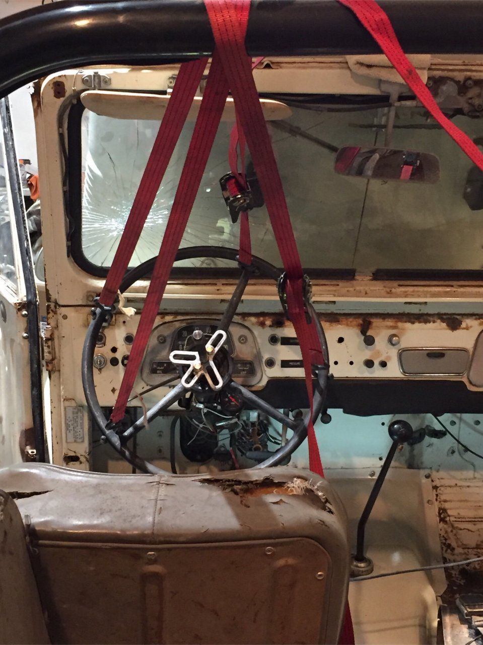

Hopefully your steering wheel isn’t as stuborn as mine.

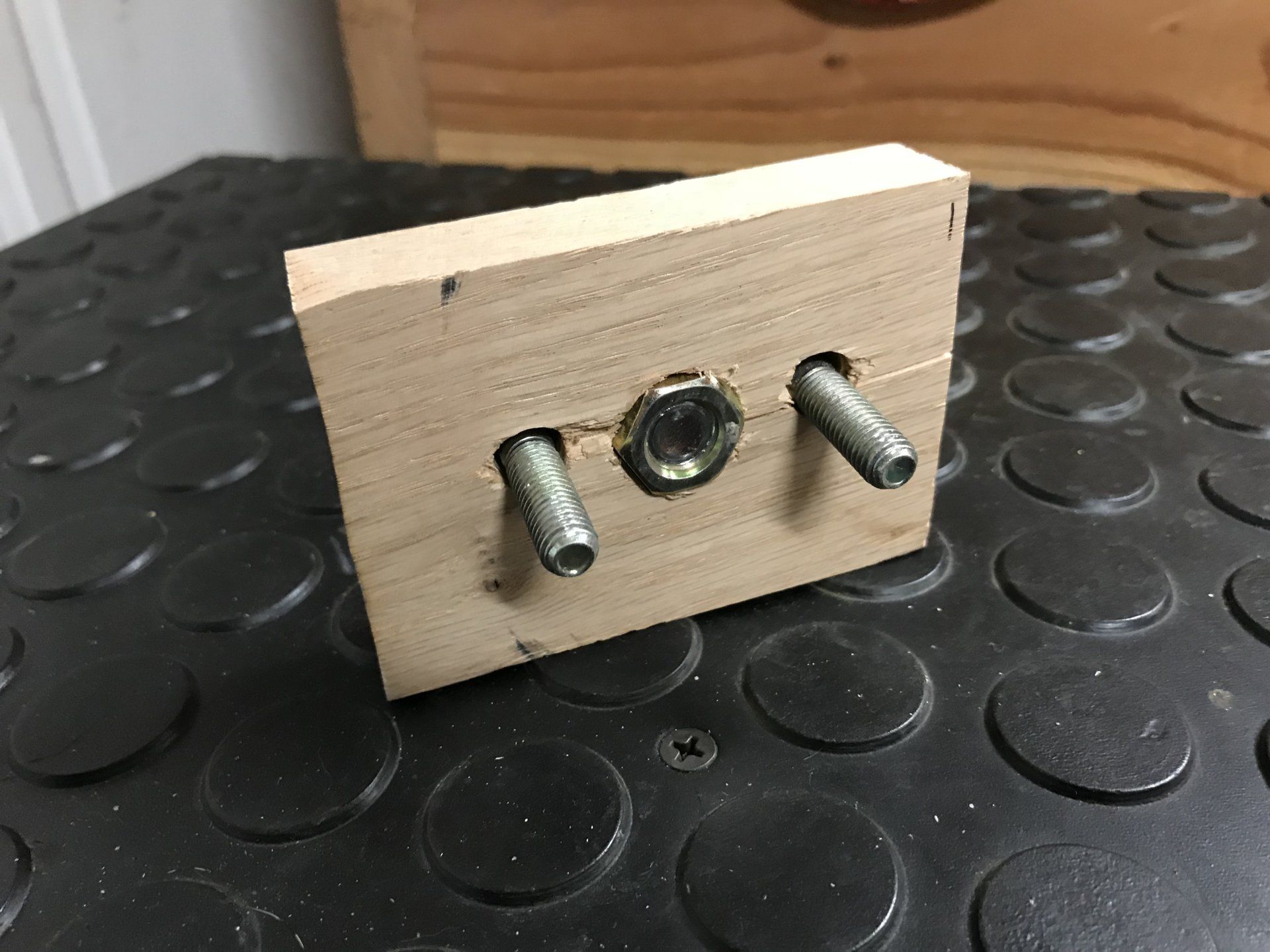

Wow that’s crazy! I just tried my home made steering wheel puller made of hard wood and three bolts I thought it was going to work. Ended up splitting the wood. Will grab a real puller tomorrow...
Got any 1/16" scrap steel? Make an oak samich - should protect it from splitting.
