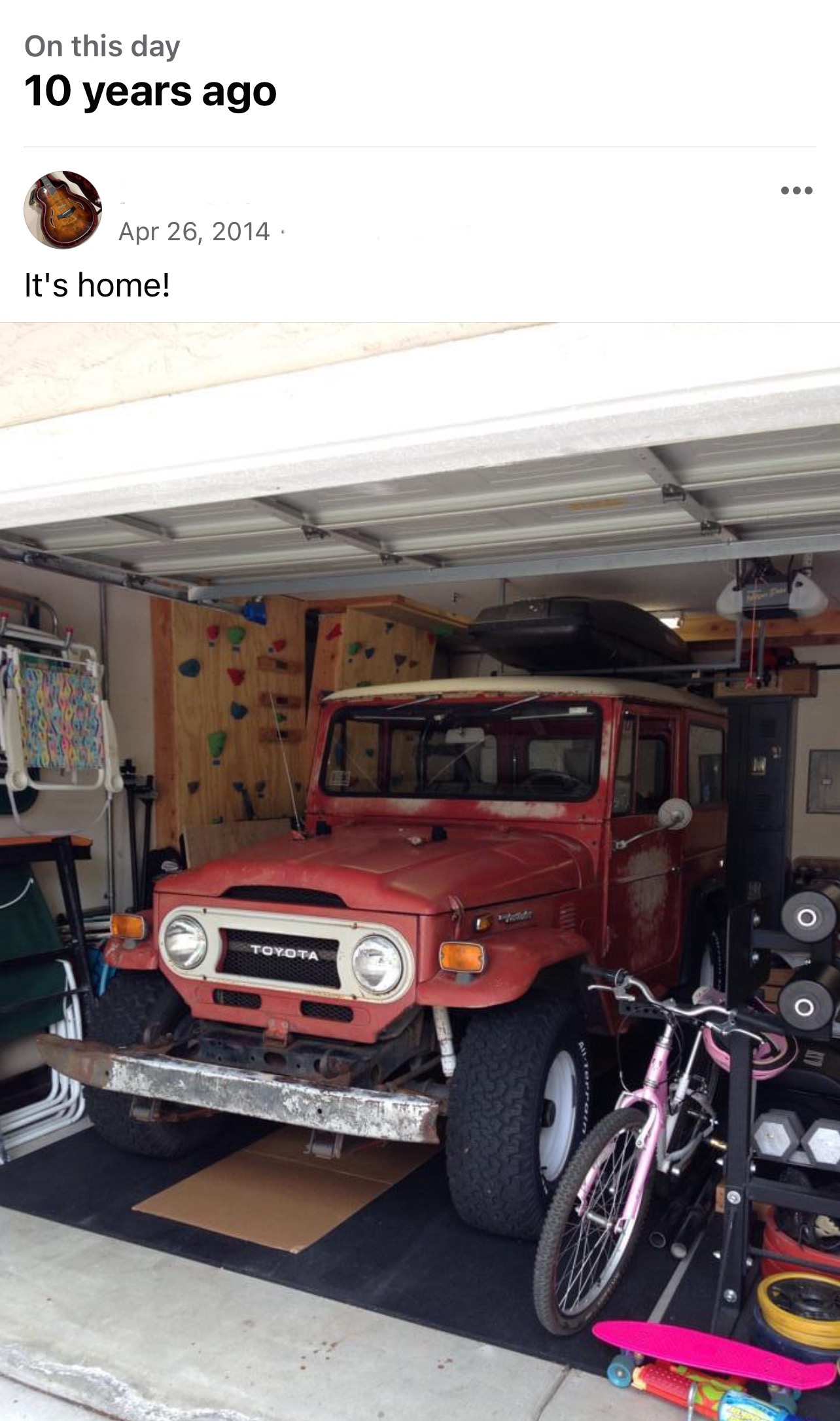

Happy 10 year anniversary!!!
Wow it’s been a long time since I’ve been here! Priorities, life, etc. Haven't been doing much on or in the Land Cruiser, I think in 2025 I didn’t drive it a single mile sadly. But I am now retired!
