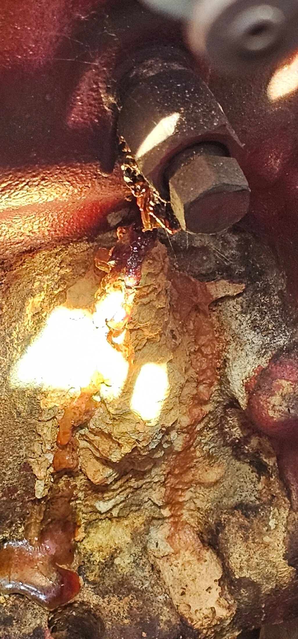

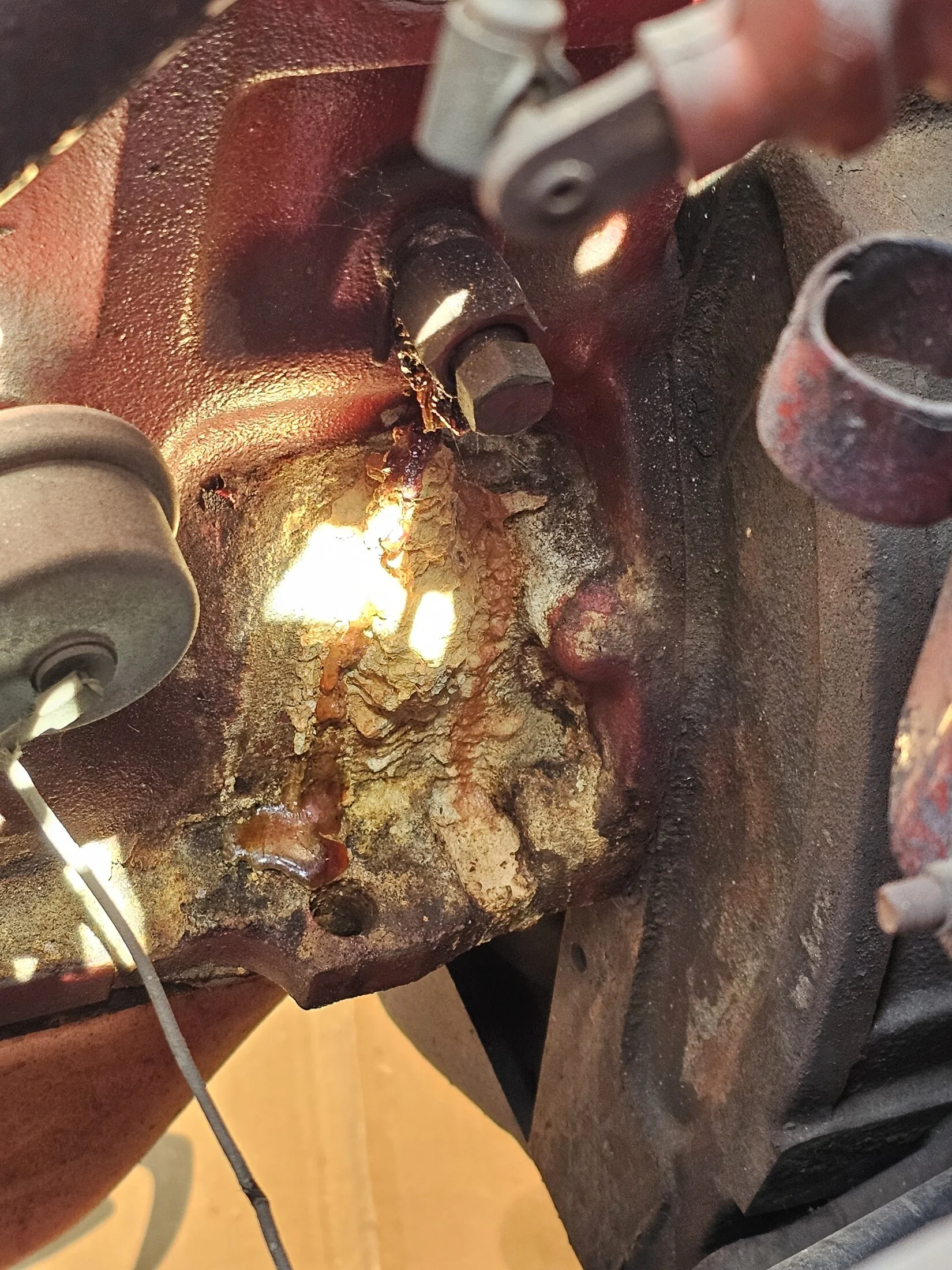

While doing all that, I found this little bit of a mess developing.

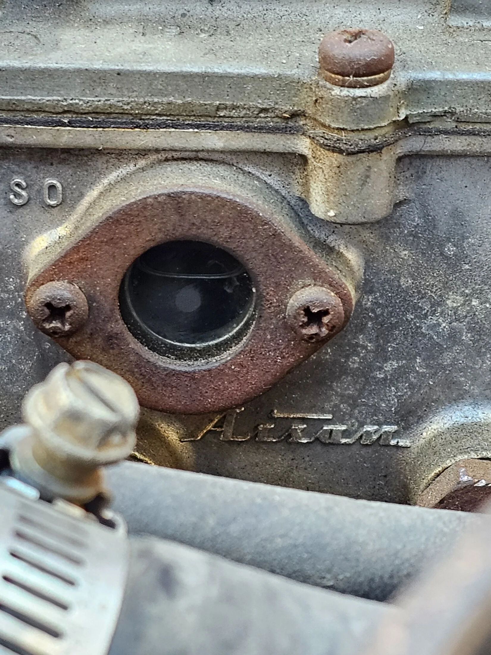

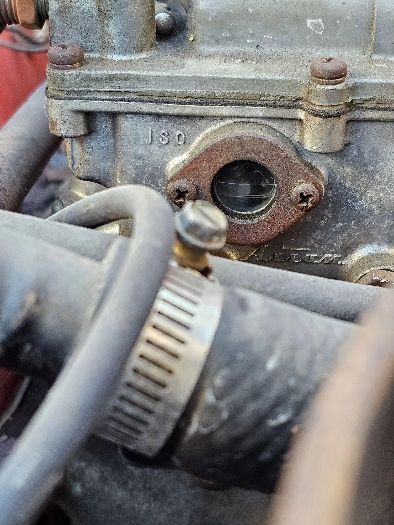

While you're trying to crank and get it to start what's the fuel level in the sight glass
I'm unable to see the sight glass when I crank it over. I'll need to get an auxiliary switch that I can use from the engine bay.
This the carb or the block?? Looks like the coolant plug on the block! Open it and flush coolant system is what its for.

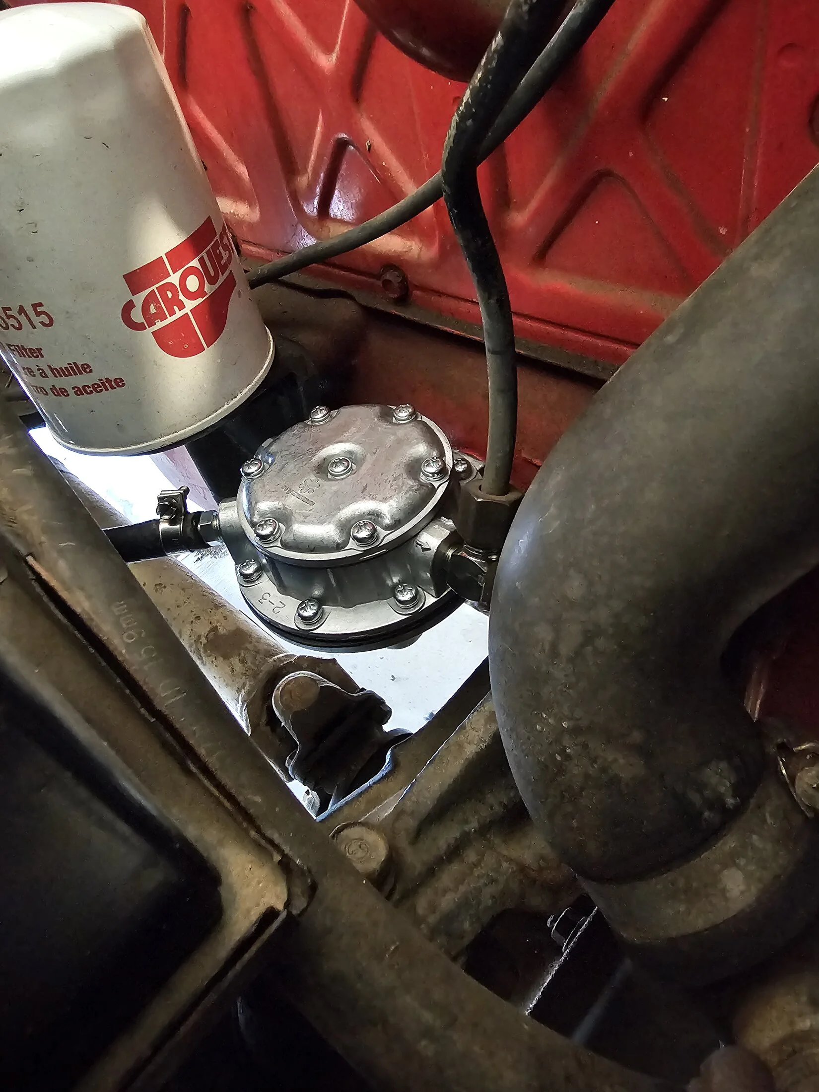

I disconnected the fuel line from the pump to the carb and put the hose in a bottle, I cranked it over for about 4 to 5 seconds and got a decent amount of fuel in the bottle. So the pump looks like its putting out. I reconnected the fuel line, dumped the fuel from the bottle into the carb, cranked it over and it fired right up and idled fine for about 15 seconds. The fuel level in the site glass after that now is about 3/4 full.

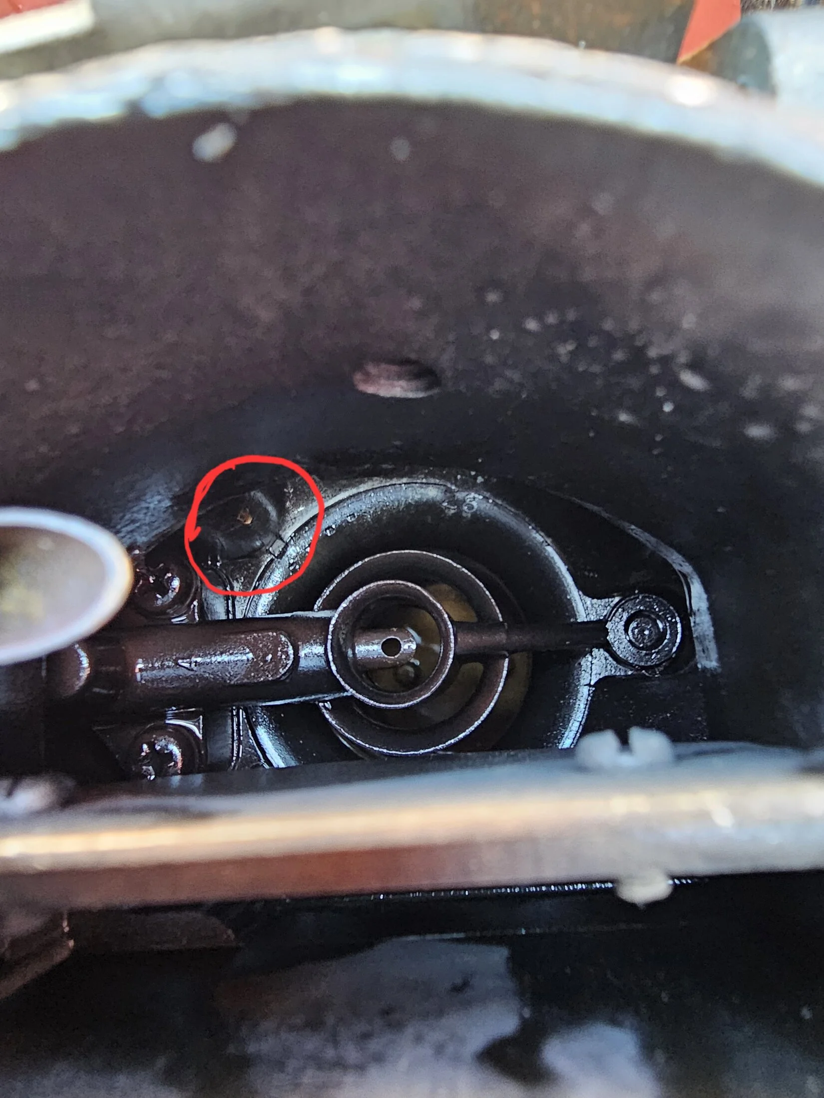

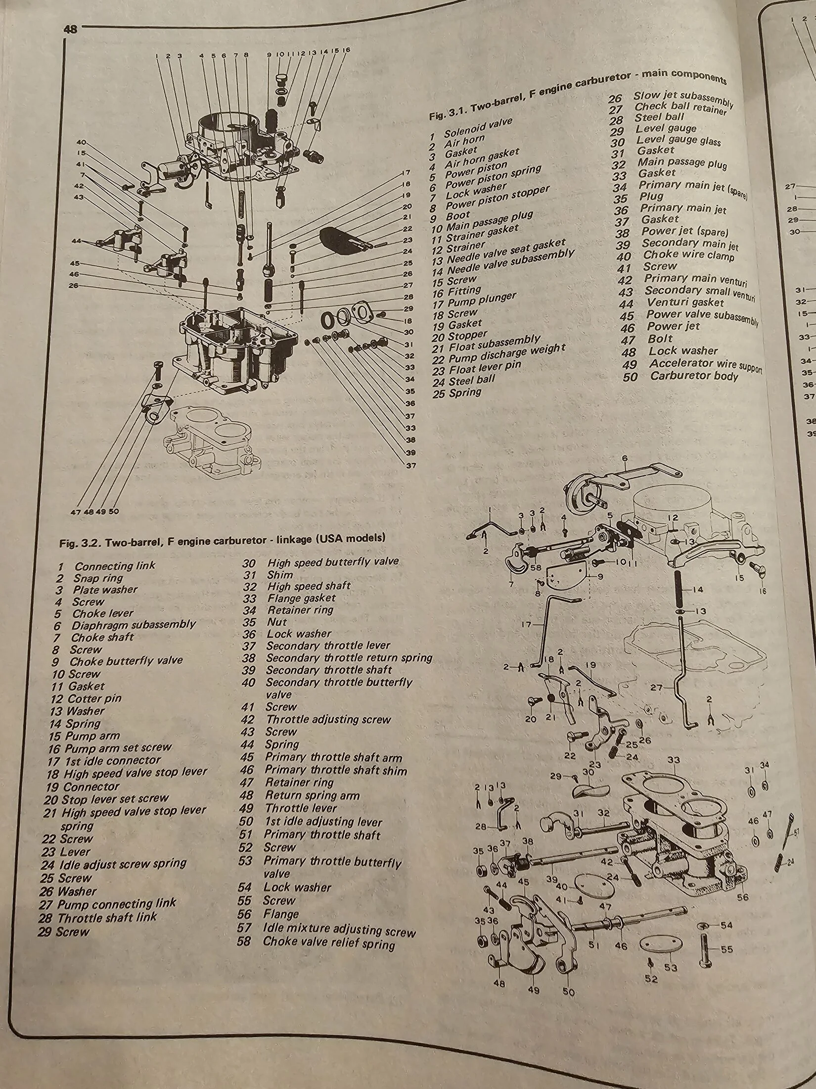

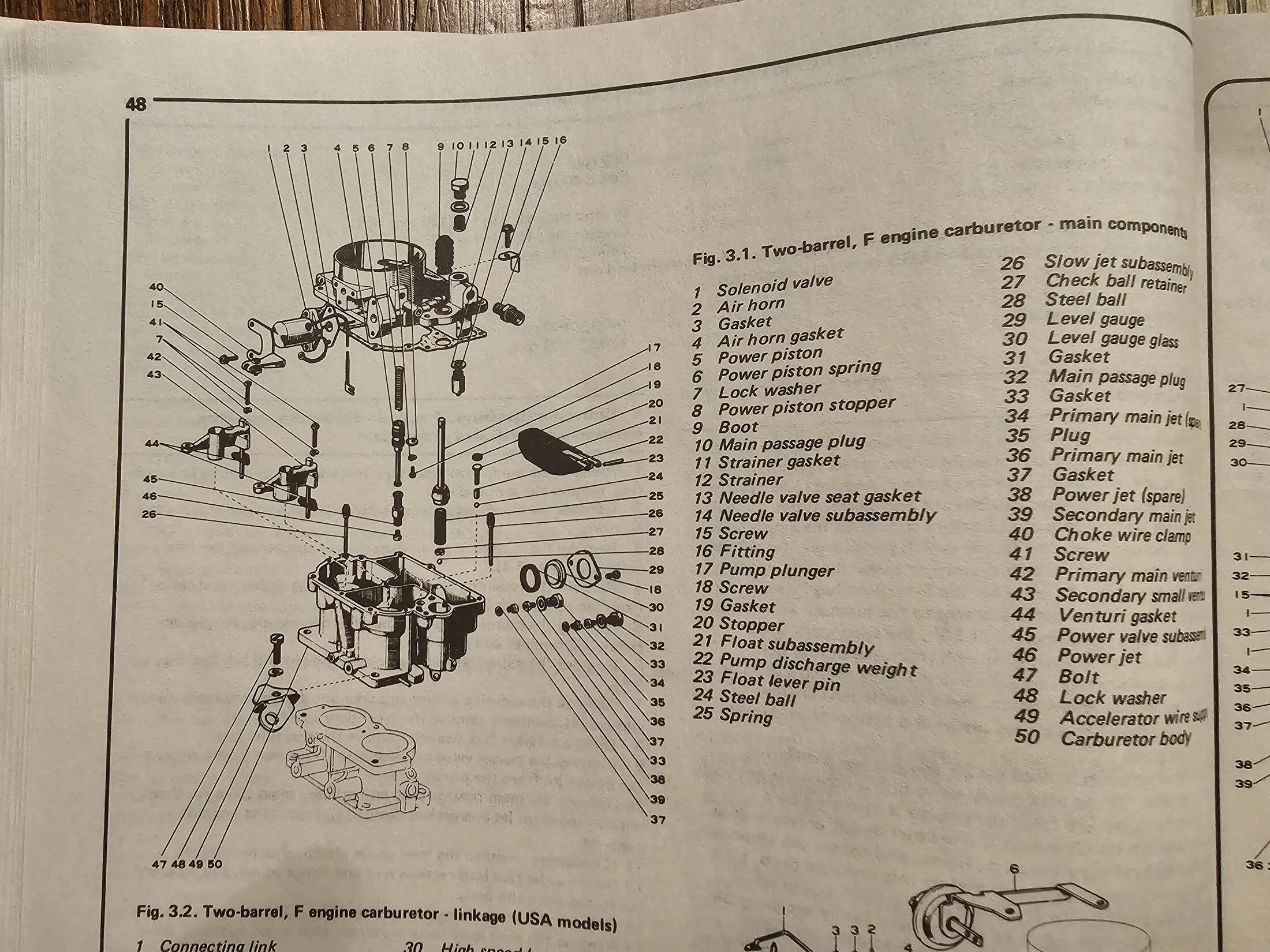

I'm still having issues with the carburetor. Initially I was having problems with it in 3rd & 4th gear after about a quarter throttle. After finally making some time to work with it and ordering a new fuel pump, now it will idle fine but once you give it gas, it falls on its face and then picks back up.
Have you pulled the air horn off and looked at the accelerator pump plunger? Mine did something similar when the rubber replacement plunger I installed wasn't sitting correctly in the bore (part of the rubber folded over itself). It would idle fine, but stumble as soon as I stepped on the gas.
Regarding the earlier question about the fuel level, it should be right in the middle of the sight glass. In the picture you posted (post #91), the level looked correct.
I have not, thank you for sharing. I'll look into it. I do see that the boot to the pump plunger has deteriorated. I don't know if that would cause any issues.
No problem, it was just a though given I had experienced something similar. Be sure to check the easy stuff like timing, vacuum, and ignition too, I'd probably do those before tearing into the carb. Good luck getting it figured out.
