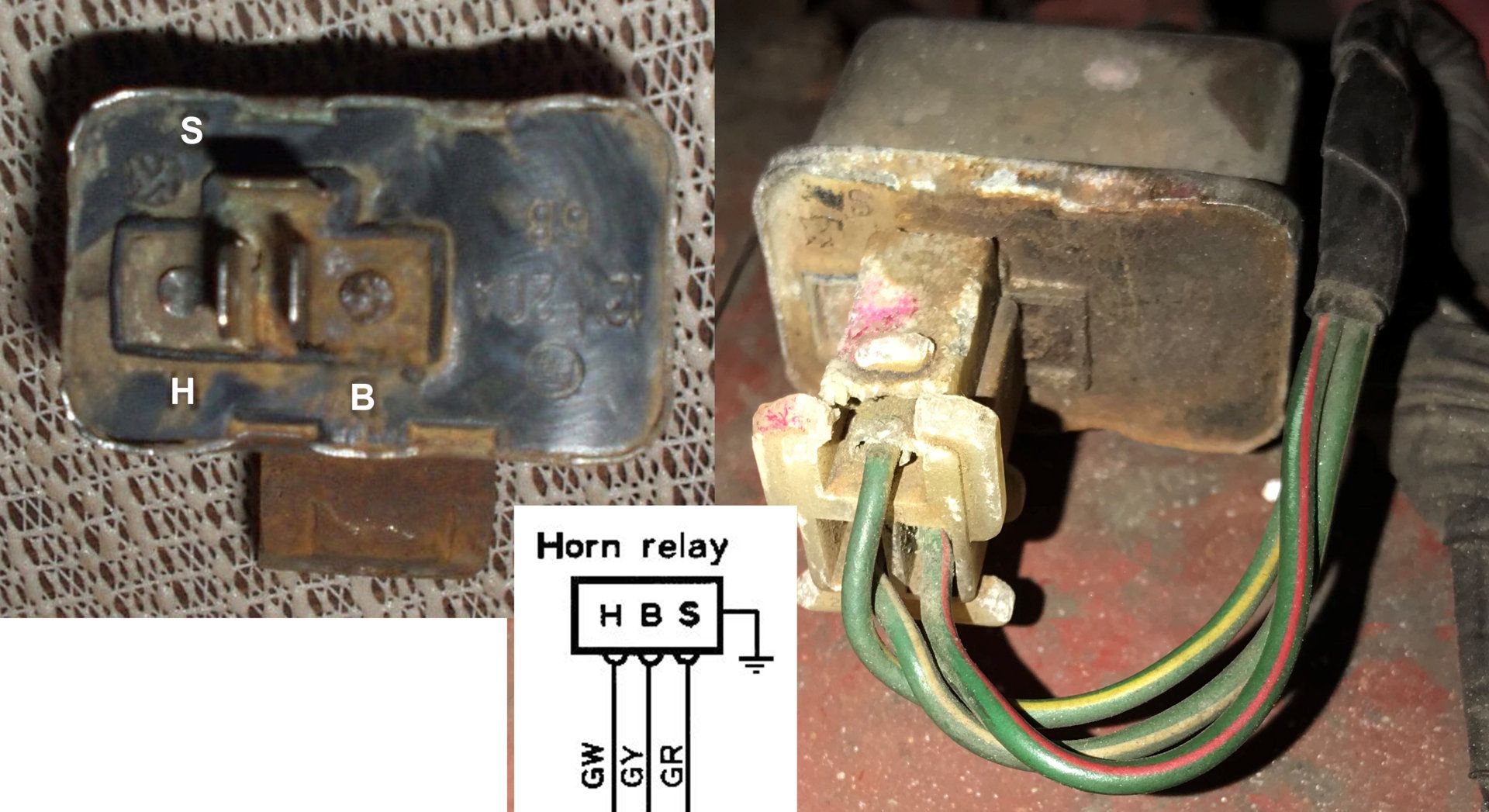

Been looking at wiring schematics and noticed something interesting... The plot thickens. Appears my GR and GY wires are flip flopped. Very strange that it has been working all this time until recently. I will have to try and flip flop the wires to see if that makes any difference. @Dudleyfj40 your comment on being wired wrong looks correct! Still doesn't explain how it has worked all this time. Hopefully changing them to how they're supposed to be will work! Keeping fingers crossed.

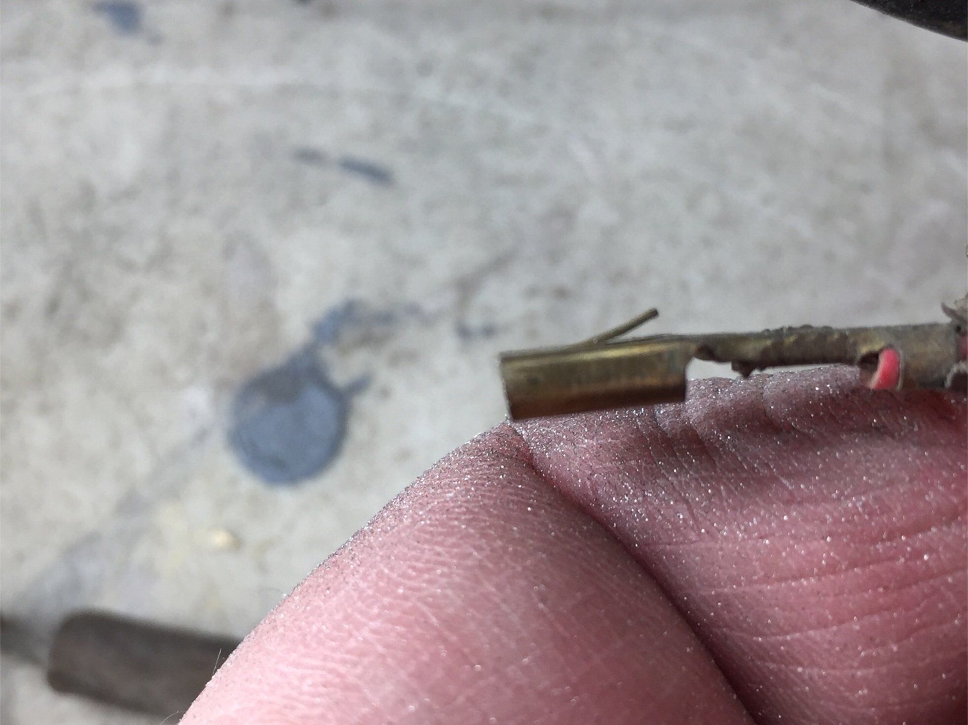

Is it possible with the sum of the parts, you still have too much resistance? If you haven’t done so, might not hurt to remove the female spades. Check the crimps and scuff away. You could open the crimps up if the wire looks oxidized or corroded, cut a 1/4” off and re-attach spade to fresh copper. Use a small pick for that.

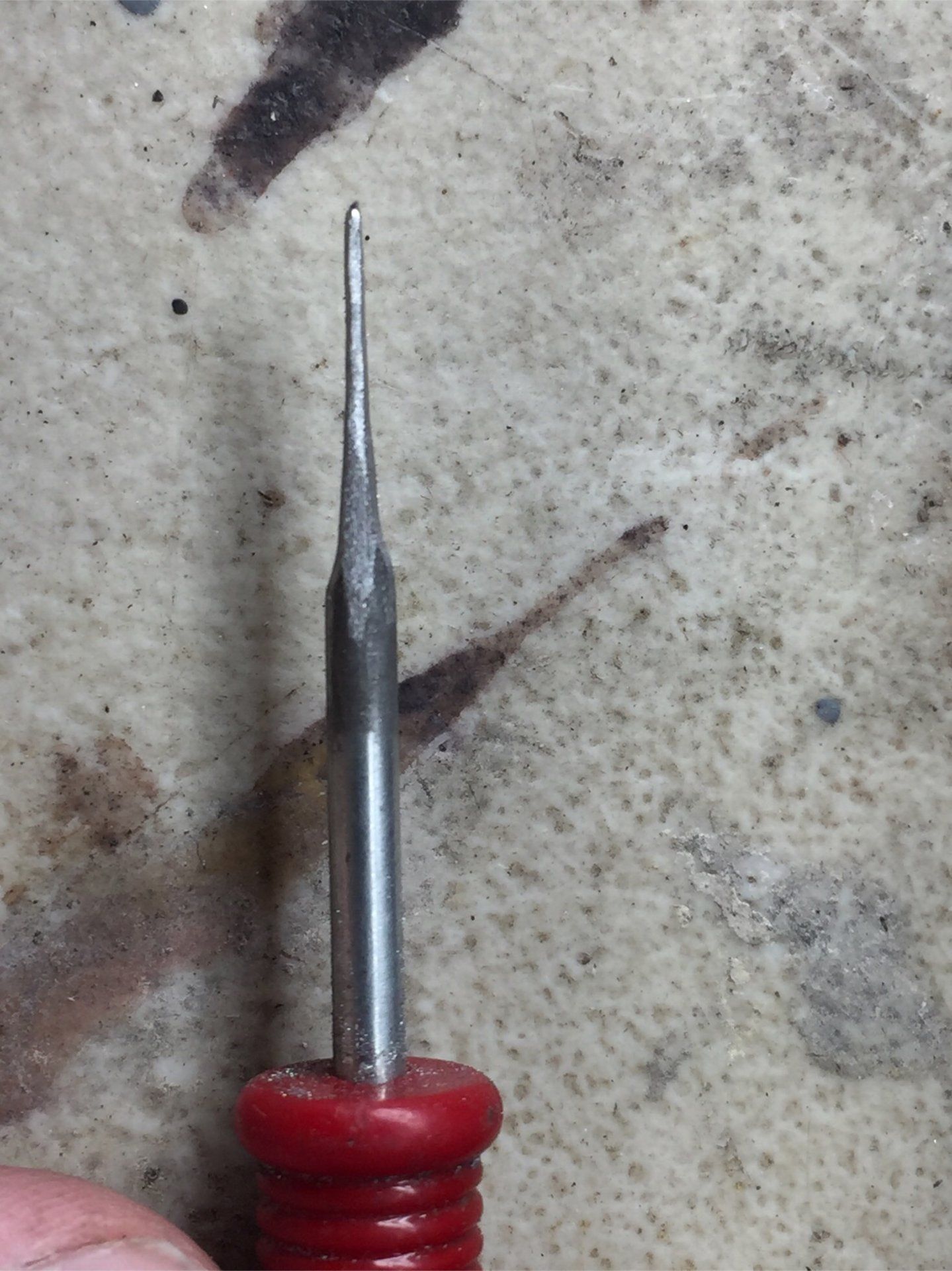

I ground a small screwdriver down to remove spades. The trick is to push the spade into the plug as you insert the release tool. If you just insert the tool, it will push the spade backwards and the lock tab catches in the plastic slot.

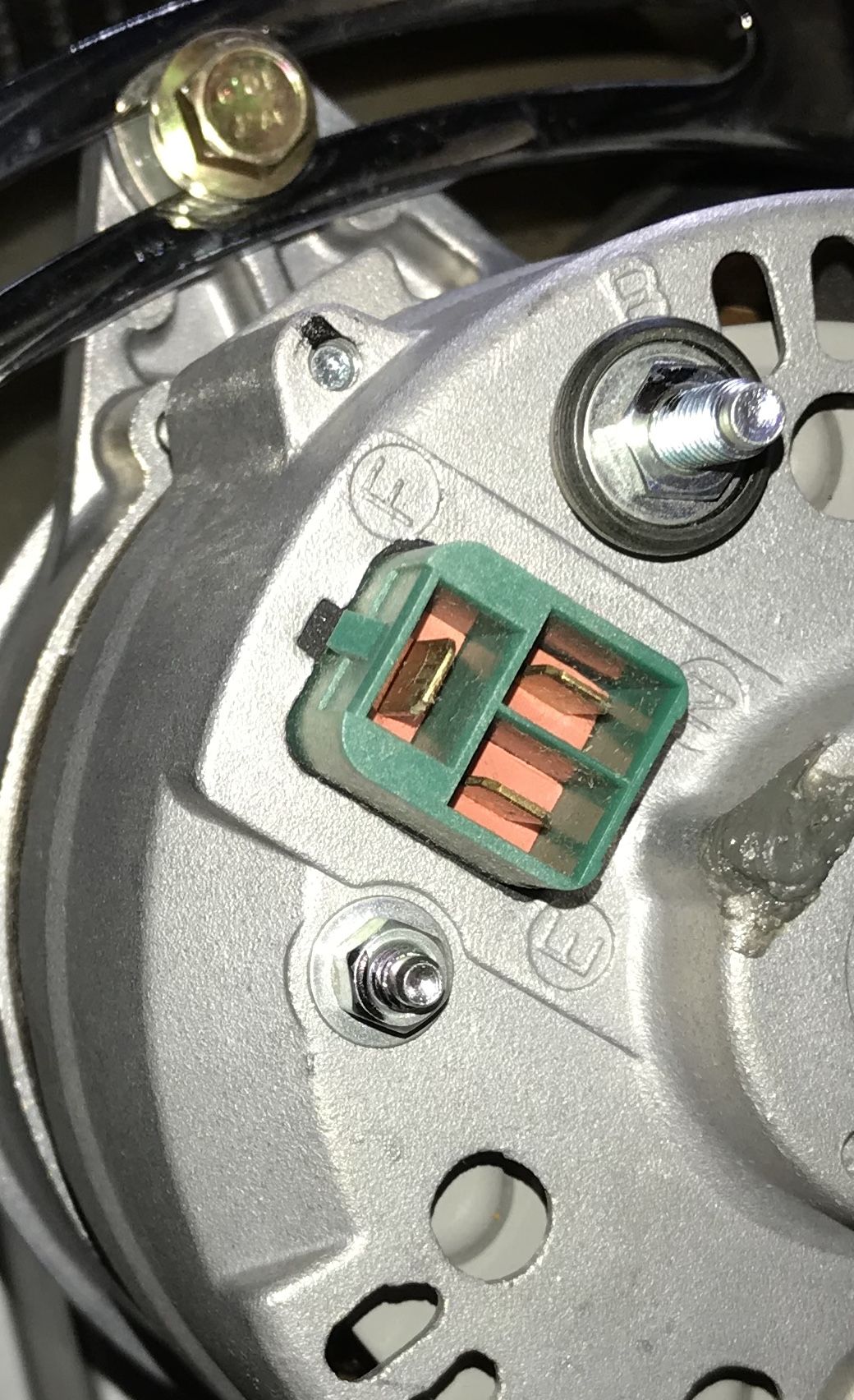

Decided to table the horn for the time being and get back to driving it. New OEM alternator installed - thanks @orangefj45 looks beautiful and certainly will be more reliable than what I installed previously. Good thing I didn’t try to install this when I was frustrated as I may have missed the slight differences in the letters on the plug. Installed fresh new connections and rubber boot thanks to @Coolerman!

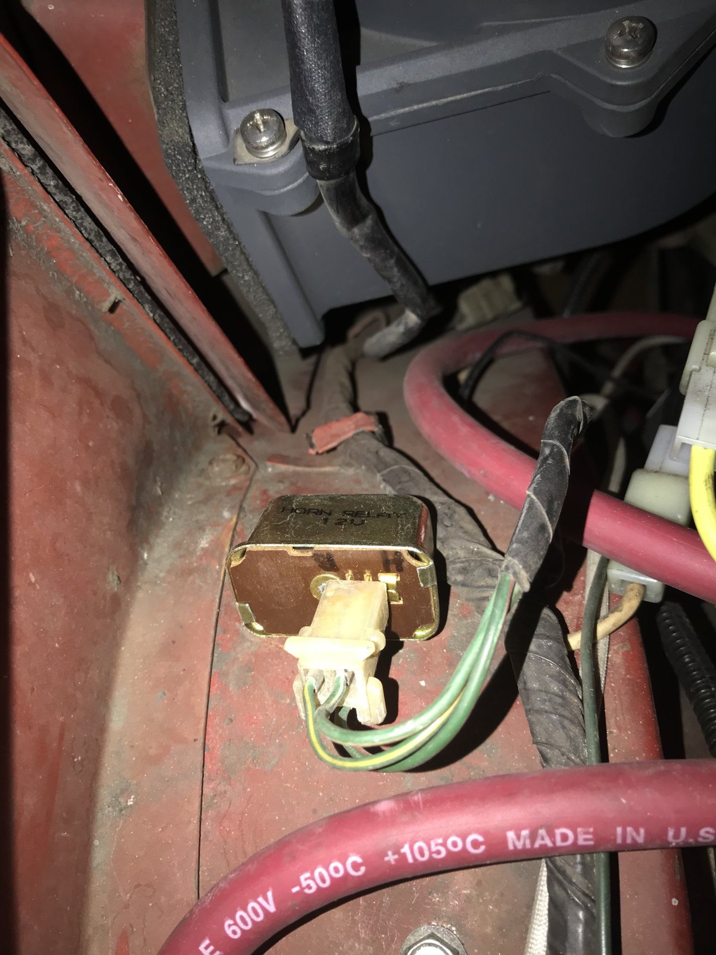

I decided to get a new relay, figured if nothing else I’d have a backup - thanks @Racer65! Sounds like the availability of even this aftermarket version is nearing extinction. Swapped the wires so they are correct (thanks @thebigredrocker for the tip). Cleaned the connections up some, hit the horn button, and...
Clickity click.
