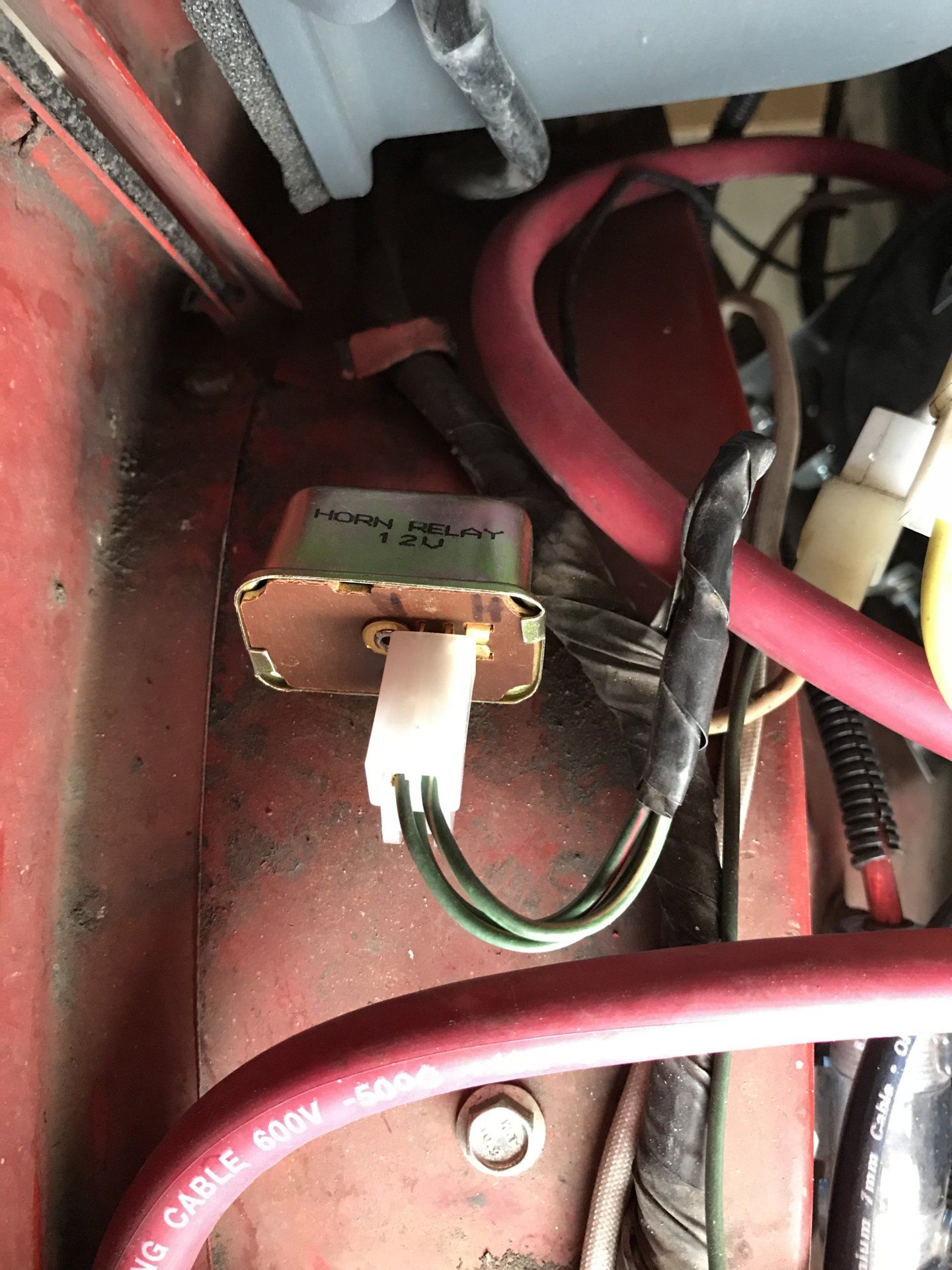

Have you pulled your horns and cleaned their ground paths to the radiator bracket? Could also run a grounded gator clip to the radiator bracket itself.
You’ve probably seen coolerman offers a relay. One would think your new relay is good to go. Never know though:meh::cheers:
Sounds like your connection between steering and relais is intact as the relais clicks when the button is pushed.
Sounds like you have enough ground for the relais but not enough for the horns.
The relais is a remote switch. This means you have two circuits, one switch between the relais and the steering wheel. The other is between horn and relais. When the relais clicks when the steering wheel butten is used, that circuit seems to work.

Decided to try and troubleshoot the horn again - swapped out the relay plug and put all new connectors on. Ran independent ground lines from each horn. Opened up each horn to check condition. Cleaned up grounds. And still nothing. I tested the horns and they work when I ran a hot right from the battery. Both work even without the independent grounds. So it’s somewhere probably at the steering wheel? Maybe I did something when I took the wheel off. Will try and check that again at some point. Too irritated to do that now however... walk away... just... walk... away.

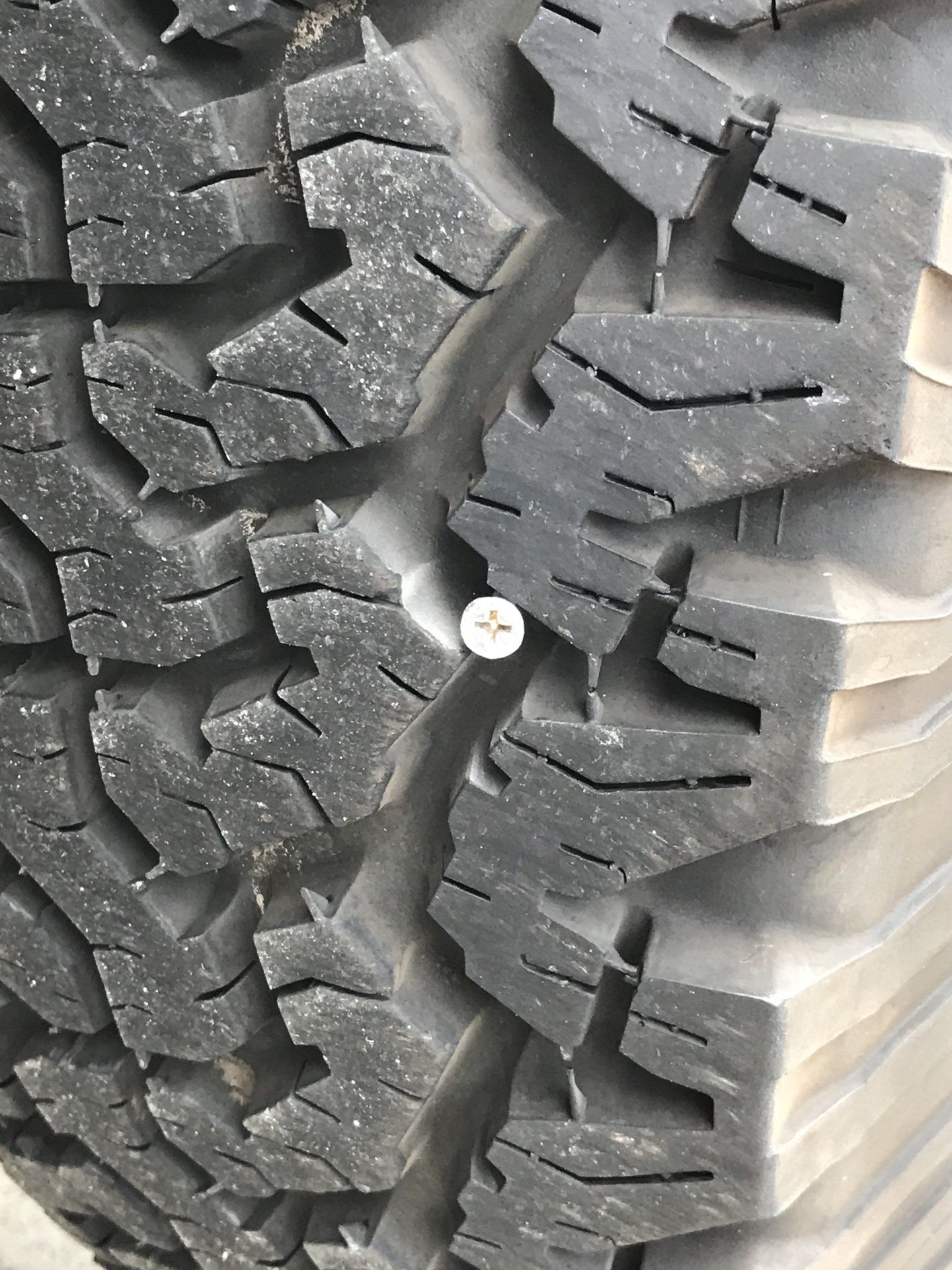

Was going to take it for a spin and noticed what I thought was a rock wedged in the tread. Nope, a screw. All that tread and it finds a gap. Ugh. Thanks for rubbing salt into the wound. No problem I’ve got a tire repair kit. Well let’s just say that didn’t go well broke the handle on the tool after fighting it big time and had to drive and get another one. The new tool worked much better and patch went much more smoothly. Nothing can be easy. So really I accomplished nothing today despite spending hours on this stuff. Yay.

I had the same problem with my horns. Could get them to work hooked straight to the battery but not hooked thru wiring harness. A few things I had to mess with to get them dialed in was.
Check that the steering wheel contacts are grounded through the rag joint. Also I had to adjust the center adjusting nut on horn just right. Another was run a separate ground to the horn which sounds like you did that already. Check and clean horn contact buttons at steering wheel. One more thing was I had to change out the contact from the steering wheel to the steering column, it was worn down to nothing. Just some ideas for you, hope it helps. Sorry for the road hazard in your tire. That sucks!

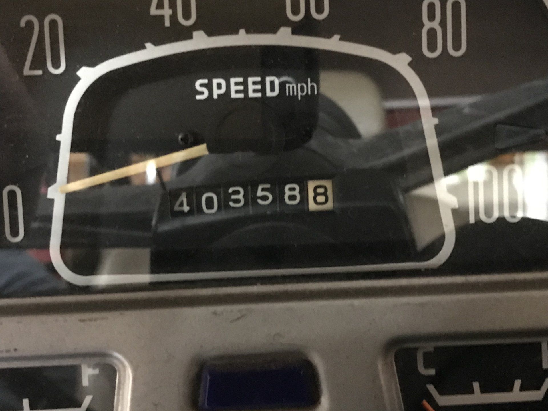

Annual oil change: 40,358
Last change: 4/10/17 - 38,544
So not quite 2K miles in the year even with the Cross Country Expedtion legs through Yosemite and San Francisco.

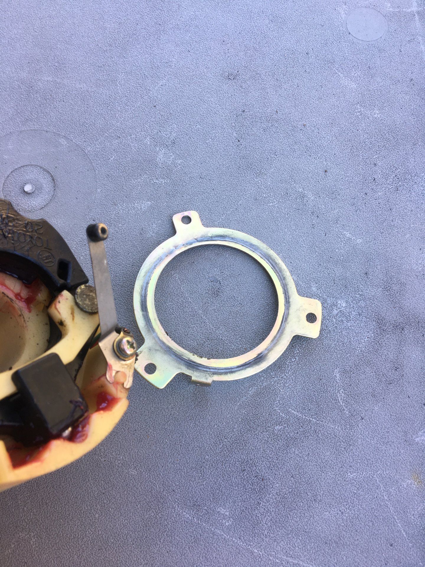

Well decided to give the horn another go. Took steering wheel off, cleaned up every ground/wire connection, cleaned up the contacts, tested for continuity from horn to relay (good!), voltage at relay (good!), things were looking good. Then pushed the horn buttons and... NOTHING. Not even a click from the relay now.
Yay. :bang::bang::bang::bang::bang:
probably sounds like a dumb question, but have you tried pressing closer to the inside of the steering wheel? I found depending on where I was pressing the little horn buttons it would not work, but I found if I pressed the points closer to the inner part of the steering wheel, it works. Not exactly sure where the contacts are, and how/where they touch, it's just a thought especially since you feel like you've checked everything else.
