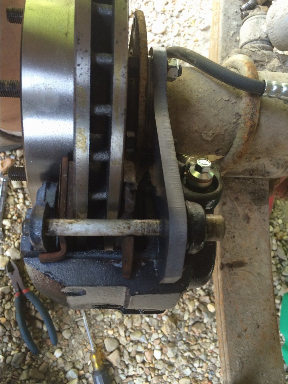

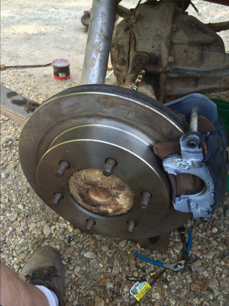

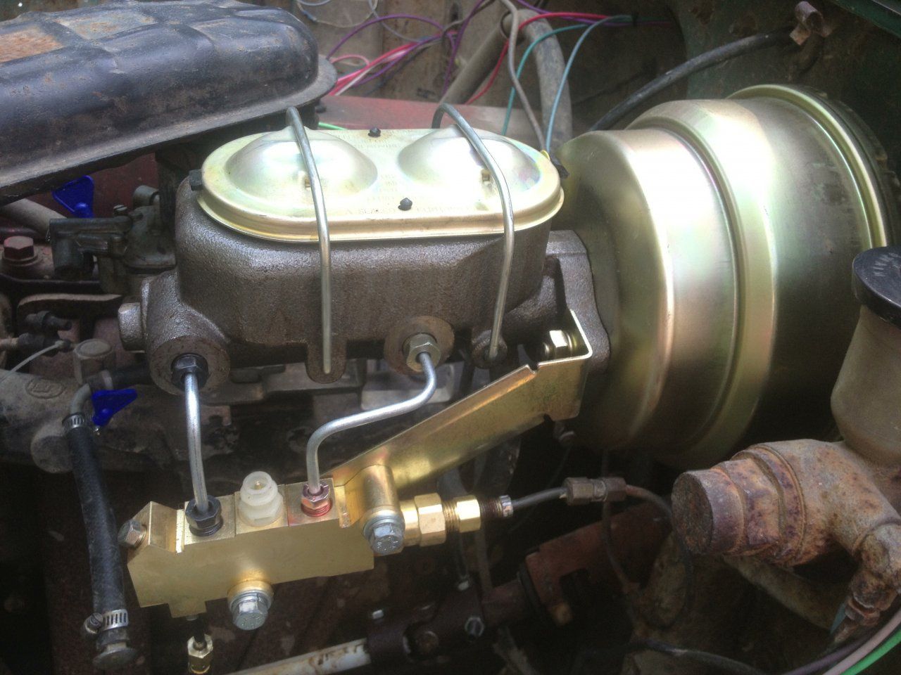

I got every thing I needed for my rear disk brake conv. Baring a few compression fittings. From poser for about 280 plus a set of 2000 s10 calipers from a junk yard (free) and a 20 dollar set of pads. View attachment 892033
View attachment 892035 Tho you will need brake fluid and an adjustable prop valve on the rear line off the master cylinder summit has them for around 40 bucks. But you can go with a master off of a 76/40+ or a 60 or 80 series even a mini truck but you have to have the newer more powerful booster I have the btb brake booster with the gm 1 1/8 bore master cylinder and it was about 400 shipped. And it bolts in, no modsView attachment 892036
And you can pick up a set of 60 or 62 outers for about 250-350. You just need to grind a touch of metal of the housing to fit the slightly bigger birf in. Or if you can find a pair of outers from a 9/75-80 fj40 it'll be a perfict fit
