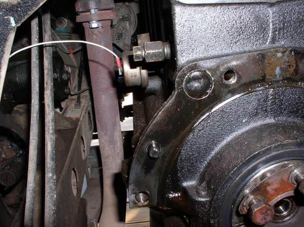

Here's My Leak..

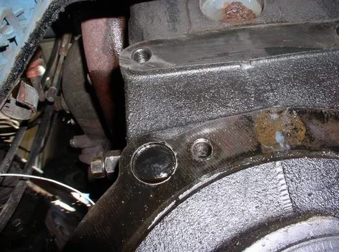

I am leaking from the oil gallery plug.

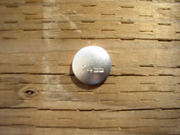

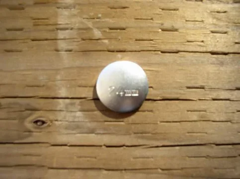

Did I get the wrong plug?
Should I change out this freeze plug? (I know the answer... Yes. I don't want to go back in here for a while).

When you de-grease and clean the engine you will get even more leaks. I did that with mine and removed the coagulated grease that was acting as a seal. It really started leaking then. It has goobed up now and I only lose about a quart every 1000 miles now.
