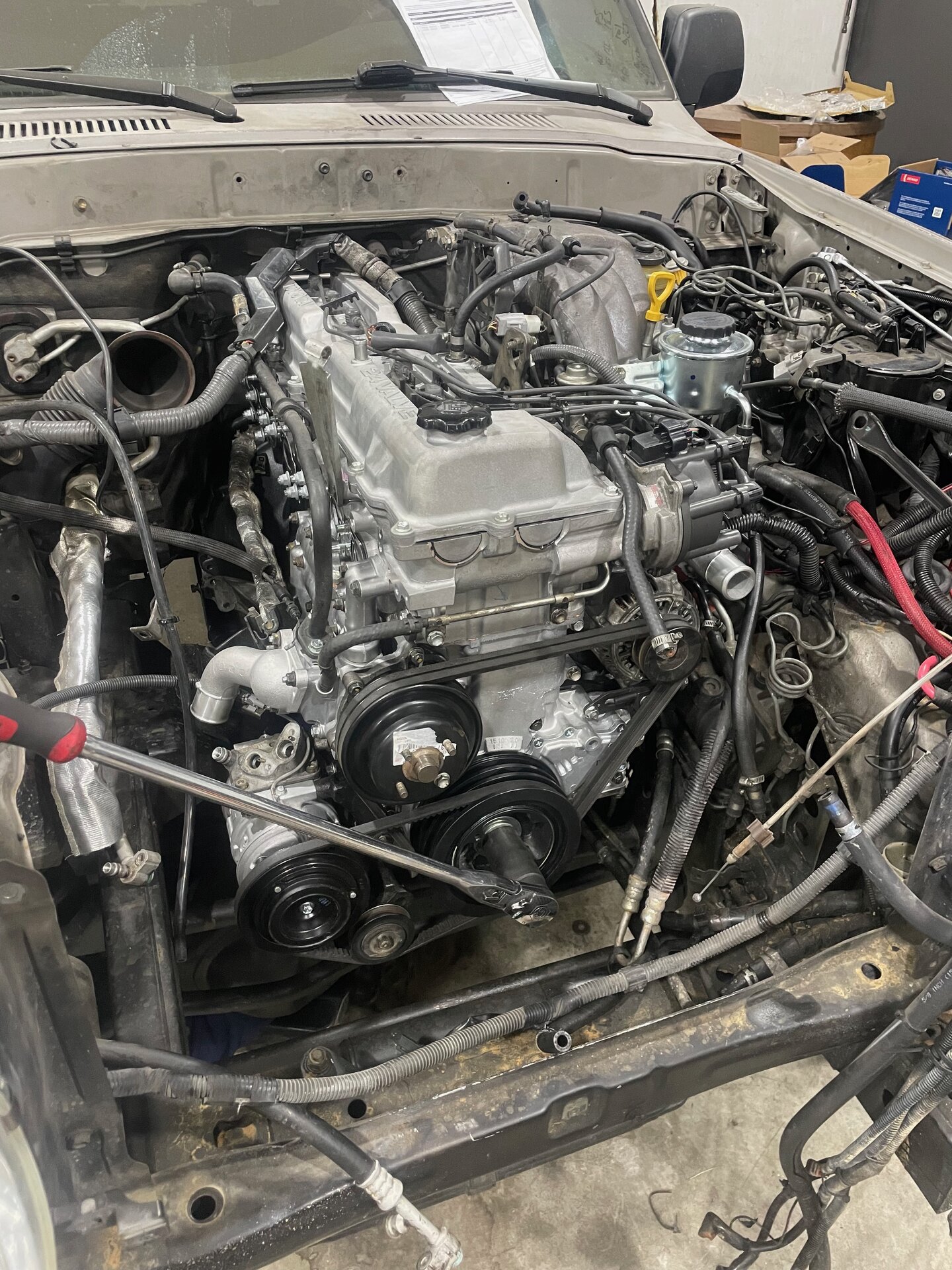

Rebuild #1 included larger Brian Crower valves, 33mm intake & 39mm exhaust according to the invoice from the now defunct engine builder/machine shop. The engine ran perfectly prior to the rebuild minus oil consumption, i.e. no HG failure or overheating. I just wanted it to be solid for the turbo install. I also had this shop weld the oil return bung to the oil pan, it's the only thing that lasted.
Rebuild #2 was necessary due to an intake valve not fully closing. Still not sure how this occurred, other than poor machining or reassembly during build #1. Not the best picture, but you can see it on the far right.
Compression readings after rebuild #2:
1.187
2.194
3.190
4.196
5.189
6.192
After a few thousand miles on rebuild #2, my CEL comes on with a corresponding engine shudder/stumbling at idle. I did a compression check and found #3 was low (70). At this point, I was about to head out of the country for several months, so I towed it to a new LC specialty shop. Given the two failed rebuilds, I decided to bite the bullet and go with a new engine. I never got a solid answer on why compression was low, but the block visually appeared ok while the Blackstone report was inconclusive. If I had to guess, it was something on the upper cylinder that failed again.

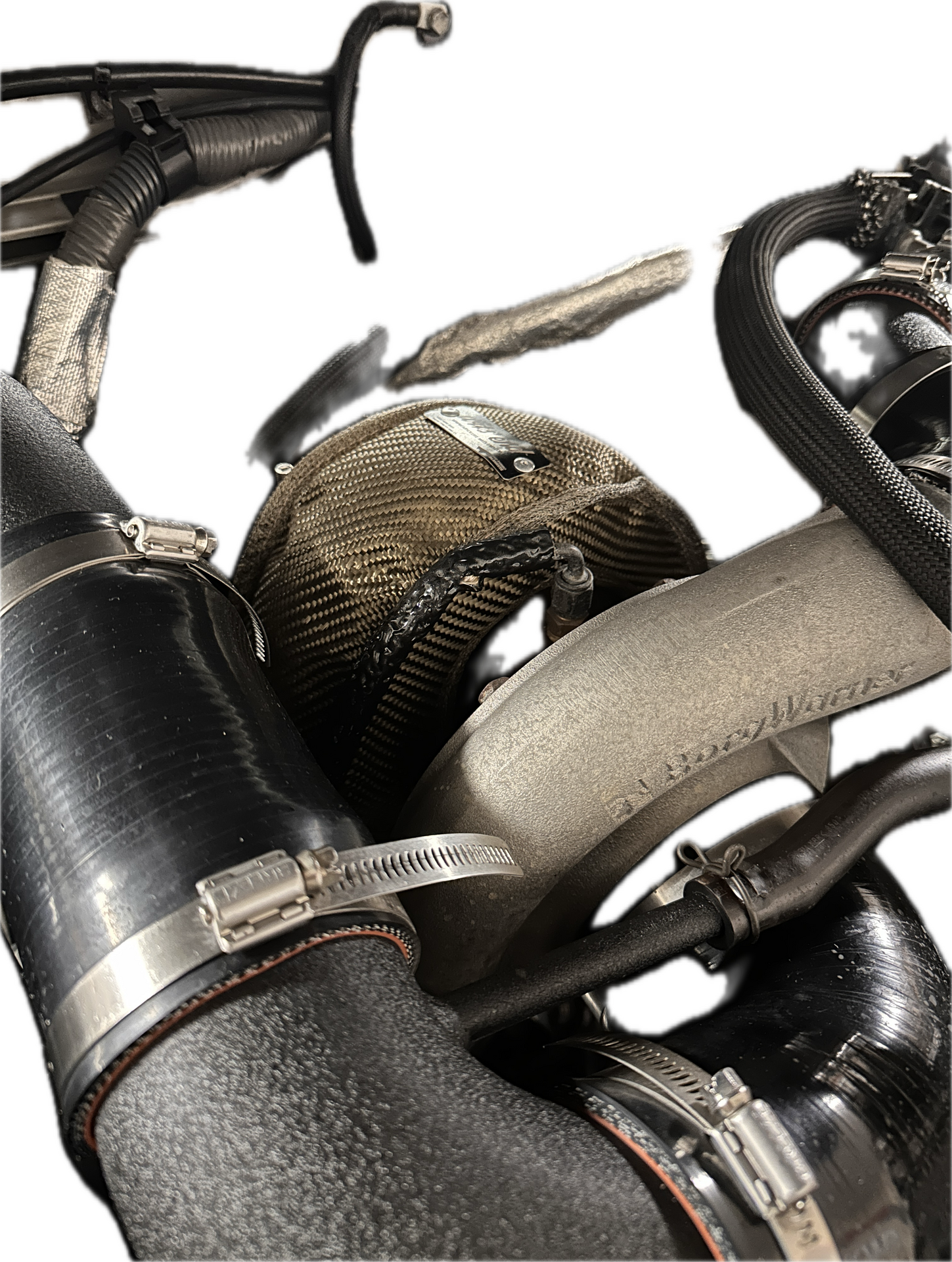

Currently have ~600 miles on the new engine. Other than an upstream O2 sensor all is well so far. The shop verified boost was in the ~7PSI range but I still do not have a permanent boost gauge installed. It's definitely on my short list of upgrades, just can't decide whether to go with the Lutz clock kit or a dedicated gauge on a Delta console.
1.187
2.194
3.190
4.196
5.189
6.192

If you want to stay with stock ECU, IC is the only addition that I’d consider. However, I probably wouldn’t even bother…it’s never going to be a fire-breathing dragon on the stock ECU. It’s massively better than NA and still mostly stock for simplicity.
Hey Mike - would you mind sharing a post about your injector setup, etc? Sounds like you're successfully running 10psi with the supra pump?
Sure,
I bought the scaled injector kit from LandTank. That kit replaces the stock AMF housing with a milled aluminum housing with a larger ID. It uses the upgraded MAF sensor that he also sells. Then, the injectors are switched out to Subaru WRX injectors. The ID of the MAF housing is scaled with in a ratio to the higher flow rate of the injectors. This gives more fueling capacity as it tricks the stock ECU. This technique has been used on Supra engines for a long time.
LandTank intended the kit for supercharged 1FZ-FE's. Joey was going to test it with the turbo kit, but I do not think that ever happened. I went ahead and did it and collected some data on it with my turbo setup. The main thing I noticed was that when at WOT and the computer goes open loop, it runs richer than before the install. I had increased the boost to 8.5 PSI and tested with the scaled injector kit at that level. At WOT before the scaled injector setup, Lambda was running .82 to .85. After the scaled injector setup, it went down to .74 to .77, a little more rich. I then added a Boost T and dialed the boost up to 10 PSI. This took Lambda back up to the .85 range at WOT and max boost.
After that, I added methanol injection to reduce intake temps and to reduce risks of detonation.
So, in total, right now I have the following fuel mods on my setup:
LandTank scaled injector kit (WRX injectors and larger ID MAF housing with upgraded MAF sensor).
Supra high volume fuel pump
Methanol injection (AEM kit, custom install).
I have just short of 2K miles on this setup so far. Mostly runs up to the Sierra from Santa Rosa and then off road. The boost really comes into play when climbing I-80 or 50 out of Sacramento. I have had climbs where the boost sits at 9.5 PSI for three, four minutes and the rig pulls 65 up the hill, fully loaded down.
Scotty has been warning me about detonation and I understand the concern. So far I see no evidence of it happening, but I am running a risk with the boost 10 PSI max and the stock ECU. There is no way to take timing out while under boost.
