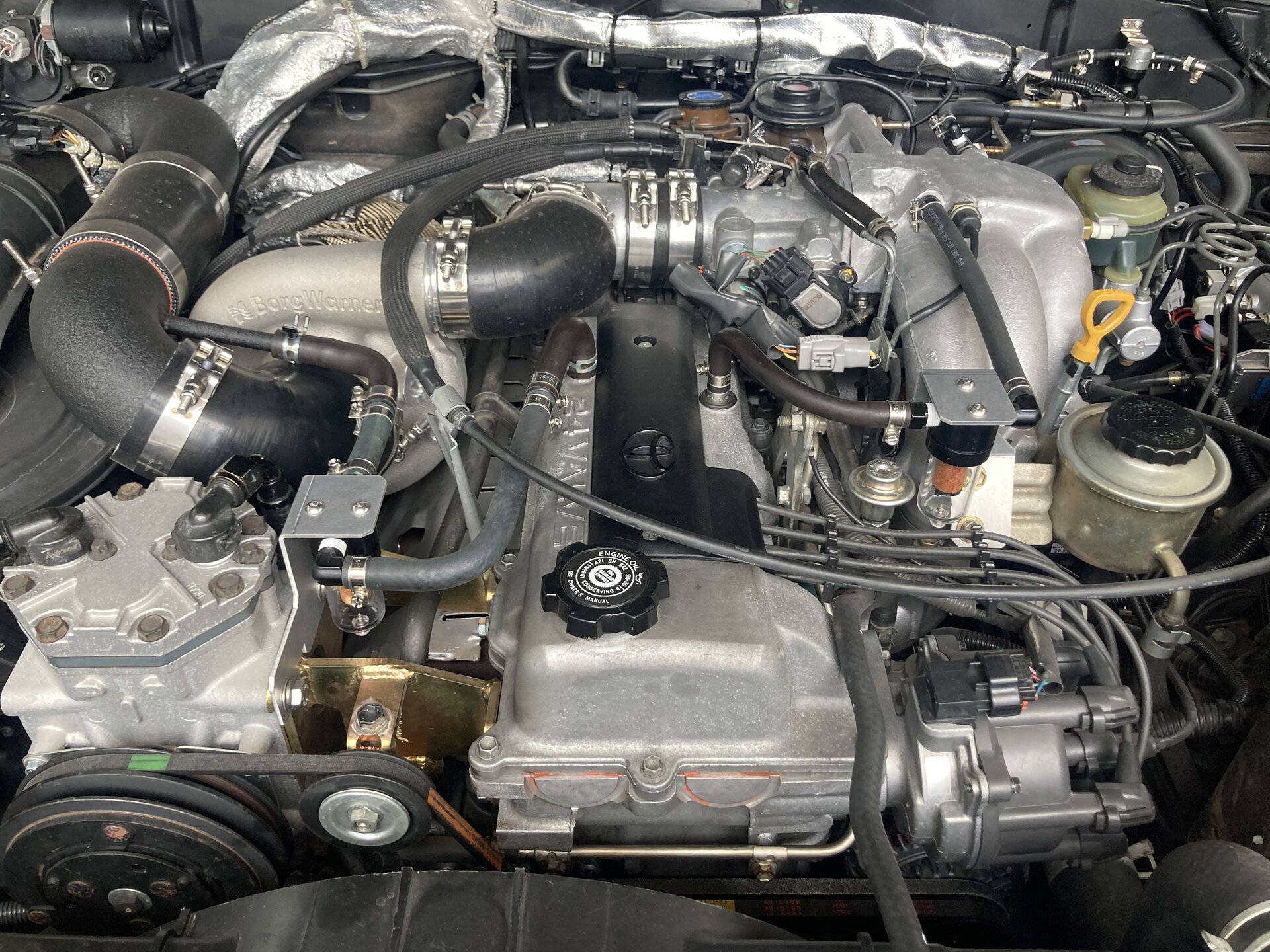

First picture for this new thread of my oil catch can design, installed.

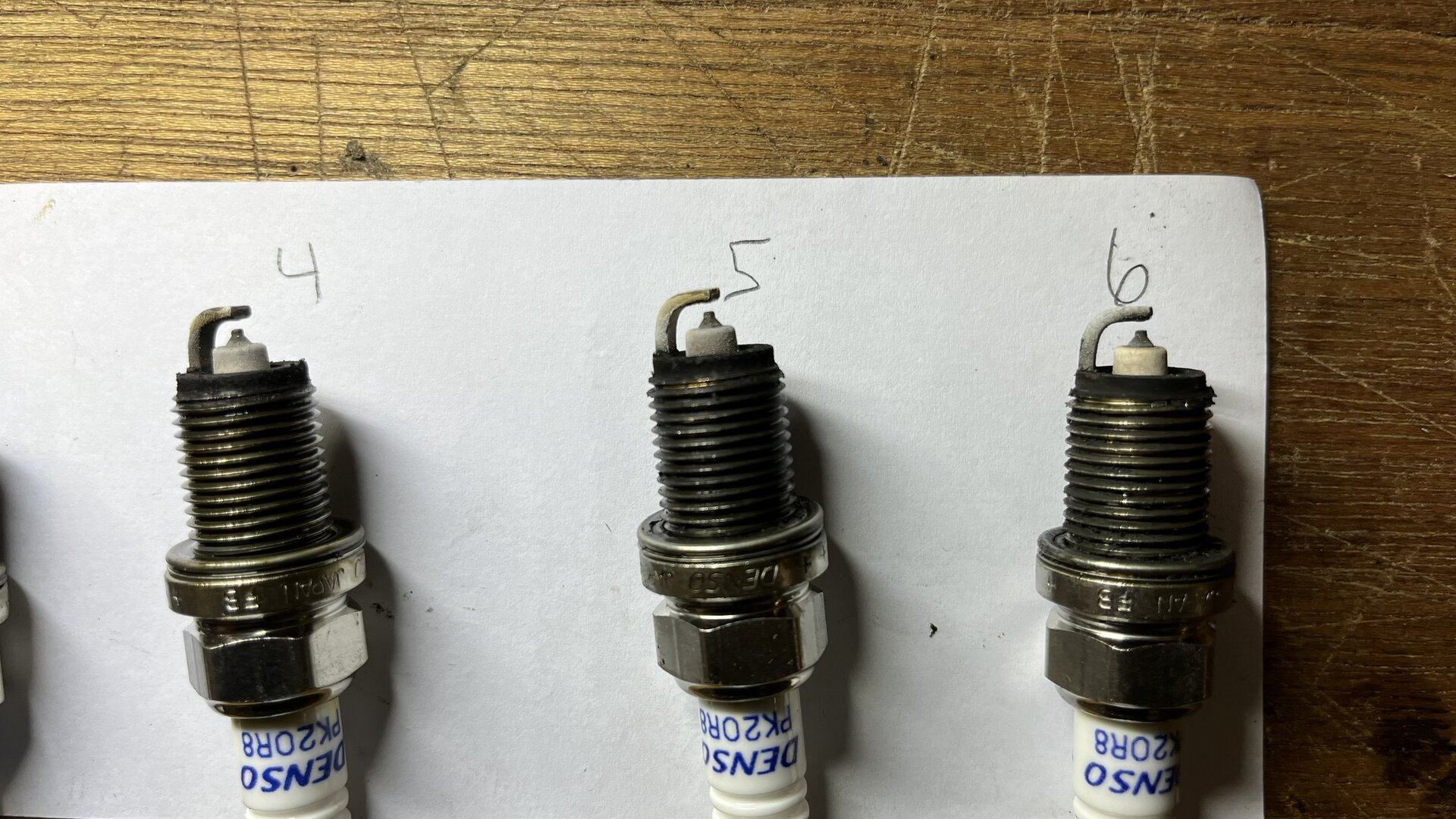

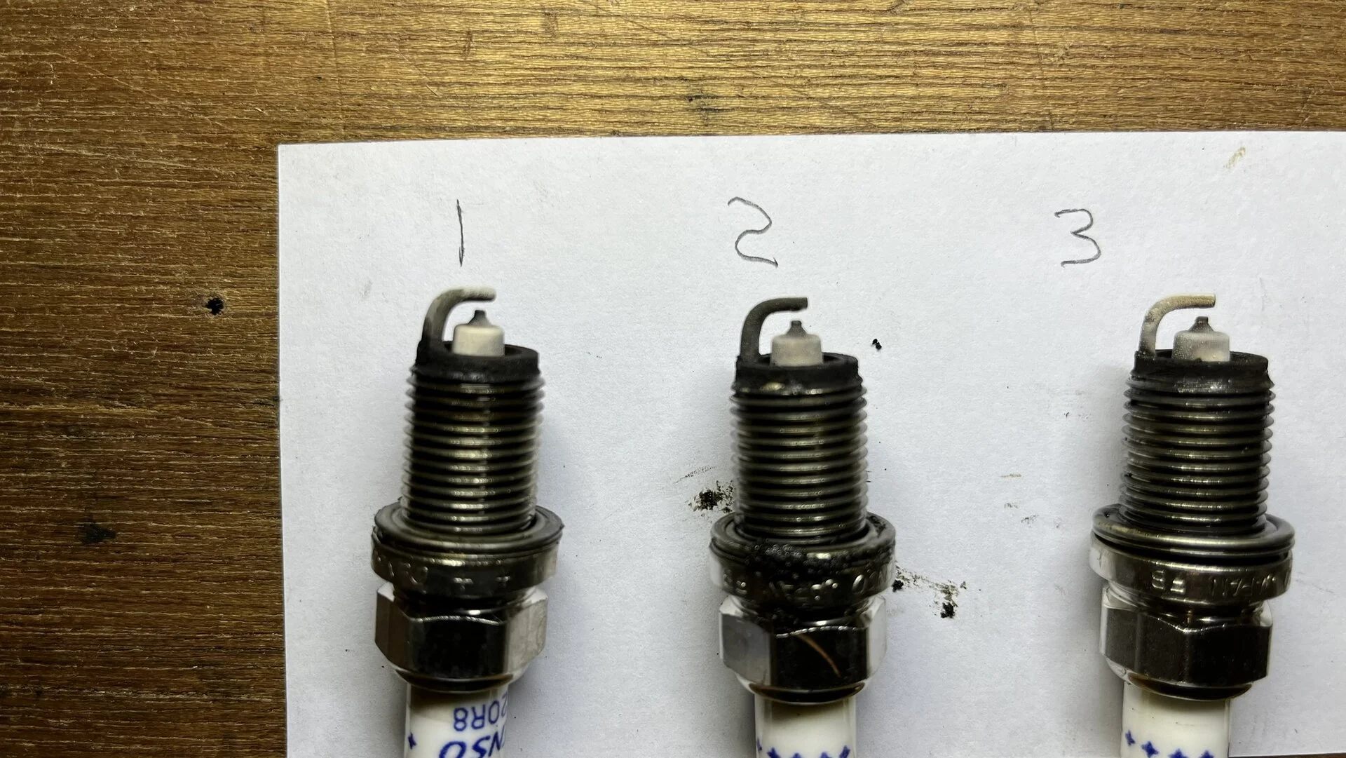

@OutlawMike Thanks for opening a new thread, I know I have questions from time to time. For example, a bit like @Wompom, I currently have my head off and dropped it at the machine shop yesterday. Nothing wrong with the head gasket, but I wanted to replace the valve stem seals and figured I'd just go all the way and pull the head and do the gasket for piece of mind.
My question for the group, and I think this topic came up in one of the other turbo threads - looking at my spark plugs, how do they look to you? Should I replace? Replace with the same ones, or do something different? This is after about 10,000 miles boosted, a total of 190,000 on the motor. They are the plugs that come with the WE kit.
They look great except #2 which obviously has an oil seal leaking.
Yeah, that one definitely had some oil on it. Think I can run them some more?
You could but if the head is off, just spend the $35 to throw in a new set.
