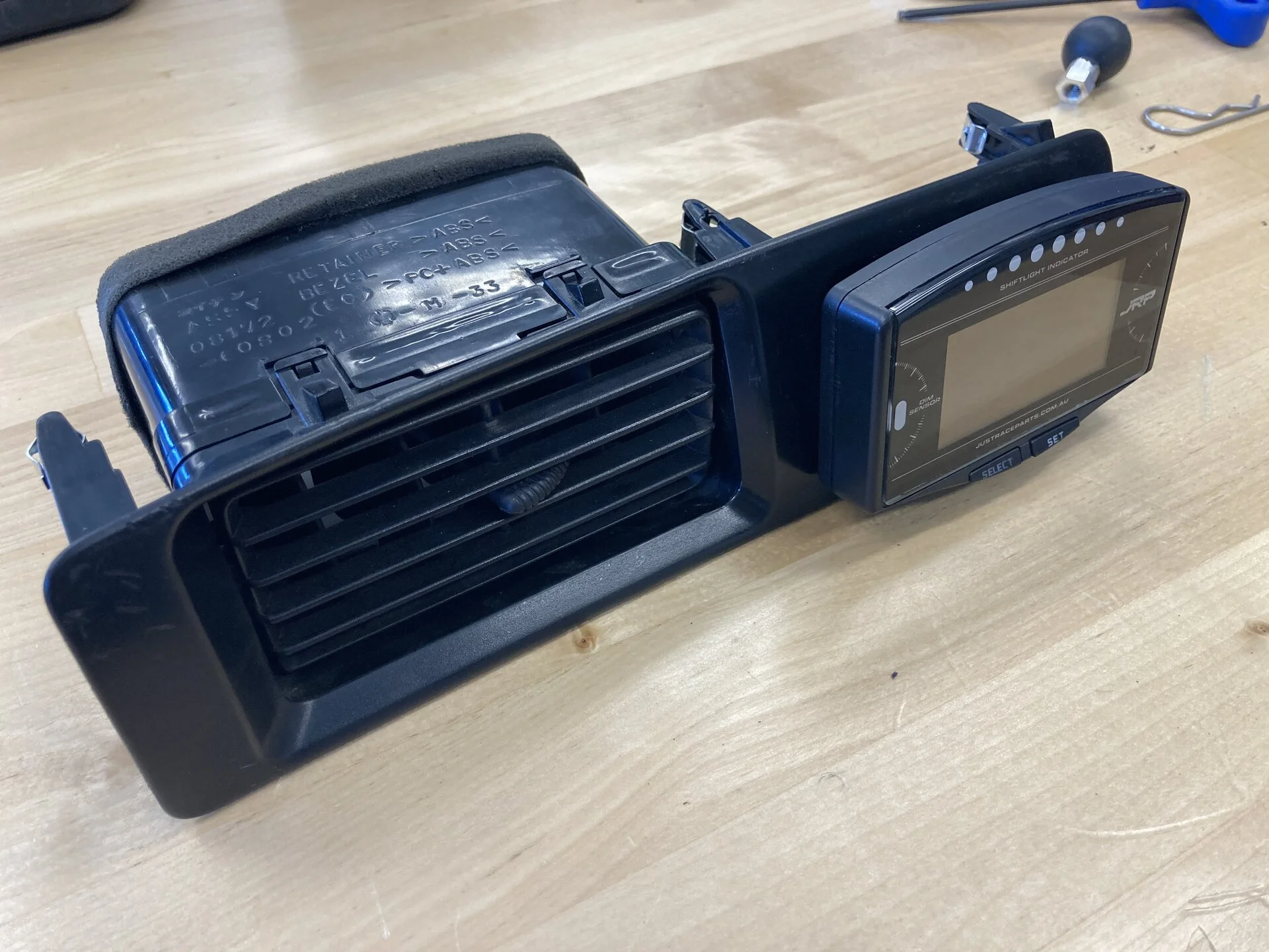

Shmaybe... Let me dig into my files. It was a hybrid effort. At first I tried to use some mounts from Solve Function. Outsane is a vendor on here. Those did not work, so I modified 1/2 of his mount and printed another half. I would need to do some 3D work to get a straight 3D printed "clean" version. I meant to finalize the design, but got pulled off on other stuff once it worked. Solve Function does offer a mount for another gauge, so, maybe he would be interested in offering this to the community and I could be out of the loop.
Ok, no worries. I thought it might be something easy for you, but if it's some work then I wouldn't worry about it. Having SolveFunction do it might be a good idea.
I will put this on my list of many things to do and approach him. I do not want to get into selling things, but he already has a business that sells 3D printed parts, so, it may be a good fit for him.

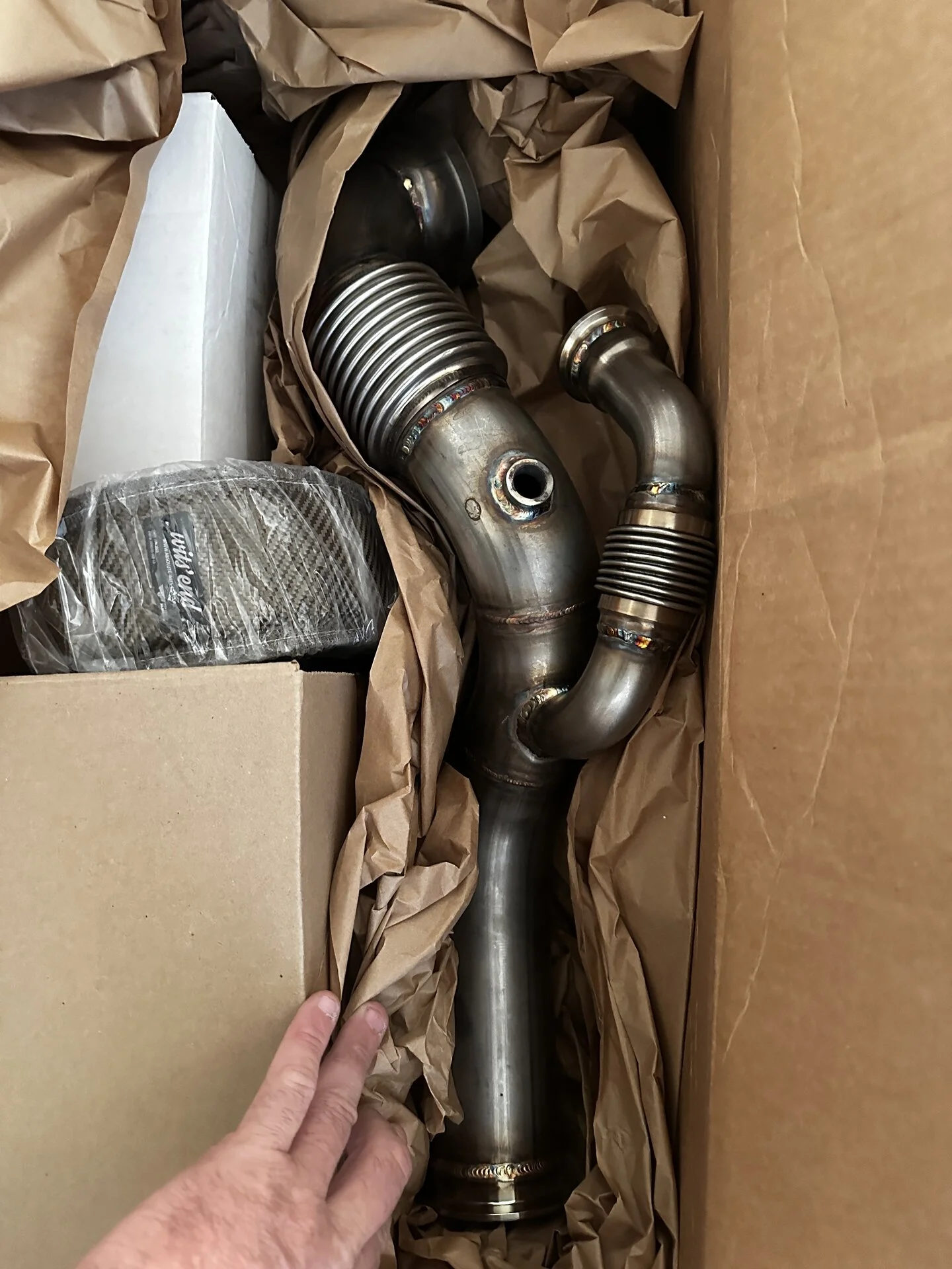

Ok…officially in
Big thanks to @TYM4FUN for the opportunity
And fed ex delivered early

Congrats. You may have the last WE turbo kit to be installed. Not sure if any other kits are on the shelf out there that have not been installed.
A couple of tips:
If you are going to run a wideband gauge in the downpipe, put the sensor in now, when you are doing the install. Adding it after the downpipe is installed and the blanket is wired up is a bit of a pain.
If you plan on running an EGT sensor, the best place to put that is in the inlet of the turbine housing. Drill and tap a 1/8" NPT hole in the turbine housing inlet (take it off the turbo to do that).

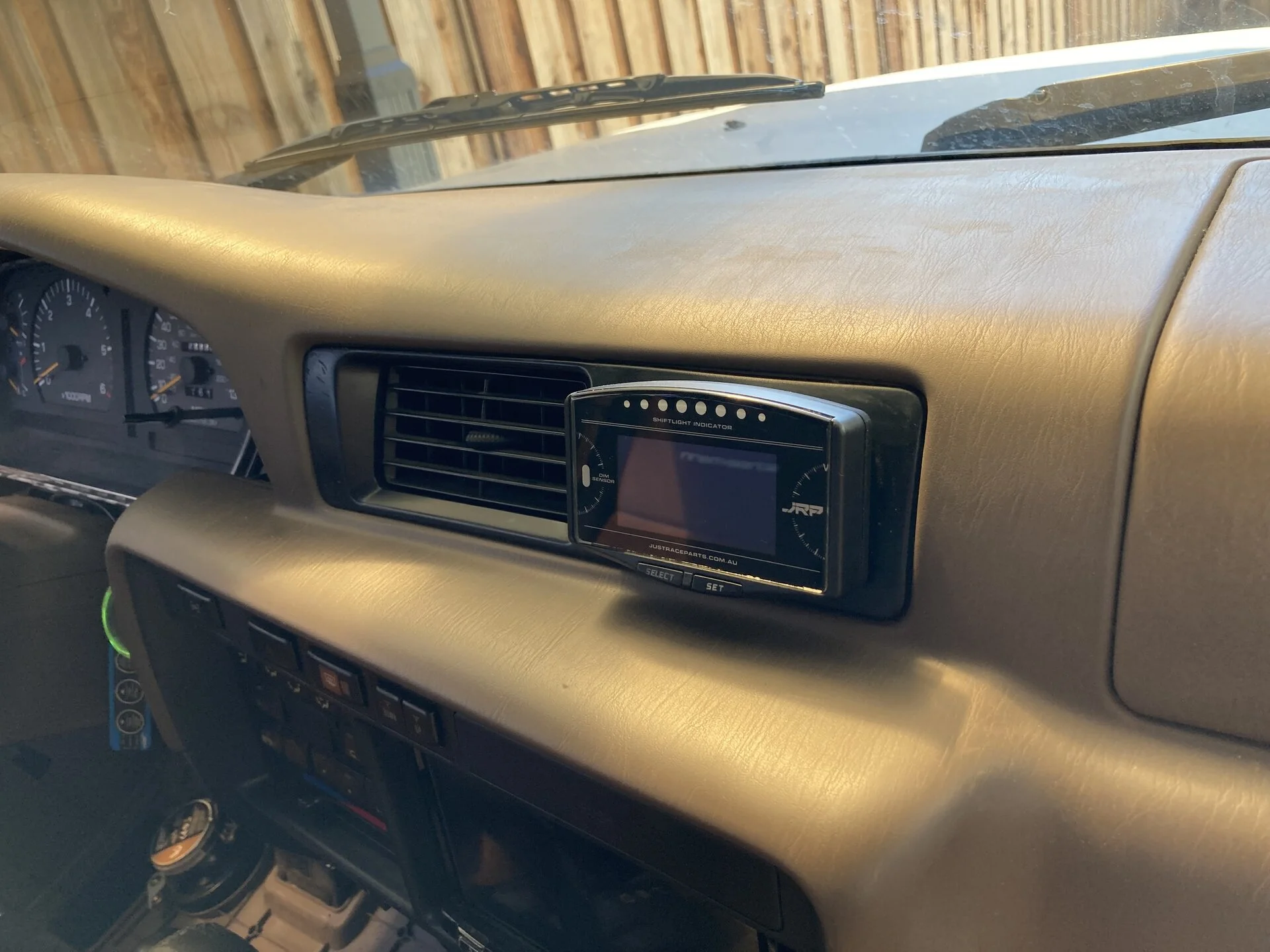

I kind of ended up with what Lutz is selling, but using the 14:1 gauge kit from JRP in Australia. I made a 3D printed mount that sandwiches the opening for the clock and allows me to put the 14:1 display in that spot. JRP just came out with their version 2.5 for the display and the controller. It now supports a trans fluid temp sensor and OBDII support.
That mount is great. Any chance you'd share your STL so I could print one of these up? Where'd you run the controller to?
Nevermind, didn't see your response above.

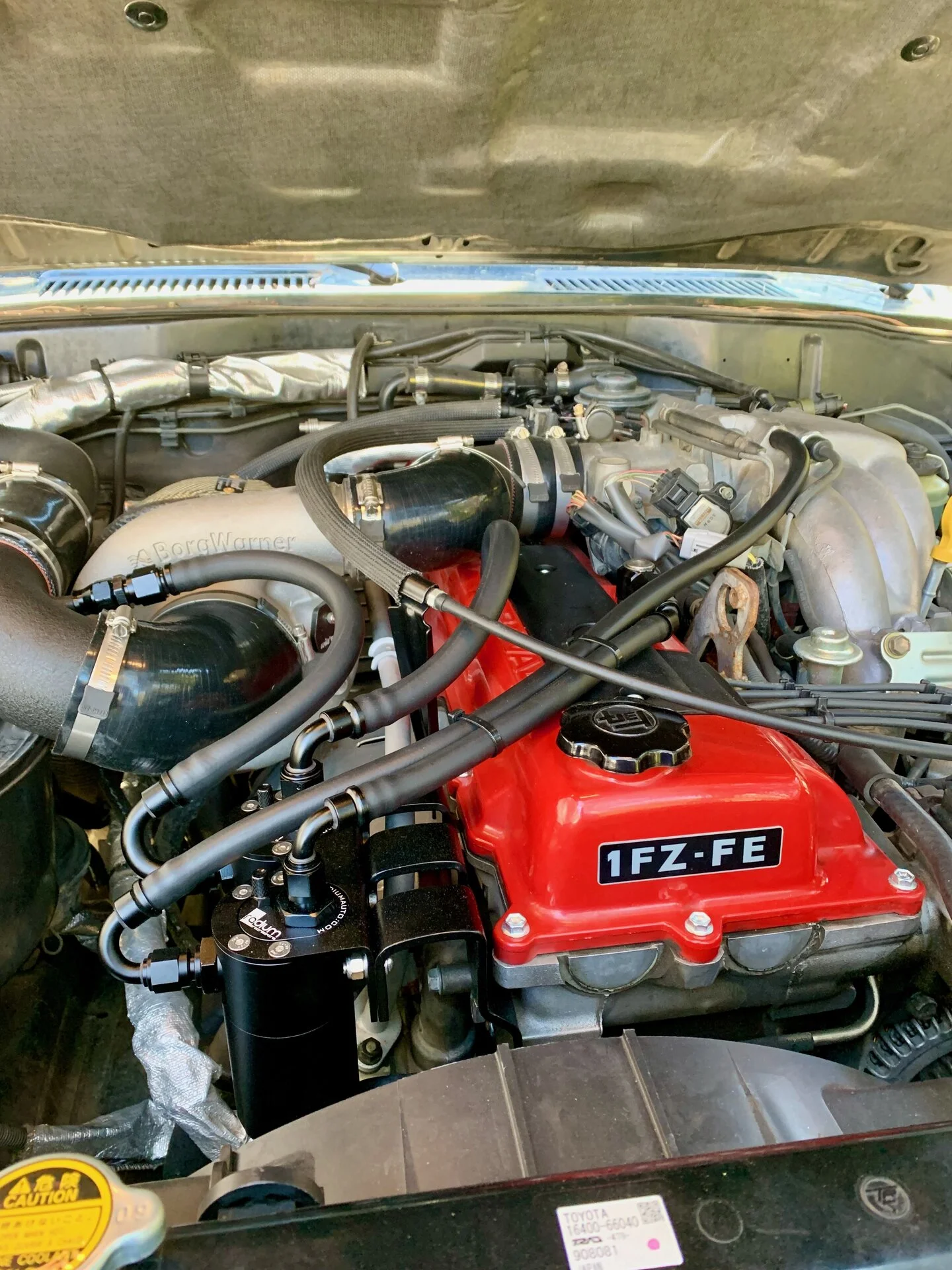

  3. I have the same "compressor oil sweat" that @Wompom has on the bottom of the compressor housing. I thought it was the loose oil supply but persisted after. Nothing leaking from the oil drain either, and I tightened up the compressor housing with no luck as well. I take apart the intake every ~5k miles to check on things and there's always oil in the silicone elbow feeding the compressor. I added a dual catch can kit but I get almost no oil in the can feeding the turbo intake, lots of oil (comparably) in the PCV catch can though, and still the same amount of oil in the intake. I'm starting to think its an oil drain issue backing up oil and pushing it past the bearing but don't really have a way to test that.
