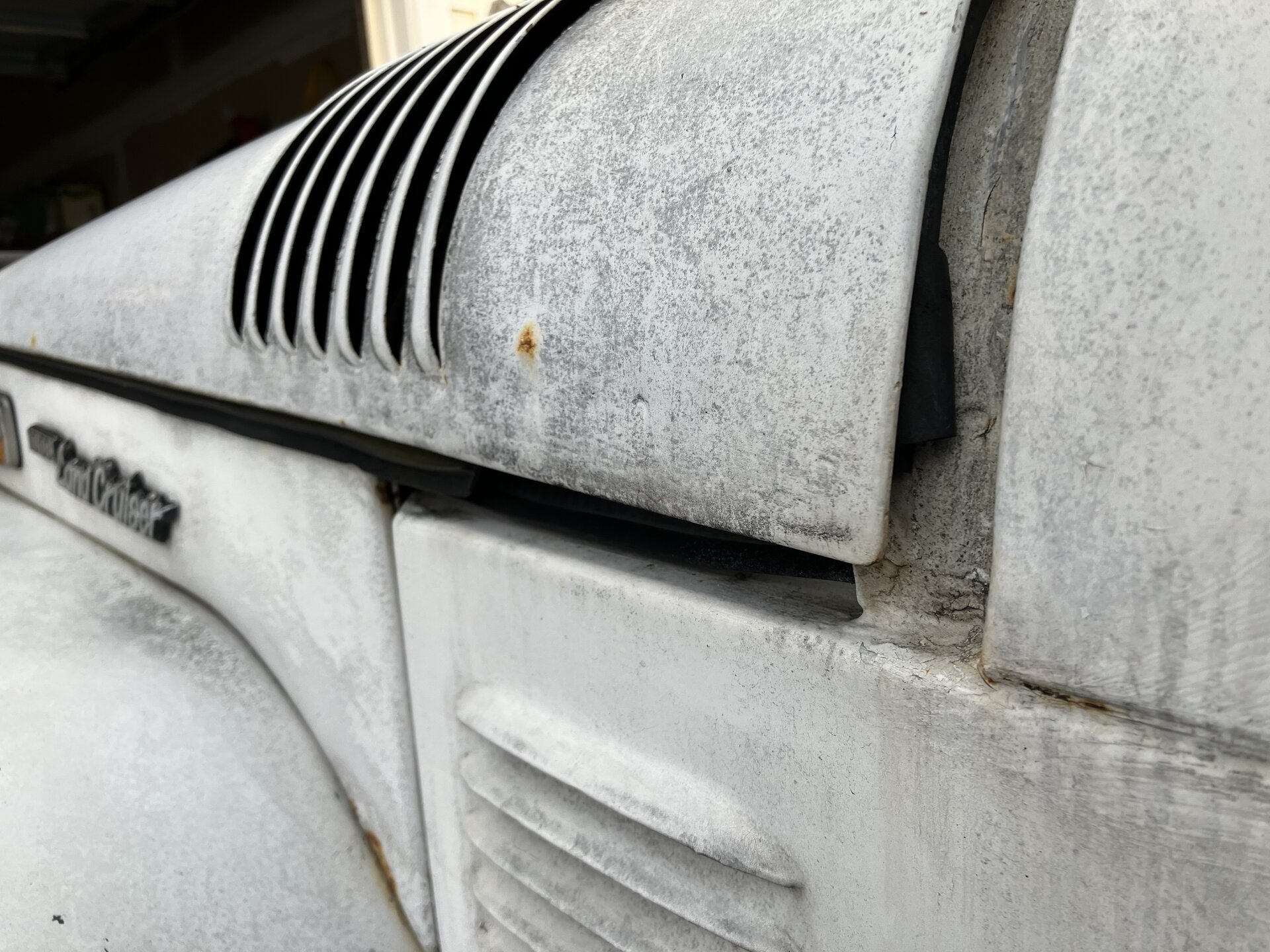

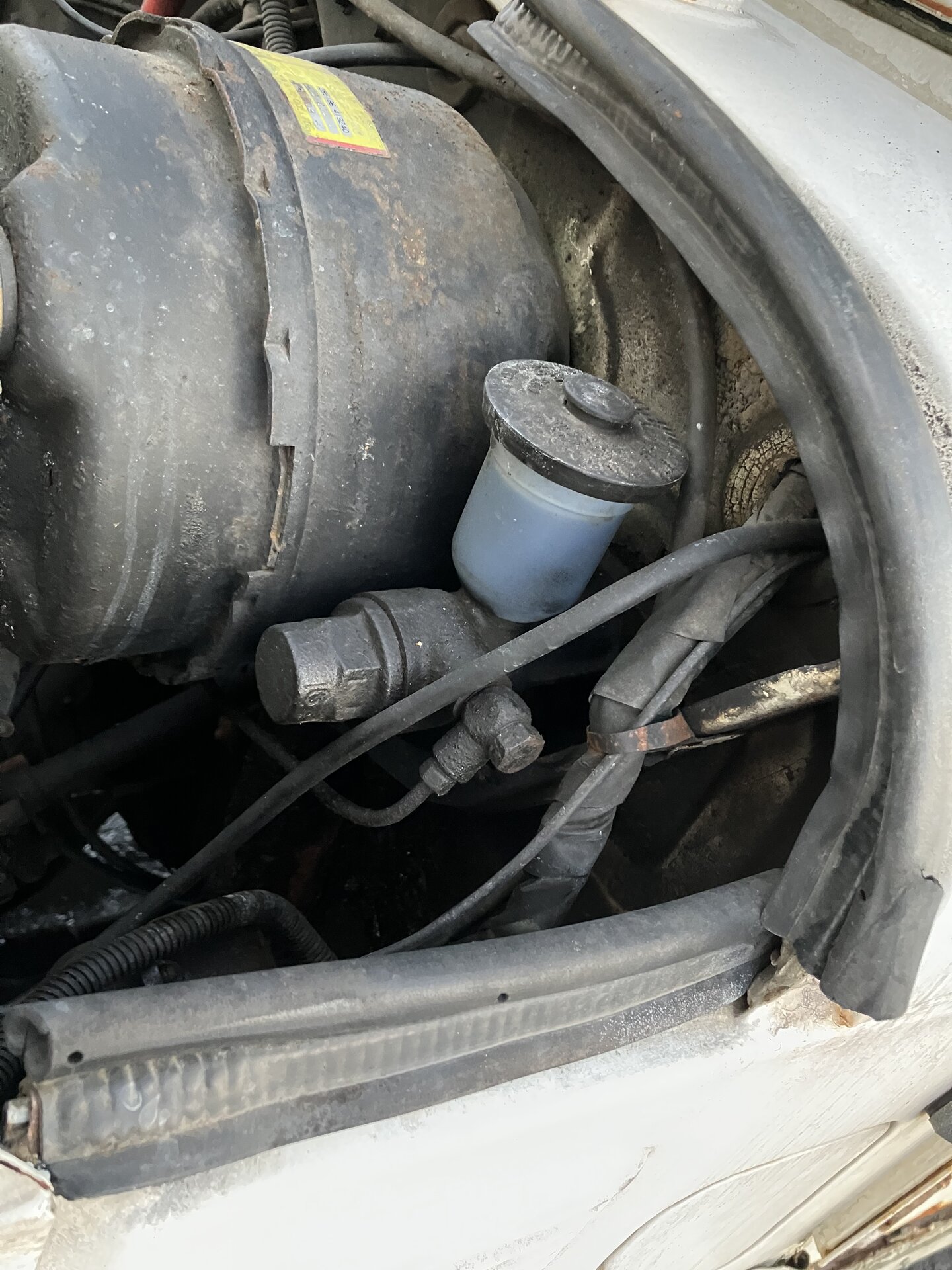

5) fj60 door weatherstripping around hood
6) hood vents blocked off

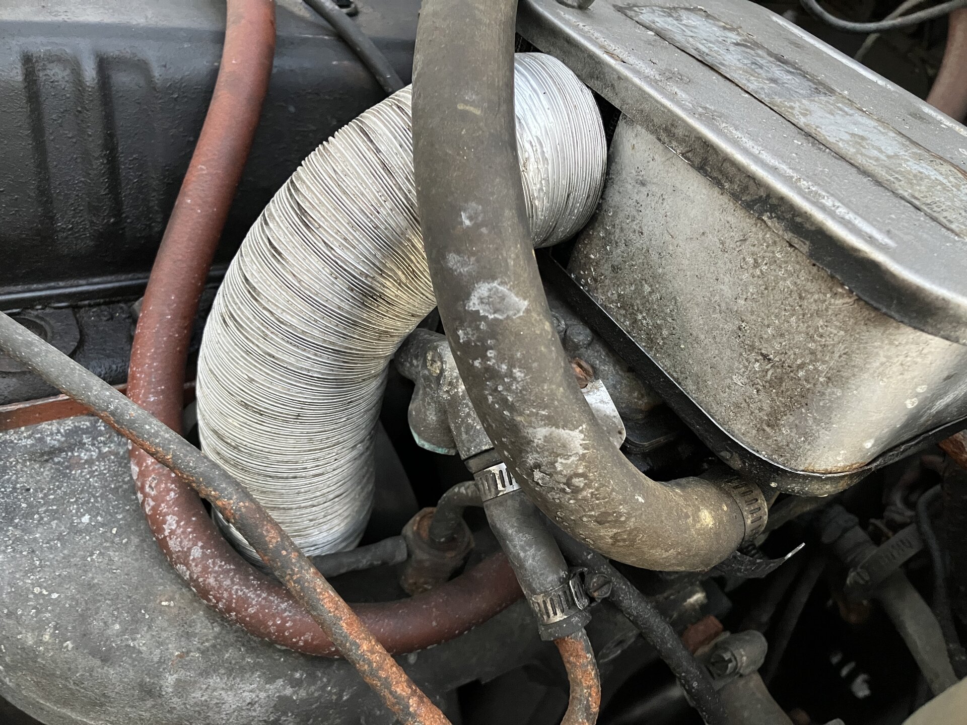

7a) Air heat riser and block off for the weber air cleaner
7b) Fluid heat riser

The firewall I sealed off a few years ago.

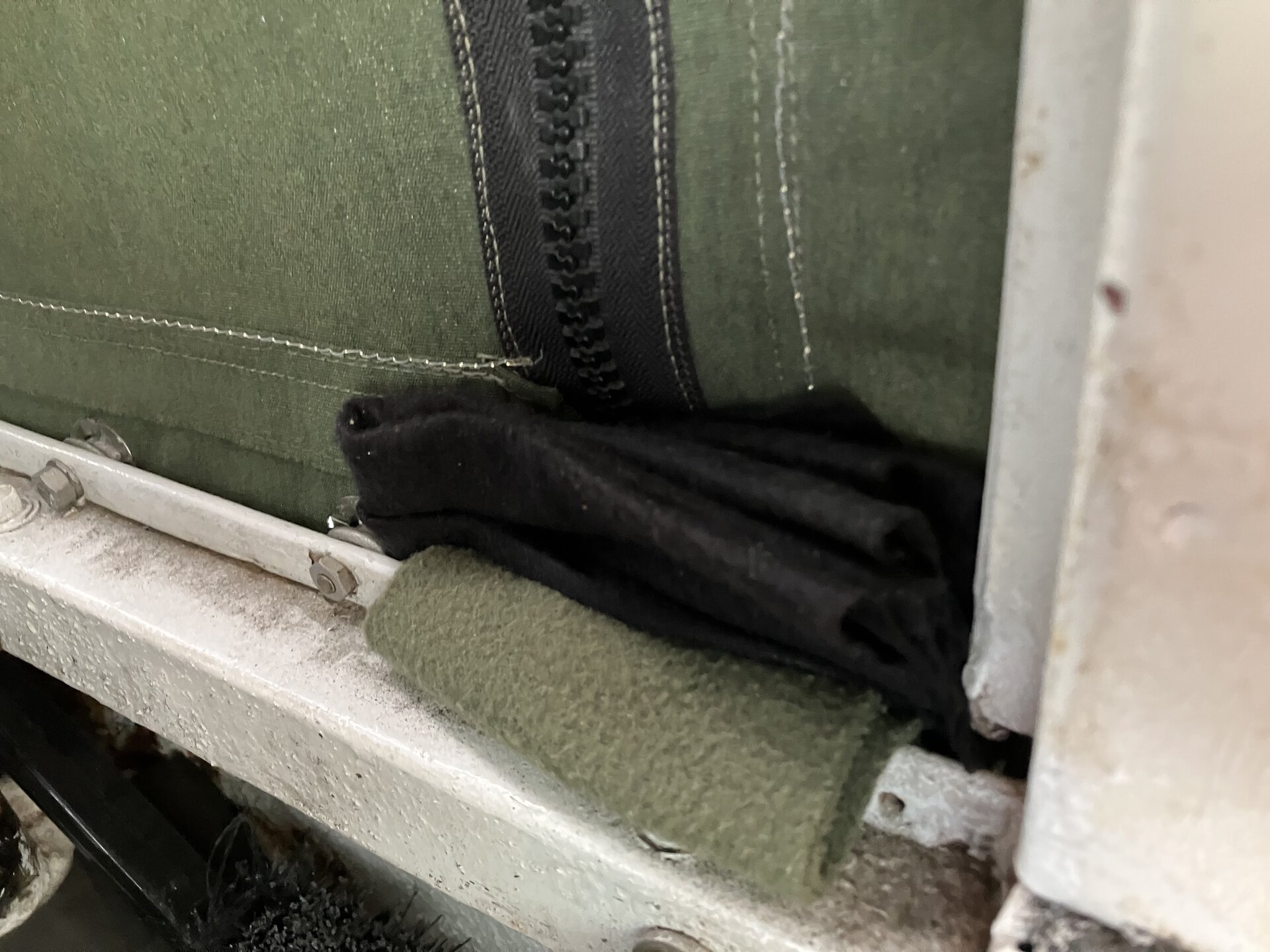

I've been kicking around the idea of building a floor mat insulation system of sorts to help insulate the cab. Something removable.
