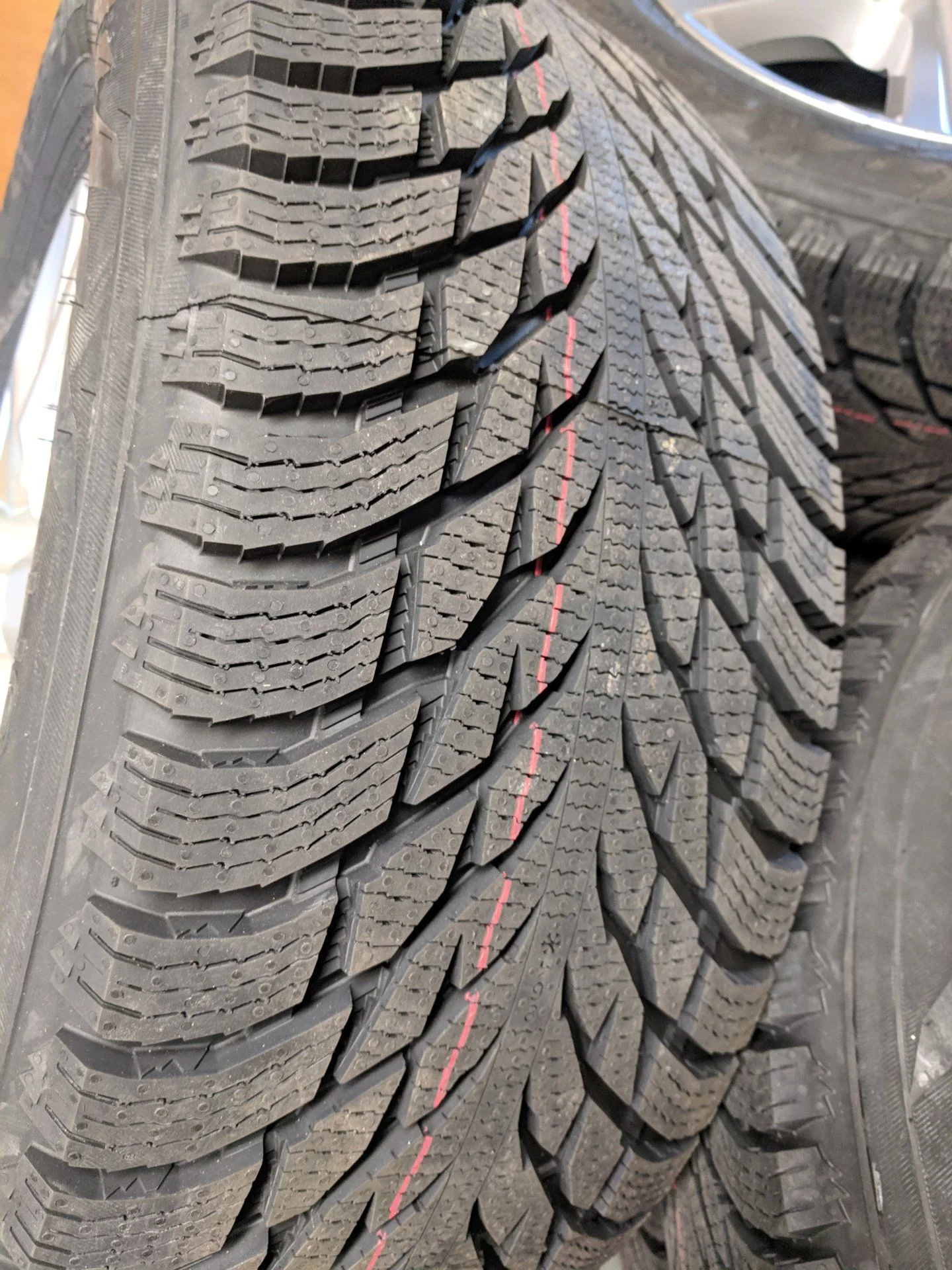

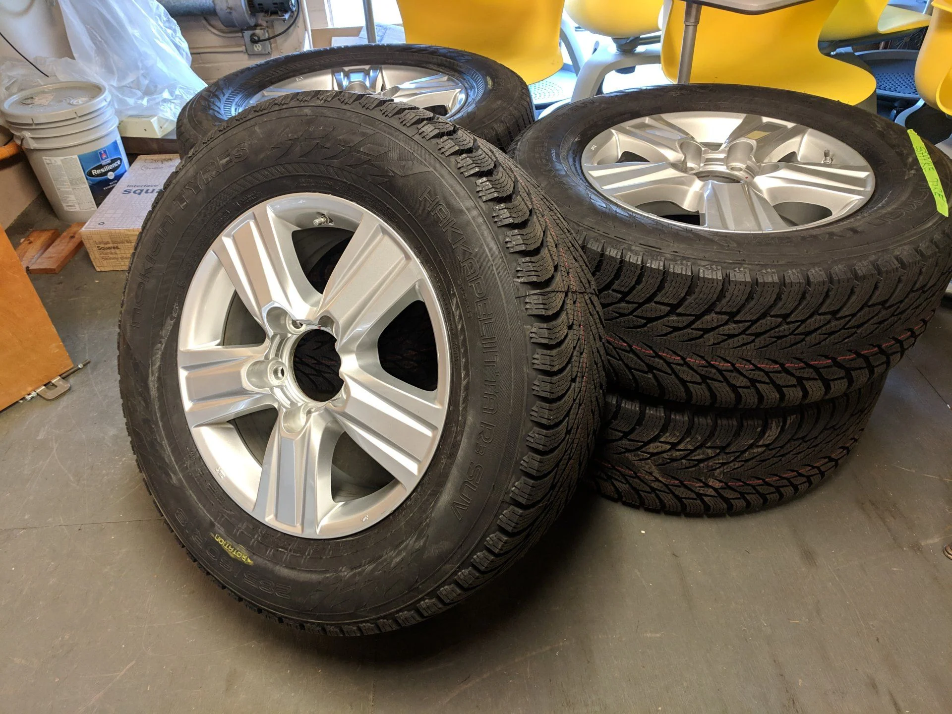

I'm stuck and could use some opinions/advice. With how good this winter is already looking (compared to the last 3 "winters") I've decided to do something other than my standard Ridge Grapplers for this winter. While I've grown up in CO and never owned actual "winter tires" and have driven from CO to AK to NWT to YT in the winter successfully on AT & MT tires I am at the point in life where why push it rather than just get the right tool for the right job. I live near Vail, CO so we get a fair amount of snow but not necessarily a ton of ice. Which is why I'm stuck. I have big concerns with the Nokians and Blizzaks being way too moderate of a tire tread for deep powdery snow (think offroad, unplowed roads, backroads, winter campsites in Montana, Alberta etc) while there is no question they will be bomber on the slick plowed ice/snow layer on I70 going through town etc. Duratrac and Cooper ST Maxx are both studdable tires with a still decently aggressive tread and seems like a good compromise. I just got back from Svalbard where the roads are solidly packed ice/snow for 5-6 months a year. Were I to be living there, or in Alaska or north east coast with tons of ice and constant packed roads I would worry less about aggressive tread for deep snow. My choice has basically come down to the Nokian Hakkapelite LT2 in a 285/70R17 or Cooper ST Maxx (Studded) in a 285/75R17 with me leaning towards the cooper. Will I be sacrificing too much in all the worlds by going with the Cooper with the more agressive tread over a 100% dedicated snow tire that will probably gunk up and be stuck in thick powdery snow? Thanks
Back in the "olden days", a "snow tire" needed an aggressive, deep tread to do its job. I've been REALLY impressed with modern winter tire technology and the ability of tires to stick to deep snow as well as slick snow and ice. I run them on all my cars here in Michigan, but not my LC because I don't use it much in the winter. As you do your tire research, keep in mind that a good winter tire doesn't necessarily need to look aggressive to be aggressive in snow. The Michelin X-Ice on my cars grip even the deep stuff with all those little sipes. The tire construction and materials release the snow and don't get clogged up.
Very nice choice. Very!!!

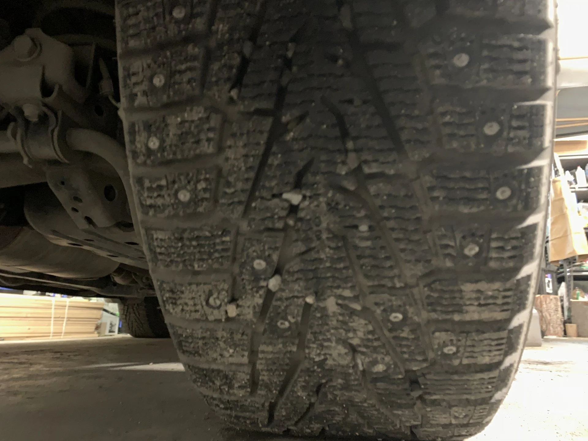

Still trying to decide on which tires to get for the 200. It's down to R3 vs Hakka 9. I have Hakka 8 on the Tacoma, like them a lot, but maybe they are overkill. Noise is there, not too bad I was also thinking abotut LT2 in 275/75/18, but LT2 apparently readily lose studs.
Then there are also new Bliizak LTs in that size, but there are zero reviews of them.
Hakka 9s are great on the LX. Minimal road noise at 80mph. Certainly nothing that prevents you from having a conversation at normal voice levels.
I just put my R3 SUV's on this past weekend at the dealer, now looking for some snow to put them to good use :)
Not a huge problem in Tacoma either, but that's a loud truck compared to the LC (mine even louder with TRD exhaust).
I am leaning towards Hakka 9s, for sure.

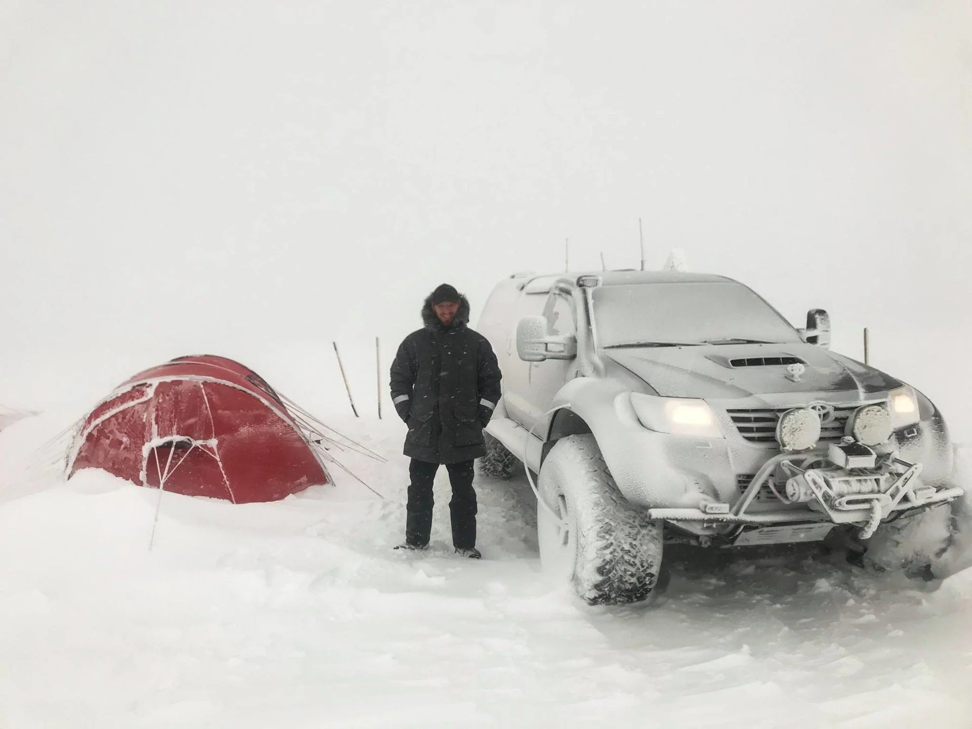

I've got an ARB compressor (and rear locker) in my 200. Makes it easy for airing up/down. Exactly my buddy made a point of I need to look at how often im driving to ski or on mountain passes in the winter versus the very rare times I would be legitimately offroad in the winter and buy the tire for the 99% like you said. Funny, I had an arctic truck for a bit last month and got to do some solid glacier time with it. Great trucks and definitely purpose built. Not what I'm trying to do with the 200 lol. (Did used to have a 2dr JK on 40's with beadlocks that when aired down did bout damn near the same thing out in the mountains in the winter)
That looks like an amazing experience! I'm definitely jealous!
