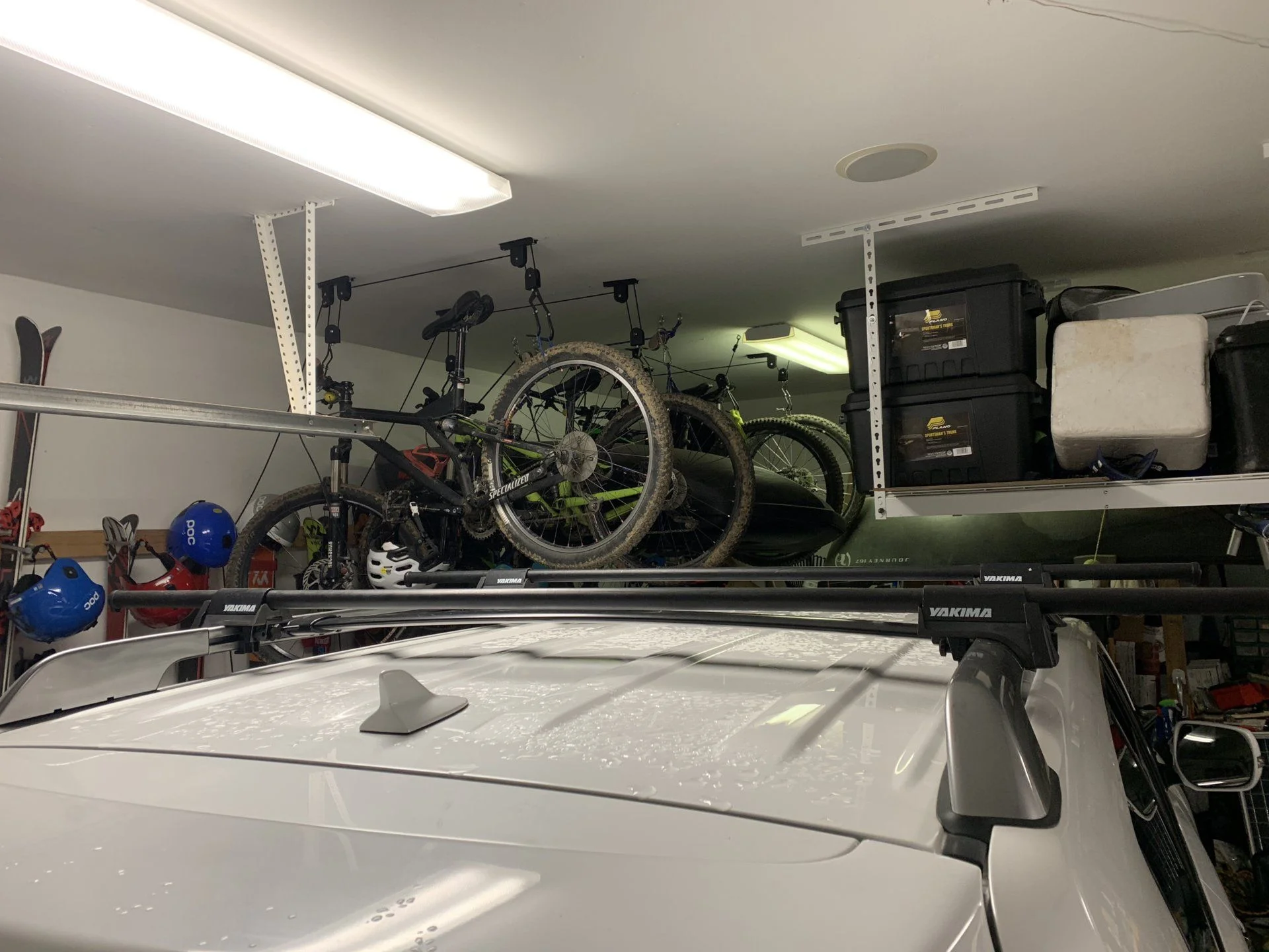

As for me I’ve had my Hakka 7 on my LX for about a week. Put my roof rack (yakama rail mount) back on yesterday and it makes much more noise (even without skis on) than my studded tires.

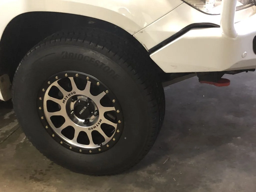

Went with the LT275/70R-18 BRIDGESTONE BLIZZAK LT E on Method wheels- The E loading rating sold me. The Blizzak LT are new model tire released summer `18. Due to the Method offset I experienced a little rubbing on the passages side mud flap so I removed it. Very happy with their performance- this weekend made a trip further west and back east over Vail pass which had pretty significant Snow and Ice patches along 70. I notice a significant improvement in braking distance over my KO2's and a lot quieter on dry pavement. The side walls are softer on the Blizzak than the KO2s so I stiffend up the Kings with a couple clicks and it made a marketable difference. I broke down and bought the AUTEL MAXITPMS TS508 TPMS TOOL it work like a charm syncing the TPMSs with the 200. Regarding the chains no chains debate- I have had success using auto socks on all four shoes, there was no clearance issues and offered significant snow and ice traction improvement.

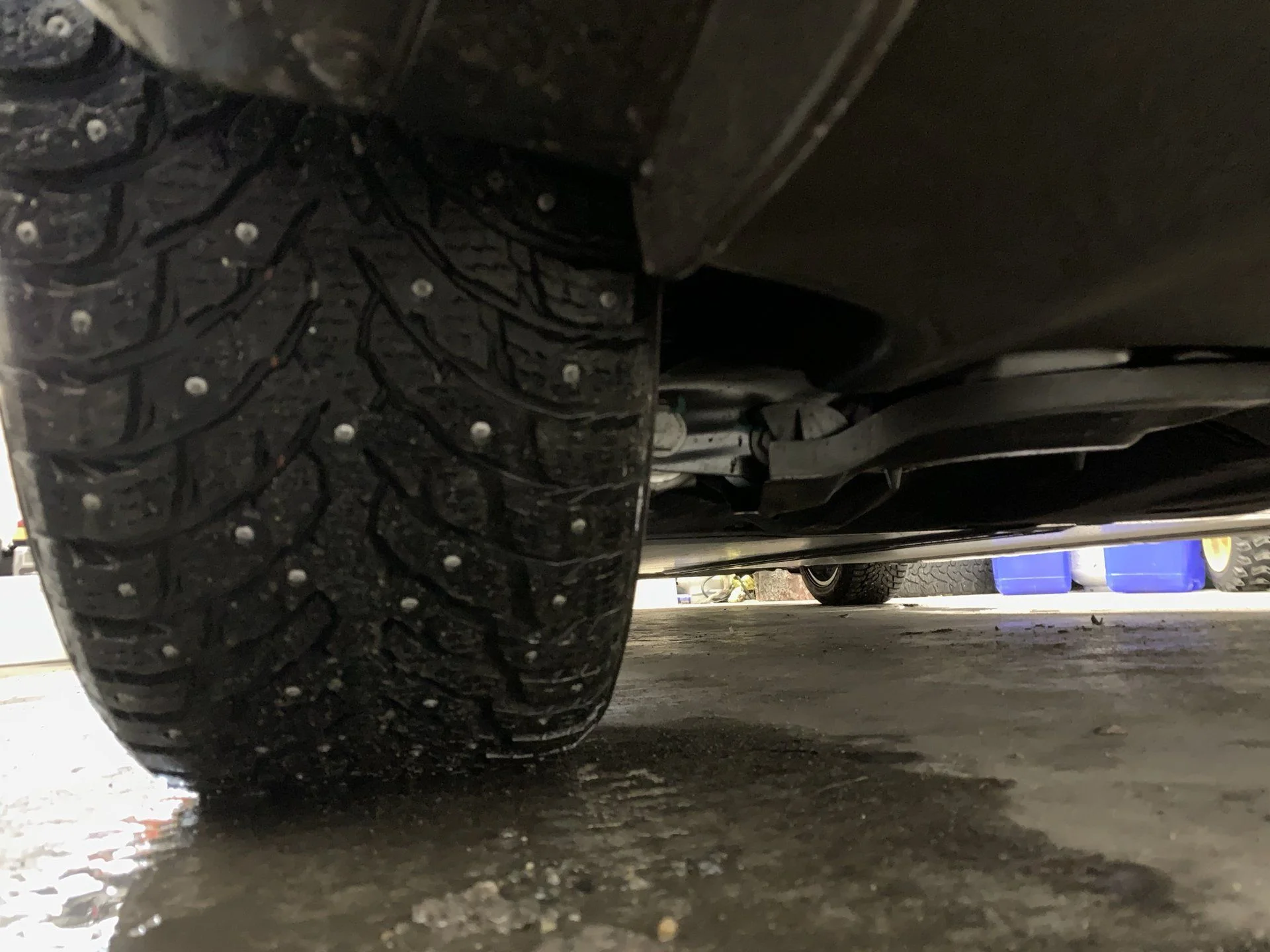

So first off parts of Alaska get way more snow than any part of Colorado. We get more packed snow and ice on the roads because salt is outlawed and it stays cold here. In 2011 we broke 1400 inches in Girdwood and Thompson pass out of Valdez breaks 100 ft most winters. That year 2011 (>100 ft year) I did great with Hakka 7’s which is a similar tread pattern to the Hakka LT2. Attached is a picture of the tree of my Hakka 7’s on my LX and Hakka 9’s on my wife’s Tesla. I think the 9 may have more aggressive tread.
