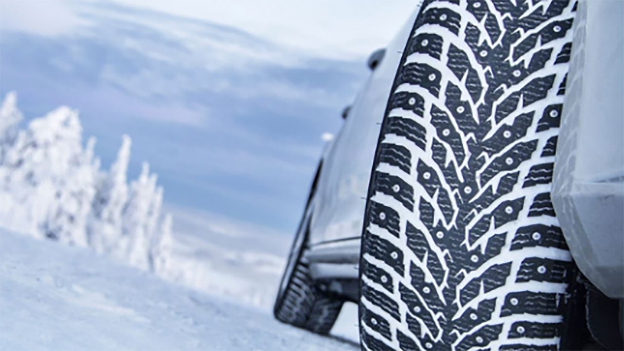

Yet tests show they outperform studded tires. Studs only provide a very small advantage on clear ice between zero and 32 degrees. They cannot help in snow, compromise grip in slushy, wet, or dry conditions, and if you drive with them at all on bare pavement, you wear the studs down to the point of ineffectiveness in 1,000 miles or less.
Studs are only designed for drivers who never encounter bare pavement. And even for that very small group, the latest studless tires offer a broader spread of capabilities.

Top level studded tires like the Hakka 9 combines everything you mentioned with studs.
I have a Tesla model 3 on Hakka 9, a buddy has the same model 3 on Hakka R3. My hakka 9’s had ~7k miles on them on their 2nd winter, his R3 were on their first winter and <1k miles. We drove them back to back and did a back yard parking lot winter auto cross last winter, mixed winter surface, Mostly ice and packed snow, some gravel on top. Both of us agreed that the Hakka 9 is better on Alaska winter roads, both he and I drove my car faster on our auto cross and had a shorter stopping distance from 30mph. Again totally observational But it was fun.
