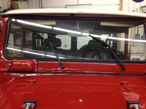

Have a 78 FJ40 and the windshield wipers work fine but when you turn them off they return to this position is there an adjustment for this?

Which direction do they go in when you turn them back on? Do they go to the bottom of the windshield?

When you turn them off, no matter where they are, they return to the bottom and then go up to this position. I have been told it may be a ground which makes sense since there is a fresh repaint not to long ago.
If there was a ground problem on the wiring, it wouldn't come on at all. I would pull both blade arms off and turn the wiper on, then off and let the motor return to the park position. Then put the blade arms back on where they need to be in the lower position and see if, when they come on, they make a full sweep, then return to the parked position. There is a printed circuit in the motor housing that the contacts run against that provides the ground for the wiper circuit. Where there is a gap in the circuit board is where the park position exists.
****! Do not do this!
They will drive down into the nice paint, just like I said. The position of the arms on the posts have nothing to do with the extremes of the travel of the posts themselves.
If you're playing with the travel and position of the arms on the posts use some masking tape, not the wiper arms. Only put on the wiper arms once you're sure about the extremes of the travel of the posts.
Eddy, You are wrong about this. If the motor is in the park position, the arms won't go any LOWER than they are when you attach them. You always mount the arms at the lowest position when the motor is parked. What are you thinking?
True if the park position is working correctly. According to the description they're parking in the middle of the windshield, otherwise, working correctly, so they are rotating 45 degrees or so in either direction. They are parking in the middle of their travel, incorrectly. The motor/controller has no idea where you put the arms. They are not keyed, but splined. If you rotate the arms the motor is going to try to drive them down 45 degrees, right off the windshield and down into the cowl, bending the arms and scratching the crap out of the paint.
It is likely a build-up of old gunky grease on the wipers internal to the motor/control circuit.
You are assuming that the arms were originally installed properly and it just quit sweeping the full range. I guess we should ask the OP if the wiper arms EVER ran the full arc, or did someone simply mount the arms in the wrong place when he got the 40. He says the wipers work fine they are just parking in the wrong spot. If they run fine, then it is not a dead spot in the metallic trace on the board.

Who said there was? I'm not sure what's in there. I don't think it's a board, like in a chevy. In the older above-windshield ones it was brushes contacting the central post. There is a contactor arm that would often break and get wedged down inside the mechanism. Likely something like that going on here.

I am not familiar with the later model motors, but on an early model, this behavior would be due to a faulty stop switch on the wiper motor - Coolerman and IDave (much longer ago) offered good explanations for how the stop switch works - no idea how it looks in the later motors

When you do as suggested, the wipers come half way up and then dive below the glass onto the cowl and stop cold since they cannot make a full sweep.
Sorry to say Eddy has predicted the exact behavior. They DO dive down into the cowl and stop. That is what was happening when I got the Cruiser. Fortunately, no scratches to speak of. When (If) I figure it out, I will let ya'll know what the culprit was.
Yes. The plate has come loose and rotated. I'll see if I can spot the link?
Remove cover, rotate tignten, replace cover.
