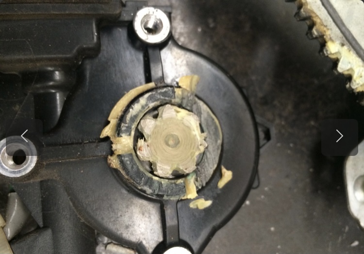

That's the grease in the motors working against you. FWIW, I replaced both the motors and runs in the front windows of one of my '95s; works like new now.
Cool, I’ll try cleaning up the motors and replace the grease and replacing the window runs. Hopefully that will improve the speed before replacing the motors.

I was looking for the grease that’s inside the motors. Usually on the plastic gear.

The window lift motors get weak with age, then add wear/slop of the plastic worm gear, then old dry lube, hardened rubber runs, poor grounds, ---, and the glass moves slow.
I once took an original window lift motor completely apart, cleaned out the old grease, put in new thin grease (Molykote 33 Light), cleaned the armature, slapped it all back together, and it still wasn't strong enough to raise the window glass. A new motor worked perfectly.
IMHO the ultimate fix is to replace the 25 year old motor while cleaning/greasing the regulator and checking for proper function, checking/cleaning grounds, new rubber glass runs, etc, etc.
