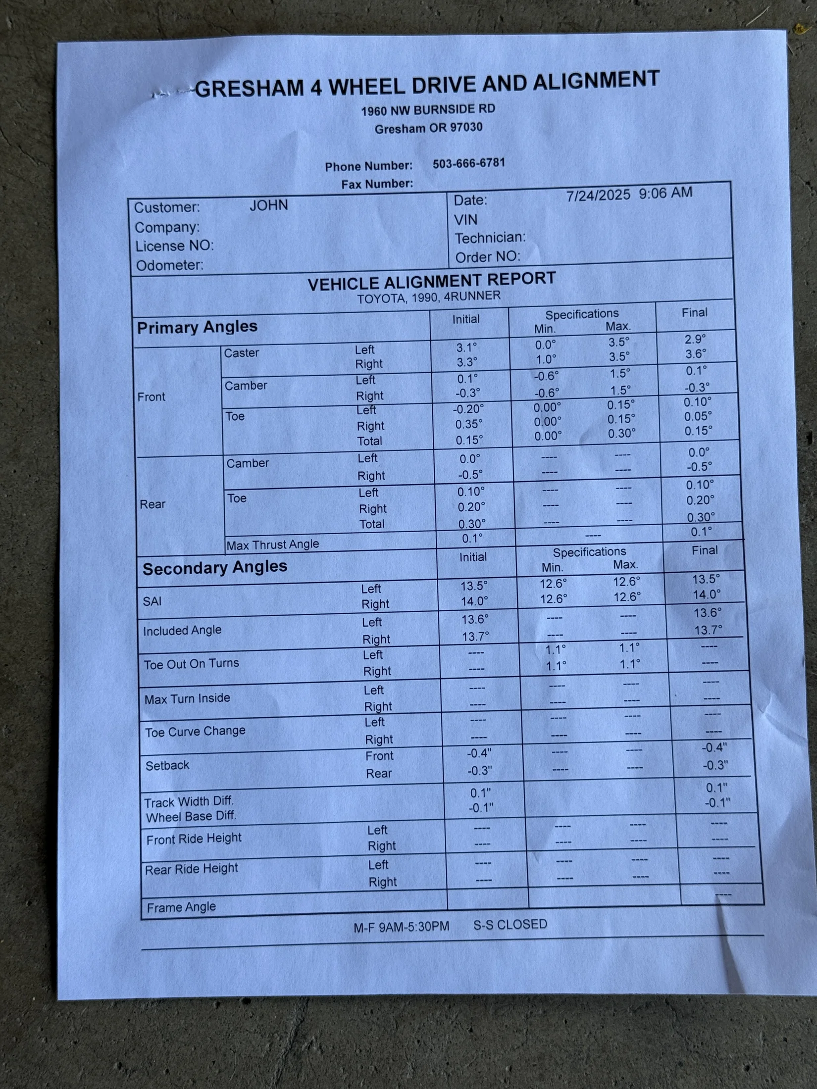

You said your caster was a bit low - maybe try adding some additional caster with brackets or eccentric bushings?
My latest 80 was all over the road till I tightened up the steering box. Do you have much slop in the steering wheel turning left to right? You should only have to back off the adjustment screw about 1/2 turn after bottoming it out.
I ended up swapping to Delta 5L and it got me to +3 castor from 0 (with 3L)... So still not perfect but drives better. I think 2 more degrees would feel better. but i cant afford to keep swapping arms lol.

I'm looking for the alignment shop printout!!!
so your caster is decent, not superb but doable. With all that you've done so far, are you still having tracking issues?
