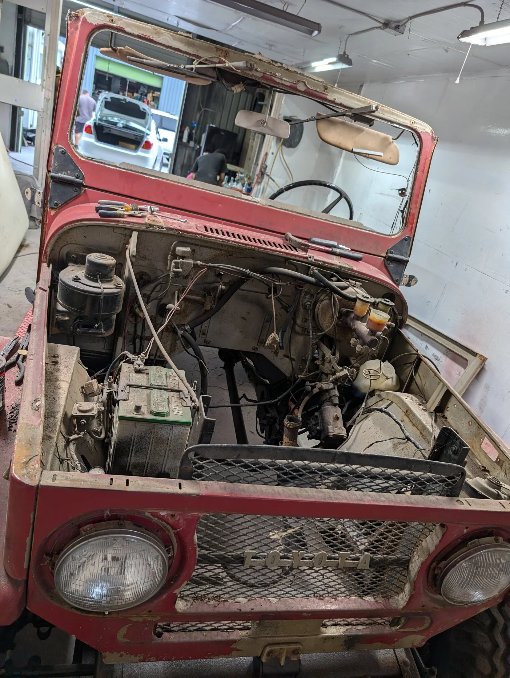

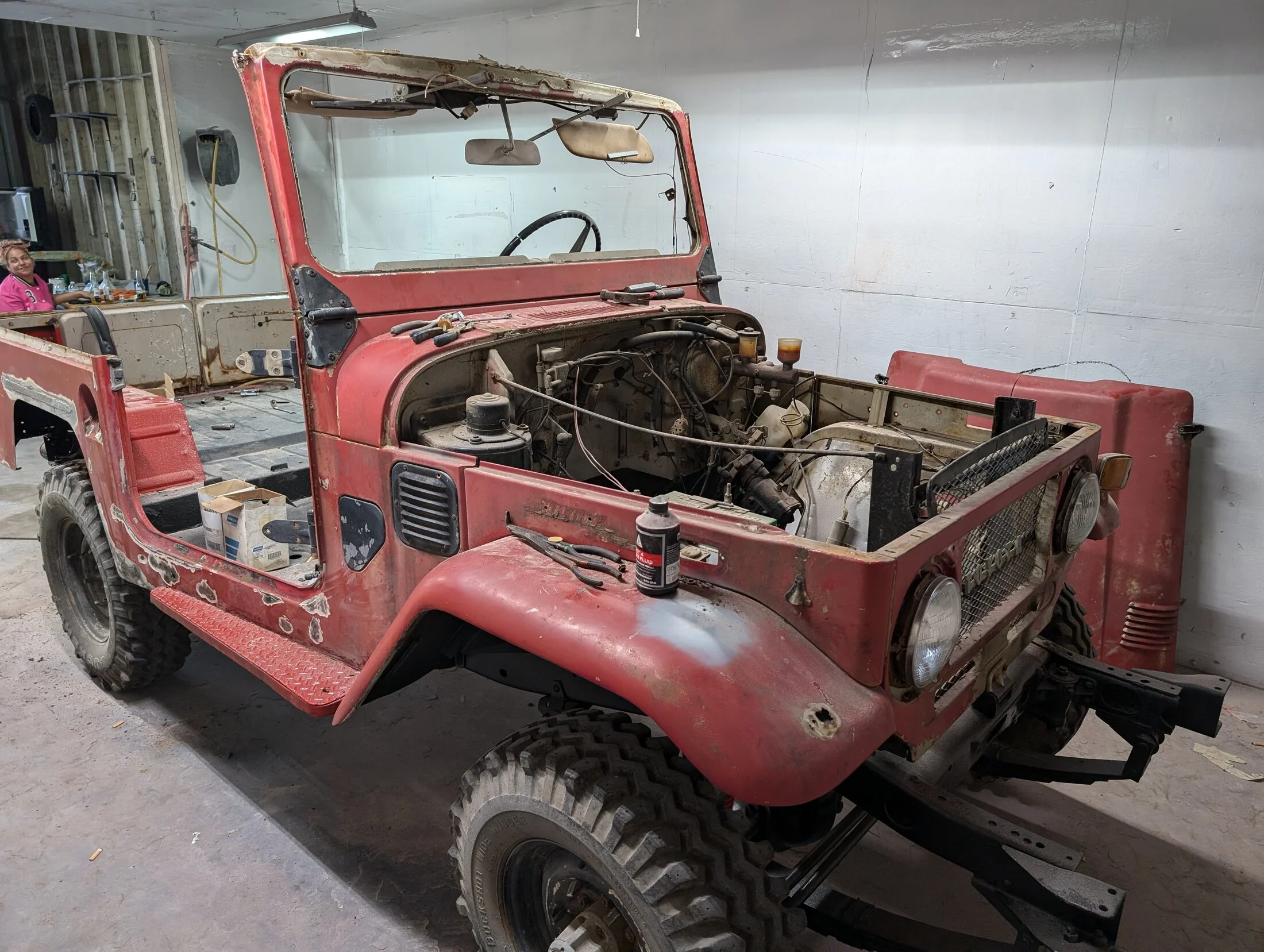

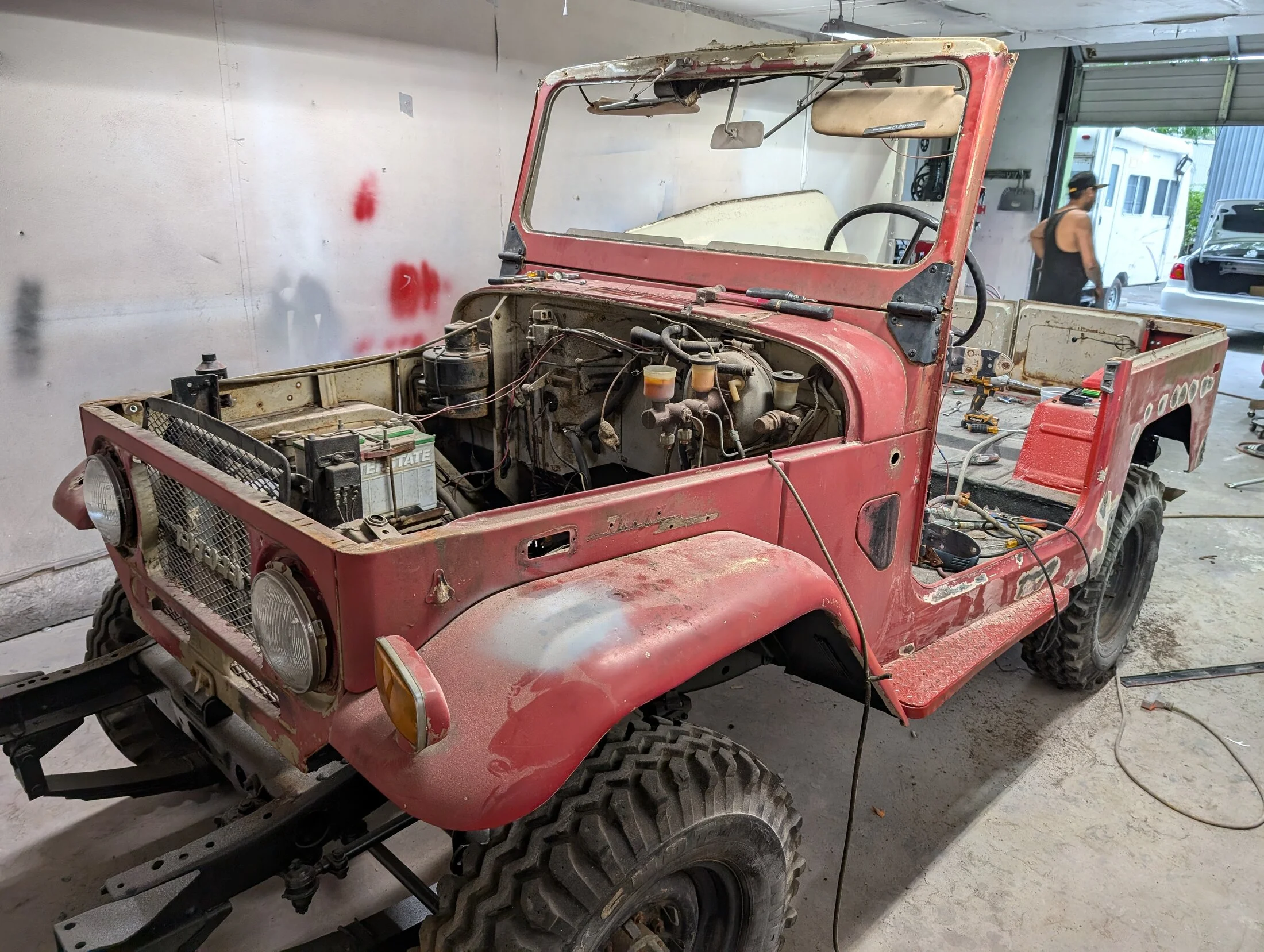

Let's see some photos and all learn something :)
OK, here are the photos you asked for, definitely no fan shroud and definitely no air cleaner:
needs a brake fluid reservoir cap too.
