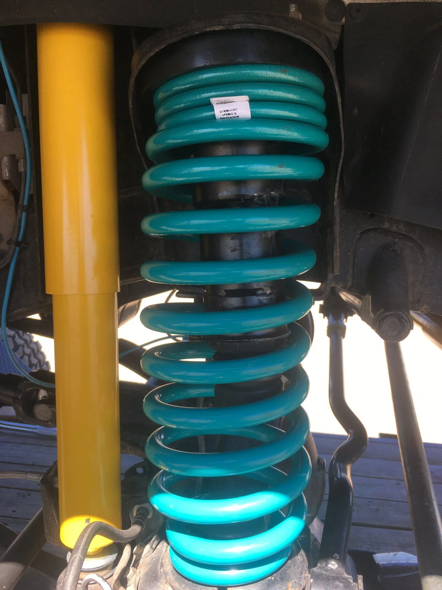

I have run OME 850j, OME 5"comps, Slee 4", Dobinson 4" "flexi" progressive and now the Dobinson 3" tapered coil, which is just like the famed "slinky" coils. The tapered offerings are the newest choice on the market.
I use a 1" spacer on top of the 3" tapered coil to get 4" lift in front. Front shocks are Dobinson's inexpensive, yellow shocks that are in the same price range as OME but they ride much smoother,softer and paired with the tapered coils the front end rides nicely.

The new hot deal is supposedly the Dobbinson VT series variable rate coils in 2.5” and 3.5” versions. If your rig is heavy Slee 4” is a high quality choice. They offer a heavy duty rear 4” spring that they call progressive because the top three coils are wrapped close together.
A few years now I’ve run a mix with the original Dobbinson 3.5” variable rate springs up front with a 1” spacer on top and the slee heavy progressive springs in the rear.

This is my new setup. A lot of equipment, but the ride is great on and off road.
Dobinsons vt springs
fox 2.0 shocks
Delta radius arms
Delta bump stop extensions
Delta sway bar drops
Delta rear panhard bracket
Dobinsons adjustable front panhard
Dobinsons adjustable rear upper control arms
Dobinsons adjustable rear lower control arms
Dobinsons lbpv bracket
+all new bushings and end links
