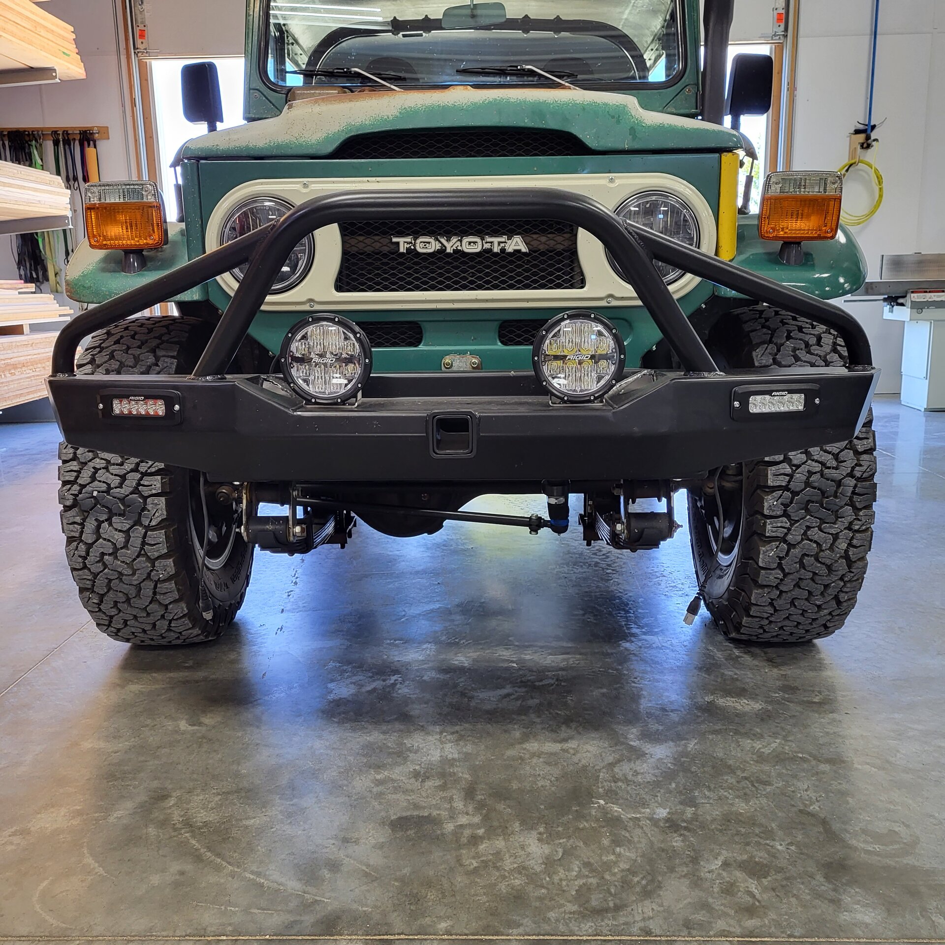

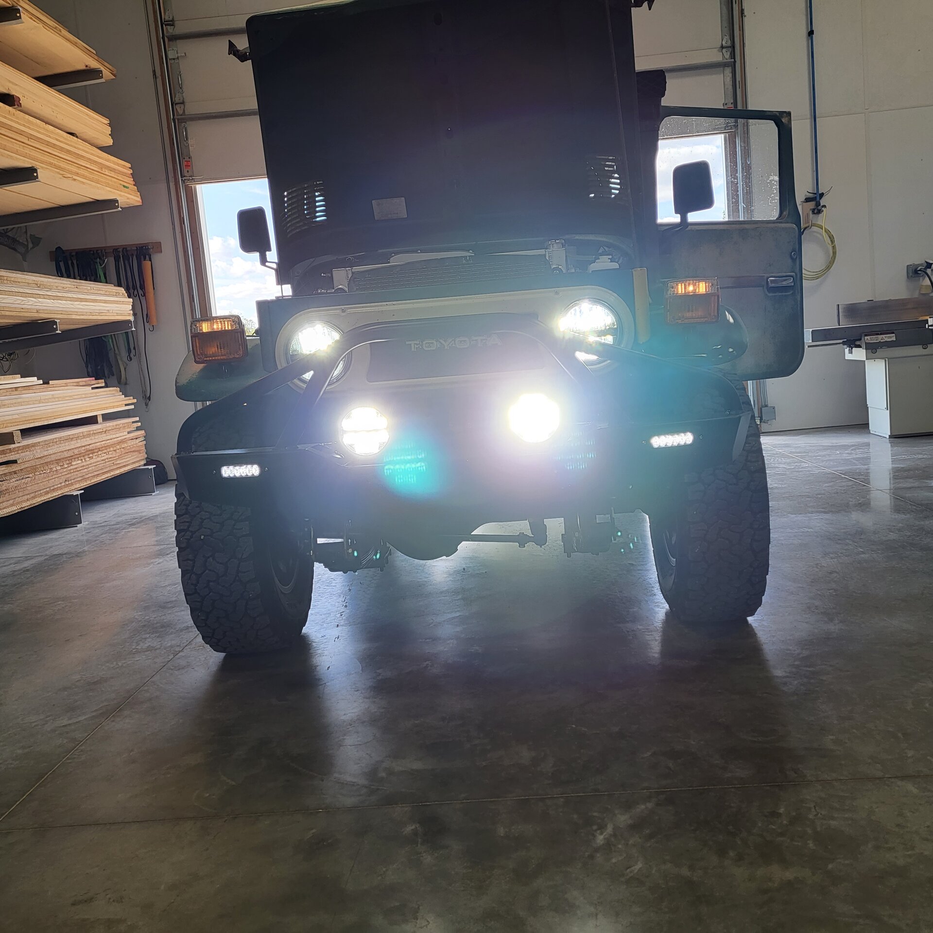

this is the bumper built around Baja Designs Squadron pro
I would love to get one of these bumpers. Will it fit an 8274?

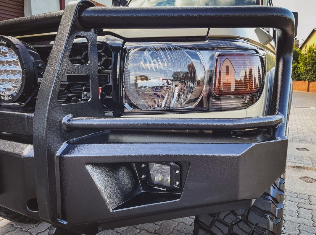

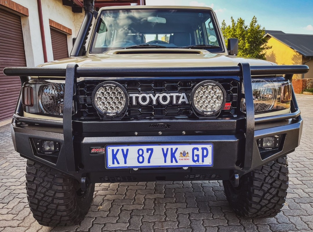

Recessed would look pretty cool similar to what brute force does. I have no idea what lights would work best though.
I will do an 8274 version next.
I chose the lights just based on reviews like you tube and such. I do know they're brighter than the inexpensive Amazon/Ebay flush mounts.
The squadrons have two price points. The brightest is obviously the more expensive.

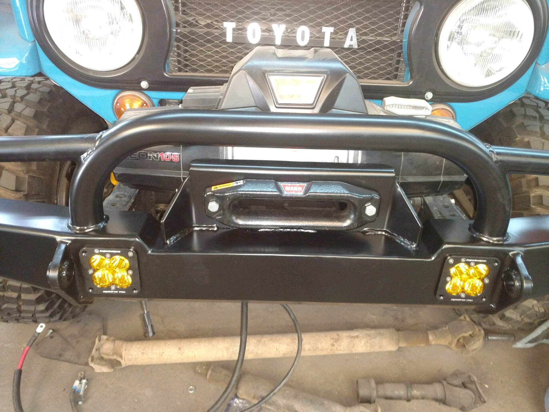

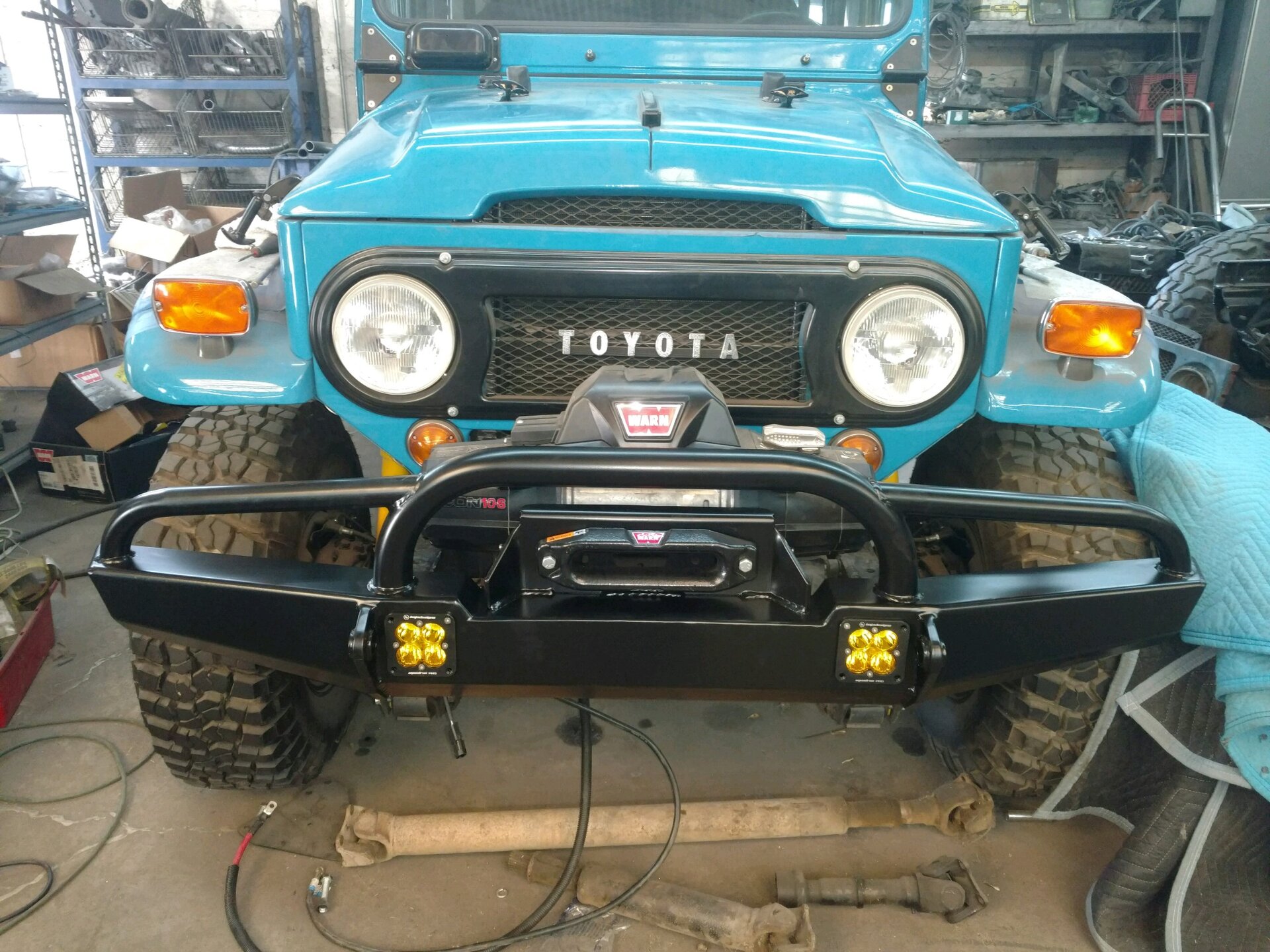

I'm super happy with the Rigid lights. Not cheapo, but not obnoxiously expensive.
Stupid bright.
I put two of the square diffused lights in the rear bumper, but haven't gotten around to wiring them up yet.
Seems like the big disadvantage is they can't be aimed if flush mounted.
I think the flush mounts are usually intended as fog lamps. Living my whole life in Az, I'm not sure what fog is so i have to imagine. For a driving light, the bigger the reflector, the better. I have 6" and 9" for driving off road. It's hard to over drive a good 6", even harder to over drive a 9" light. Three to 4" lights are good for crawling around or if you're in a convoy and you want a bit more vieion without pissing off the guy in front of you.

Rigid is an AZ company so I do like using Rigid. We have placed those same flush mounts in a factory style channel, about the same spread. Later, I was looking at ways to move them in, as the wing position is more vulnerable when crawling around in AZ boulder trails. We're hoping, by extending the D-ring mounts alongside and
in front of the lights, we get even a little more protection.
