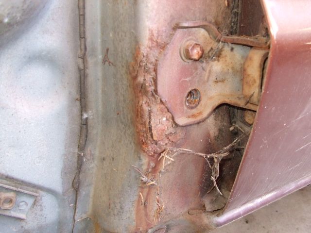

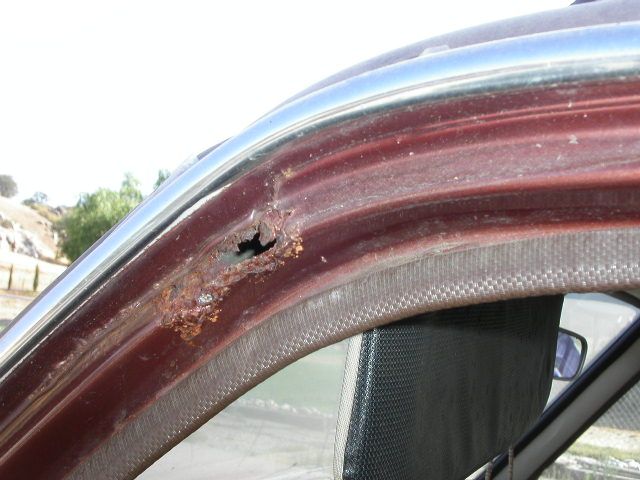

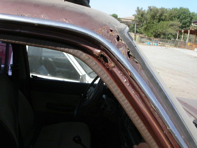

Check the A pillars on the body. This is the area where the top corners of the windshield meet the body. Open the doors and check the area in question as well.
The bottom of the tail gate.
After that it is the the top of the rear wheel wells, etc.
You really do not want this.
The bottom picture is the bottom door hinge on the drivers side. If you look a the top pic you will see the little rust hole on the A pillar on the driverside.

Wow, that is bad! Thats the A-pillar right? Is that from a 60?? Is that a comon place for 60's to get rust?
Yes, it is bad. I have seen worse on peoples daily drivers.
It is from a 1984 FJ 60 that lived it's life in northern california near the coast.
It is common for them to rust in this area. Open the door and look for rust in this area. They rust from the inside out. If you see any rust on the seam it has eaten it's way out from the inside.
View attachment 163089View attachment 163090View attachment 165376
Hey mate. I have some rust spots exactly like the the pic you have posted. I want to fix this and need your advise. I have seen some pics on google where they have cut out and welded in fresh metal. If you have done a repair can you please tell me how to go about it. where are the spot welds located and how deep to cut it when looking from the outside close to the front windscreen rubber or off it?
