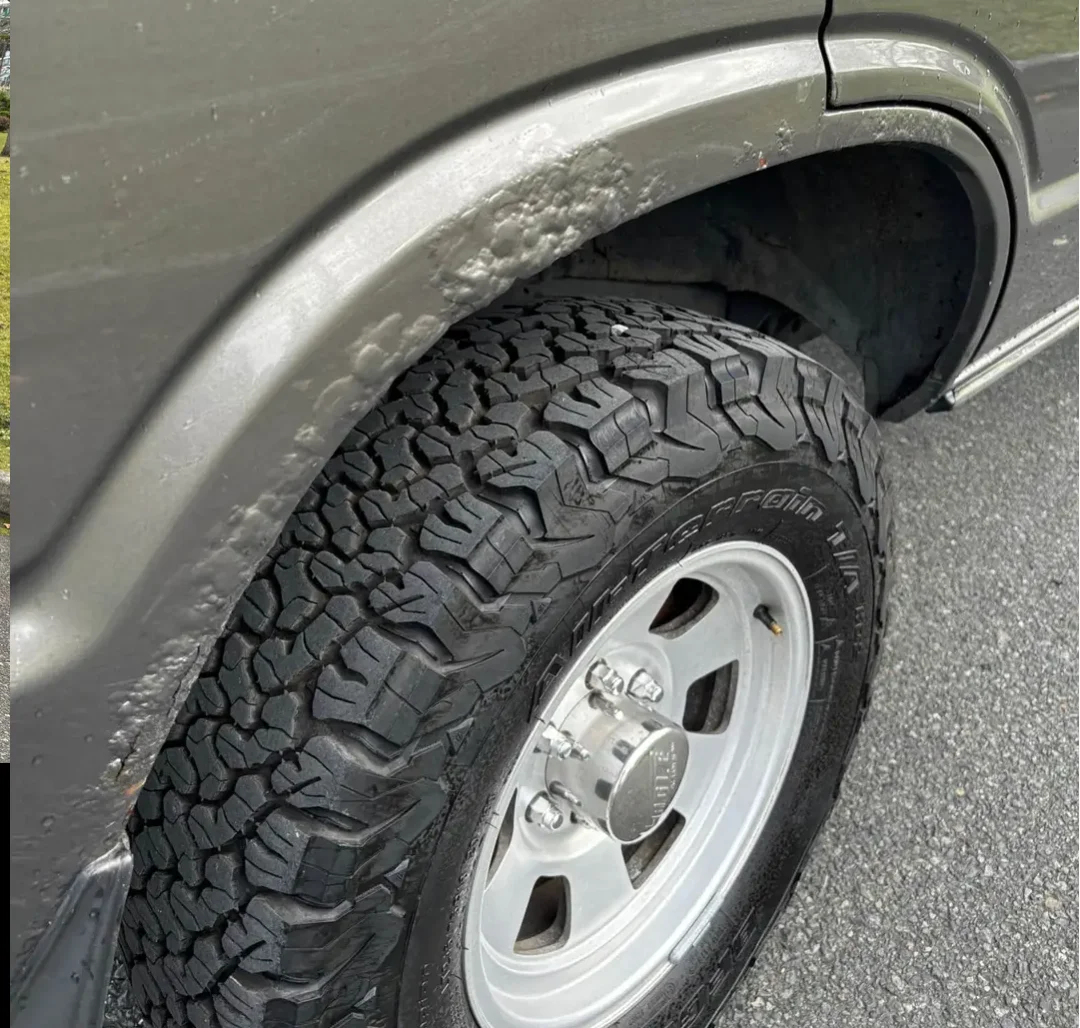

I'm sure the go to answer is Zero rust, or close to zero. But if one can't afford a pristine, restored FJ60, what rust would be worrisome? I don't have deep pockets, but I've been wanting either a 60 or 70 series vehicle to enjoy as a casual driver. An FJ60 showed up near me (3.5hr away). It's priced at 14,500 as the owner knows rust areas will need repair. Is this one to just let pass by or worth a look? I understand rust repair can vary widely depending on how extensive it is. Obviously, if the rust is creating a structural issue with the frame, then that is a no go for me.

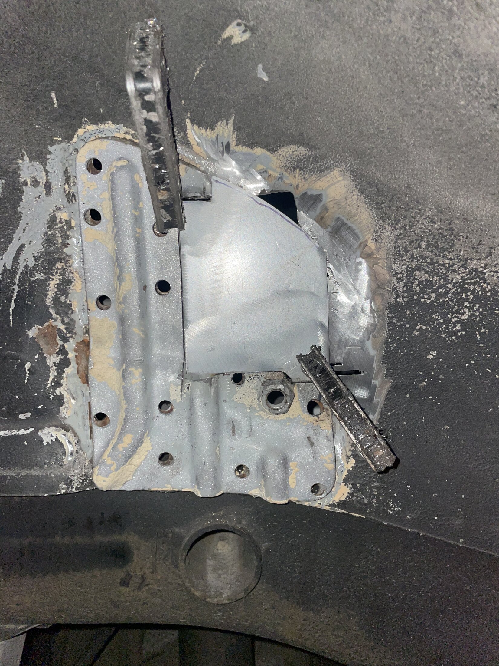

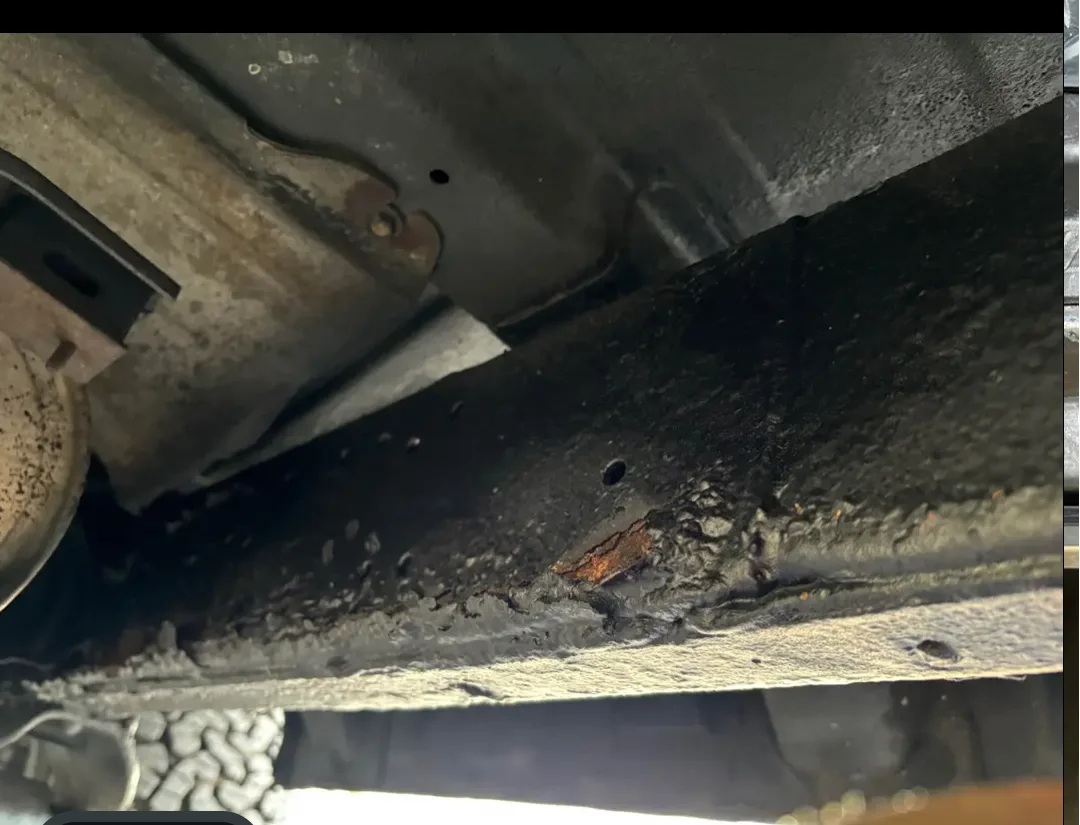

IMO frame rust is not a big worry as it's pretty easy to weld.

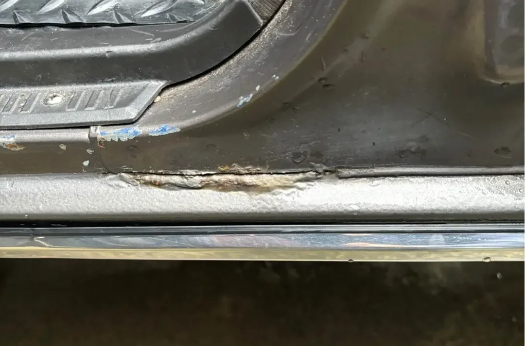

But the bodywork looks bad, what you see may be the tip of a very nasty iceberg.

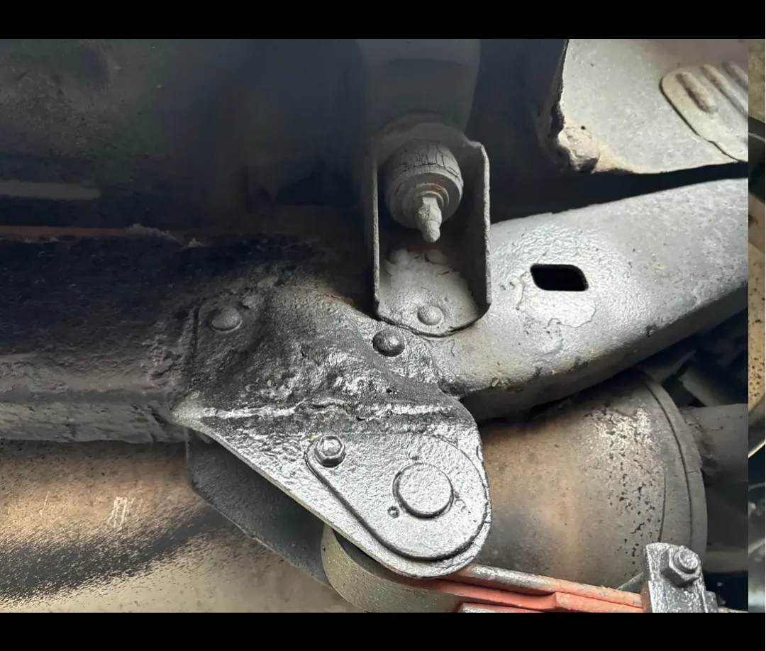

What’s going on with the frame? That gnarly spot where it appears someone painted over rust and it’s coming back. Was it welded there? Frame rust would be more of a concern for me, fwiw.

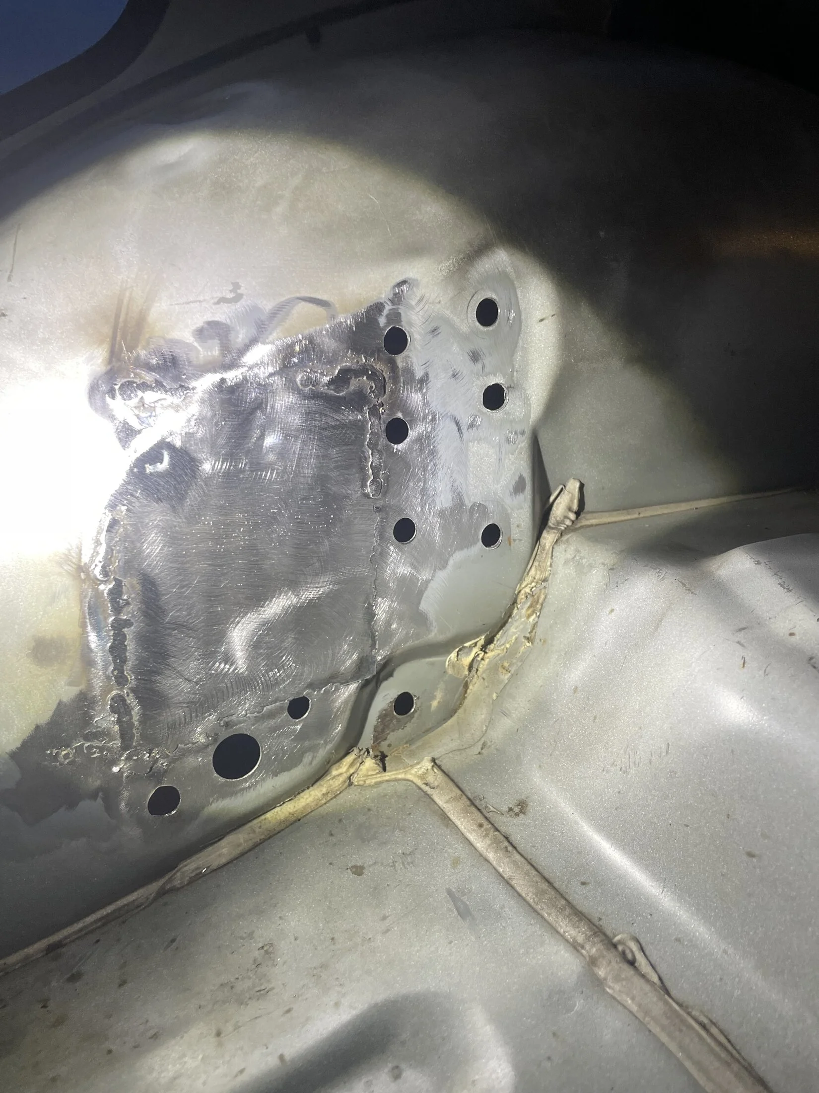

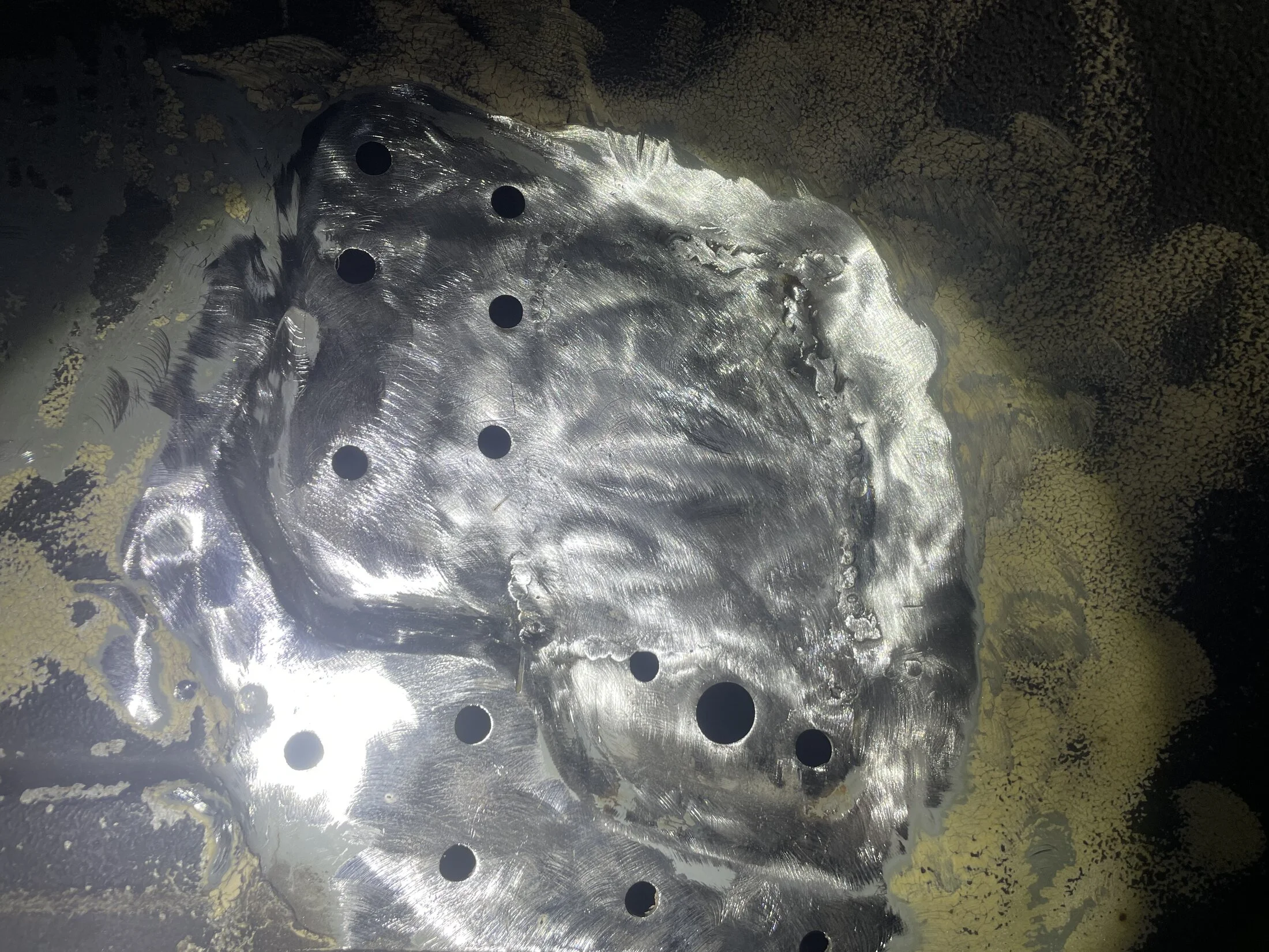

You’ve probably read that the back C channel area is an important area to inspect for rust. Rear body fender and wheel well rust seems inevitable with the 60 series. There are kits available if you want to cut it out and weld in new metal. If the rust wasn’t too bad there I’d be inclined to dig out as much as possible and just live with it that way indefinitely. Just make sure it hasn’t spread too far into the cargo area.

Do you want a perfect rust free shiny truck or are you going to take it offroading on trails, camping, utility etc. some rust is not the end of the world if you are actually going to use it for Land Cruiser activities, and you might live in a climate where it might take years to get worse. That wheel well might look exactly the same in five years in the southwest US.
Also on your own abilities/inclination. Are you prepared to get under the vehicle for a weekend and removed the surface rust/coating with a wire wheel and cover it in a wax treatment? Unless the frame is really ready to snap in half the surface rust isn't going to cause you any issues.
How about doing welding work yourself? It's easy to pick up a MIG these days, there is certainly a learning curve to repairing thin metal, but a proper rust repair of that vehicle will not be economic if outsourced.
But the state of the body would make me worry that the front cowl, roof, floor pan could be rusted through to the point where there is water in the vehicle which is really not nice.
My 62 in terms of the wheel arch, looked fantastic.
However when I pulled up the carpets I was surprised by a slightly rusted seat stiffener, which quickly turned into a LOT of hidden rust.
Even the ones that looked good will have rust creeping up in in all the places, I wouldn’t buy a 60 series without being able to peek under the carpet.

tap on the frame a bit with a hammer looks like some fresh paint trying to hide things.

Like @cruisermatt said, a little rust isn’t bad, all 3 of mine have a little rust. I’d avoid big areas of bubbly rust or holes.
