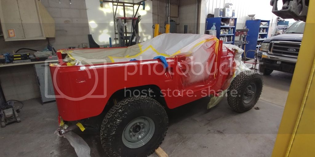

Well update on the paint. The hardener is no longer available for the axalta single stage paint we were going to use so its gonna be base/clear now.
I beleive the exterior has now been painted. Cant wait to see it. I've been busy buying whstever additional gaskets that i can and am collecting parts almost daily it seems.

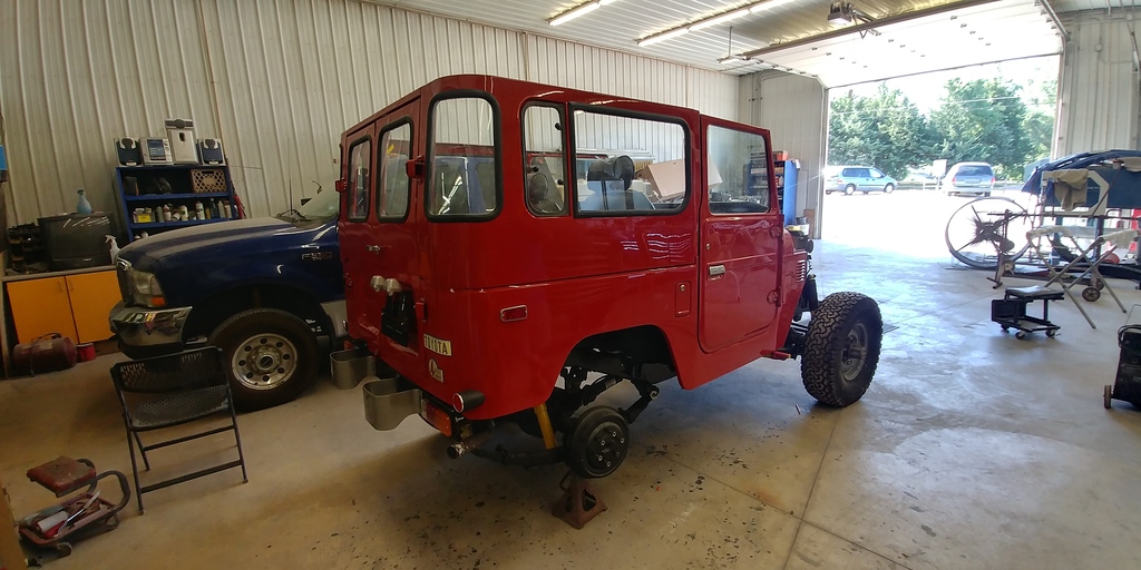

Body is painte They are finishing up the doors and hood and then just the fiberglass cap yet to paint. Interior metallic silver pieces are painted also. I've got a couple questions for the forum but I don't have any pictures to demonstrate my question. Hopefully I can snag a few on Friday.
Progress continues. Really getting excited to drive it again. Every time I see it at the shop I just can't believe it as my only memories of my aunt's "nellie" certainly aren't of it looking like this. I know that she'd be thrilled to see her old truck looking like this!

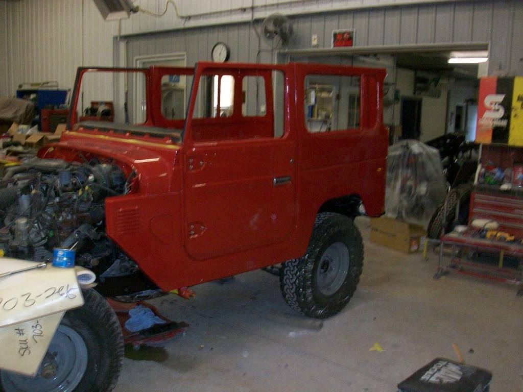

Over the past 20 years or so she used the FJ to move snow with a rear mounted 8 foot snow blade. Over that time she couldn't have put more than a couple of miles on a year. The truck spent a good number of years outside and thus I'm sure the rust shown in the pictures below.

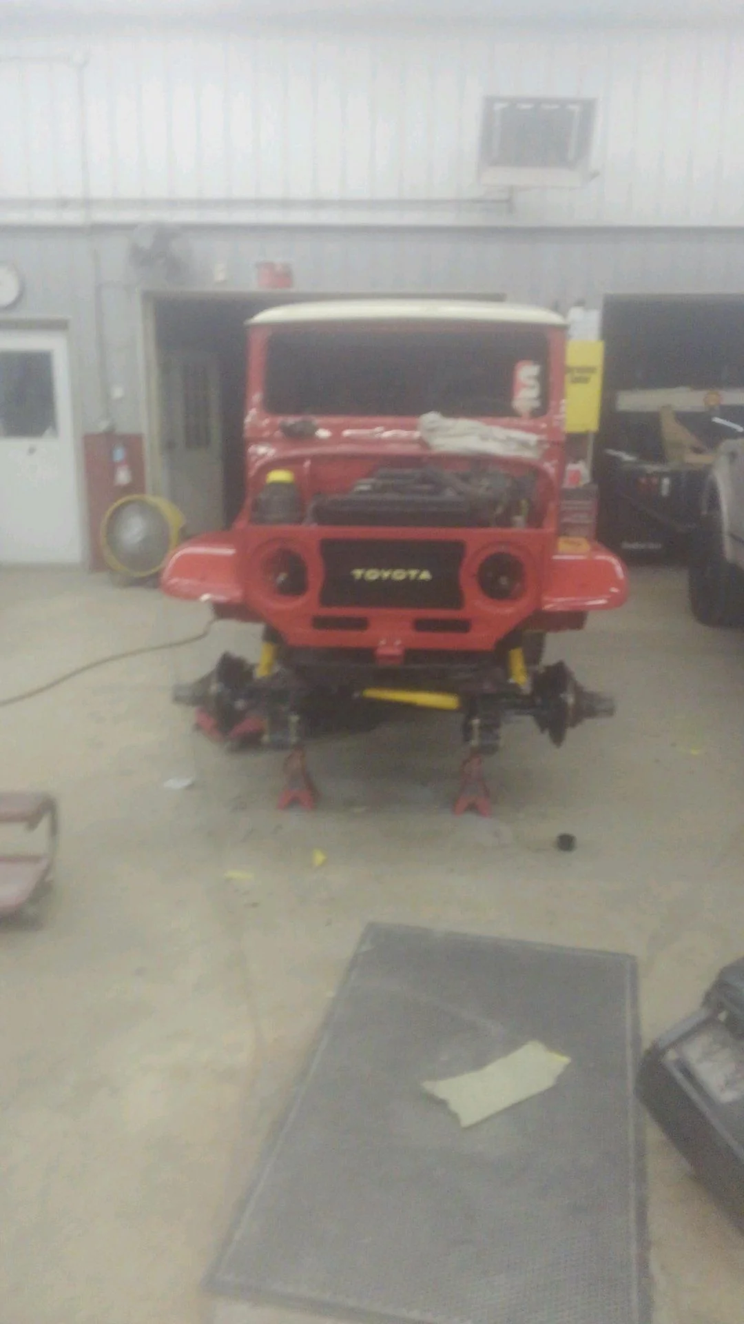

Progress continues putting the front together. Maybe its just the lighting in the picture (i havent seen it in person yet) but does anyone think the color looks off on the bib?

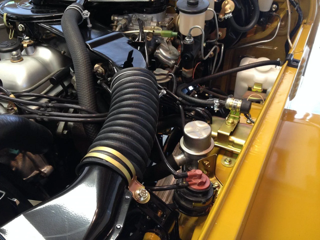

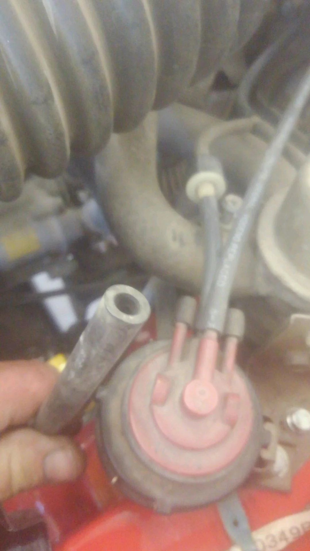

Also the shop doesn't know where this line/hose goes (the line he's holding)? It comes off the bottom of the part with the red top. The part is located on the drivers side closer to the front of the vehicle.
Thanks!
Thanks!
It's the drain hose for the charcoal canister. That's what that red topped thing looks like to me. But yours is a 77 so it's different from mine. I'll let the real experts chime in. My charcoal canister is on the passenger side.
