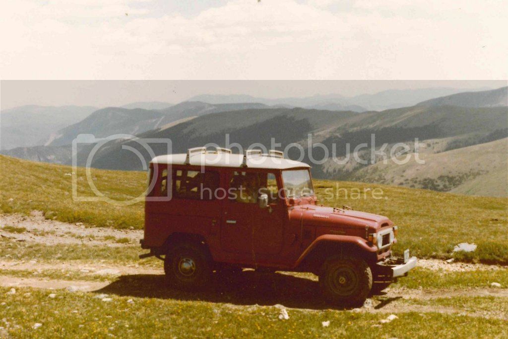

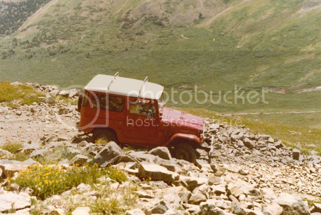

I got to thinking I dont think I ever shared these photos. Here is my Aunt in Nellie. These were taken the first summer she had her 40 and were taken in July of 77. This is the trail to Argentine Pass in Colorado.
Those pics man... priceless! Very cool to have vintage photos of the truck. You should have one framed in the garage.

@NellieFJ40 , your Aunt would be very happy at seeing the attention her truck is getting.
@Jdc1 thank you for the kind thoughts! Ypu are right, there's no doubt my aunt would be thrilled. I've sure thought of her alot during this process which makes me happy!
@Honger good idea about the pics in the harsge. Ill make that happen for sure. Wish there was a way to wnlarge these old pics and not have them look terrible.
