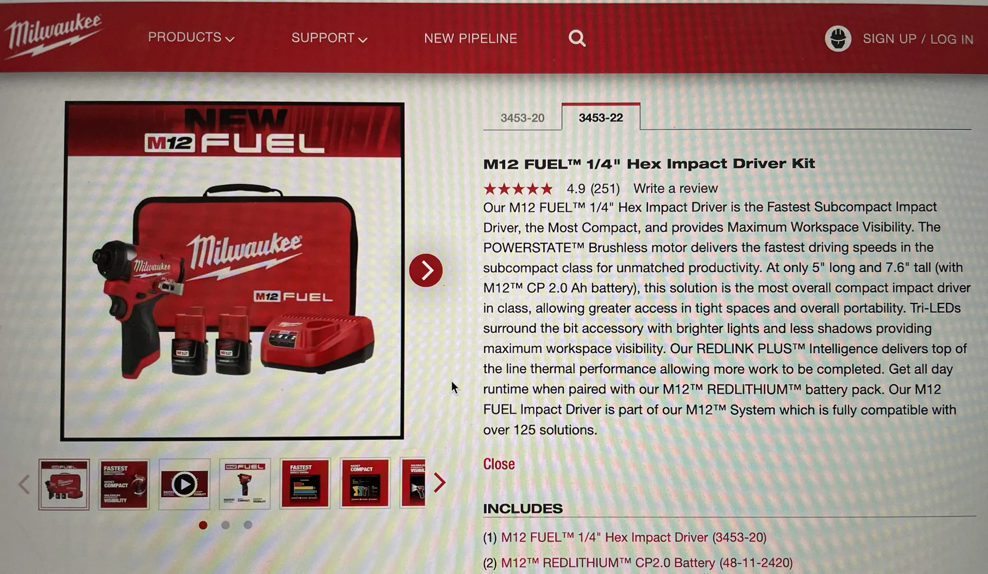

It's this one....
that is a really nice one to have. Very handy small package but high-performing. Nice gift! Now that you'll have the impact driver, charger and 2 batteries, I would get the non-impact driver with the clutch, those are so great for more delicate slow driving of fasteners. The basic non-fuel tool only can be had for only $40, it's a pleasure to use.
