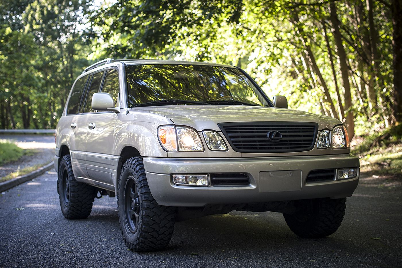

Lots of great info in here from all sides, love these kind of discussions and love to see what fits and what hits in the real world while being used etc... I have two 100's and one 200. I run the setup you described above on my 200(I know this discussion is about 100's:)) but just wanted to clarify that setup works on the 200 series. Unless you were talking about it rubbing on the mudflap and lower inner plastic fender parts? It does not hit the fender and clears it for a full tuck(no additional bumpstops). After removing the mudflaps and cutting out some of the lower inner plastic lining I have zero rubbing. On my LX I roll a 18x8.5 with a 35mm offset and 33x12.50's, haven't had the LX offroad much(I'll take it out soon and flex it up and report back on rubbing) as I just got it so the jury is still out on if those will rub or not, so far no rubbing. Anyway just adding in my a couple of examples of wheel/tire combos!
View attachment 1480628 View attachment 1480629 View attachment 1480630
Nice 200! That's a great looking rig.
Can you post some additional photos of the LX so we can see more of the wheels? What brand are they? certainly keep us informed on your off-road experience. I would certainly like to know. Is it stock ride height?
