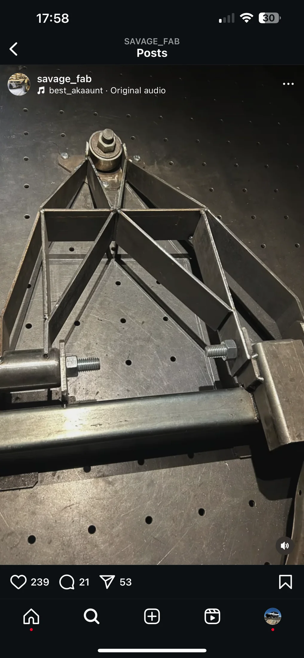

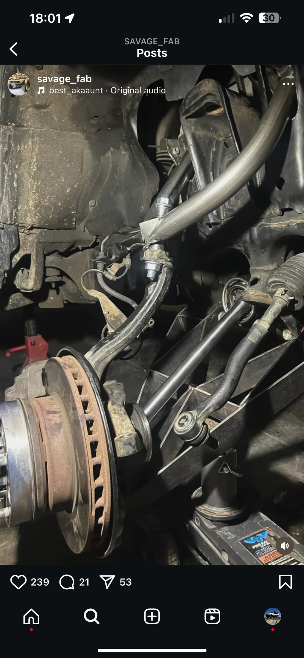

The second upcoming option is from Dave at Savage Fab (@savage_fab). He has a good number of photos of his design so far, including the custom lower control arm build. Savage fab has reportedly built buggies and other LT kits as well, which you can see on IG. Dave is currently working on a batch of 10 kits, and will be using custom CV axles, but will possibly be using RCV in the future it looks like?
Regarding the price of the Savage Fab kit, samson100 said:
$6.5k including axles (note, the axles aren’t RCV; going to take a couple weeks to get those). Shocks will vary depending on what you want.
As of 3/3 it sounds like there are a few spots left on the first 10 kits. DM Dave on IG to book a call if you are interested.

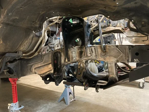

That’s a pretty good idea. Another DIY option is to weld in a section from a 2nd gen Tundra. Thats what “Russian Alex” did. I don’t know the guy, just DM’d on IG (@carpenter_by_night).
“I grafted in a section of a 2nd gen tundra frame to my front end which allowed me to bolt on all tundra suspension and 200 steering rack. Custom cv axles.
I’m running standard length tundra arms which made the front end 2.5” wider per side and doubled the wheel travel of a standard 100.
The axles are actually 3rd gen tundra axles that were shortened 1” and resplined to accept the factory 100 inner cv joint to fit into the diff. Have not broken anything yet.
Engine mounts didn’t need any work other than just needed a 3/16” spacers between engine and mount brackets. Needed just a bit of clearance at the steering rack.
This swap really hit the spot - it’s crazy capable, super beefy and drives like a car on-road. Plus it’s pretty unique and feels more like it should have been like this from the factory. Oem+”
I’m half russian Alex with the above 100. I wouldn’t say that what I did is a simple DIY option. I think doing what Dave (savage fab) is doing is a lot less work and quite a bit simpler. I just didn’t trust myself to nail the suspension geometry. I felt more comfortable just transferring over what Toyota designed over to my truck since I’ve been a collision tech for 23 years and cutting cars apart and putting them back together is my bread and butter.

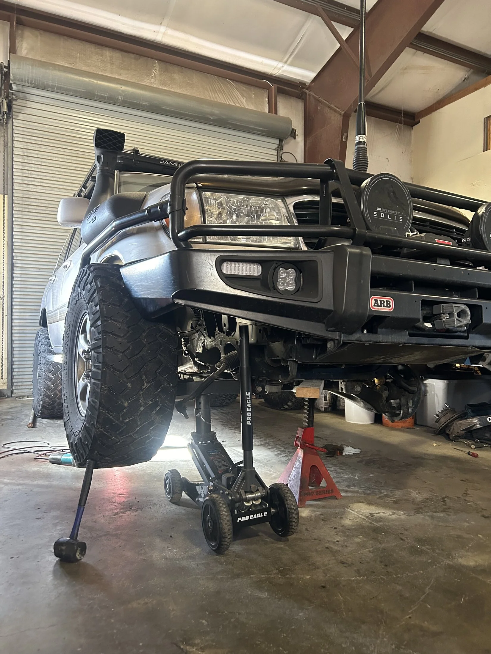

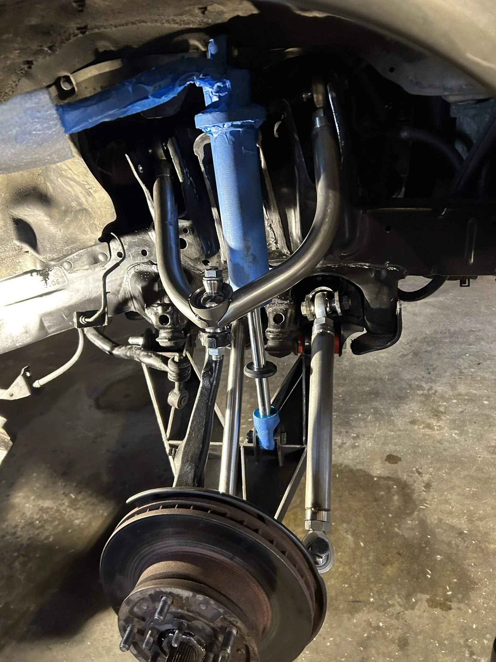

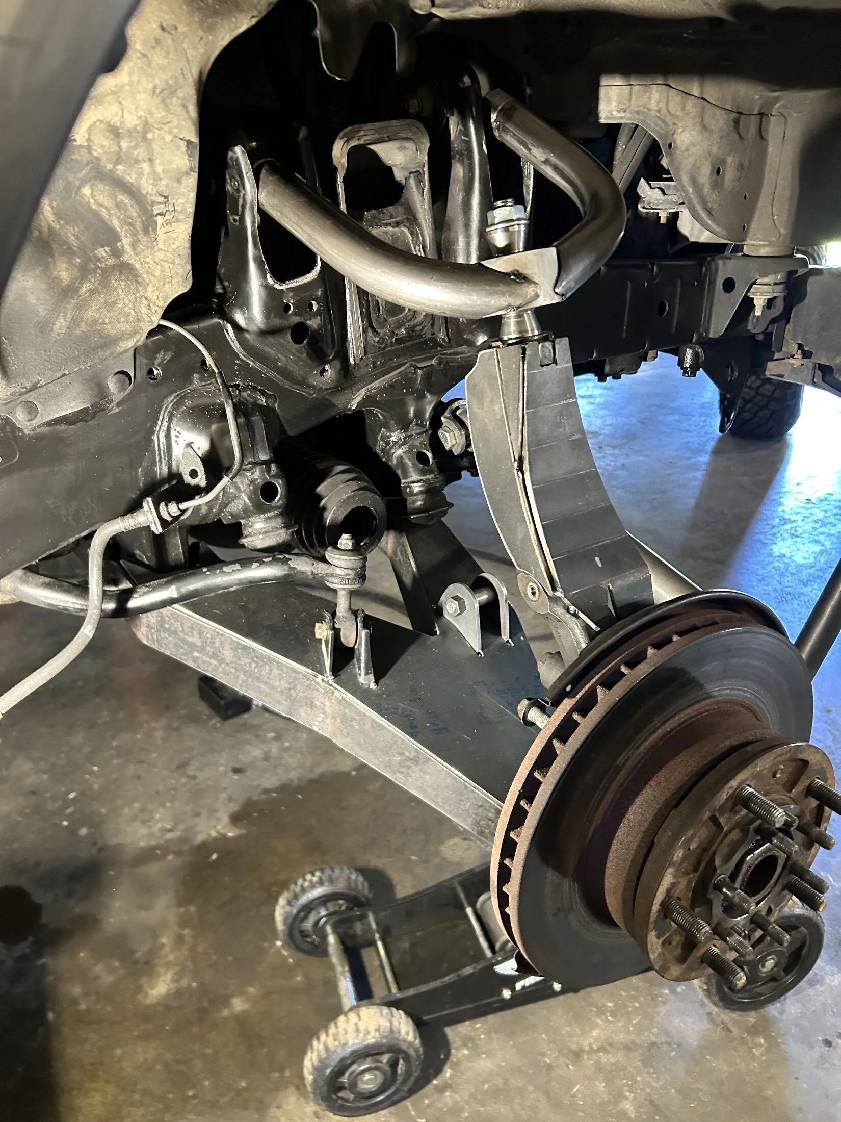

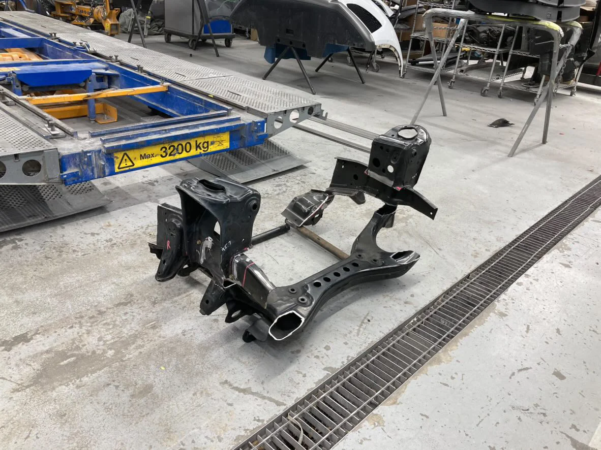

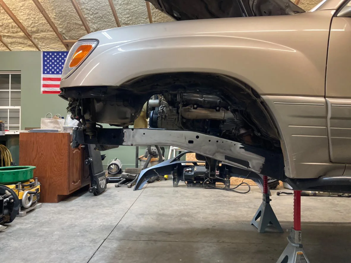

As an update, life got in the way so I wasn't able to make it up to WA from Los Angeles. With that being said, Dave at Savage Fab is still making good progress, and the prototype is almost complete - see below for some photos from last week. With the passenger side being largely complete, he is moving on to the drivers side this week. From there, he will be getting the prototypes put into CAD and then will have all the metal cut via water jet. Based off the current timeline, Dave is supposed to deliver the first and second set to Zach and me, respectively, by early to mid May.
Note, the sway bar bracket is only for the prototype / jig to ensure everything is aligned properly and won't be in the final version.

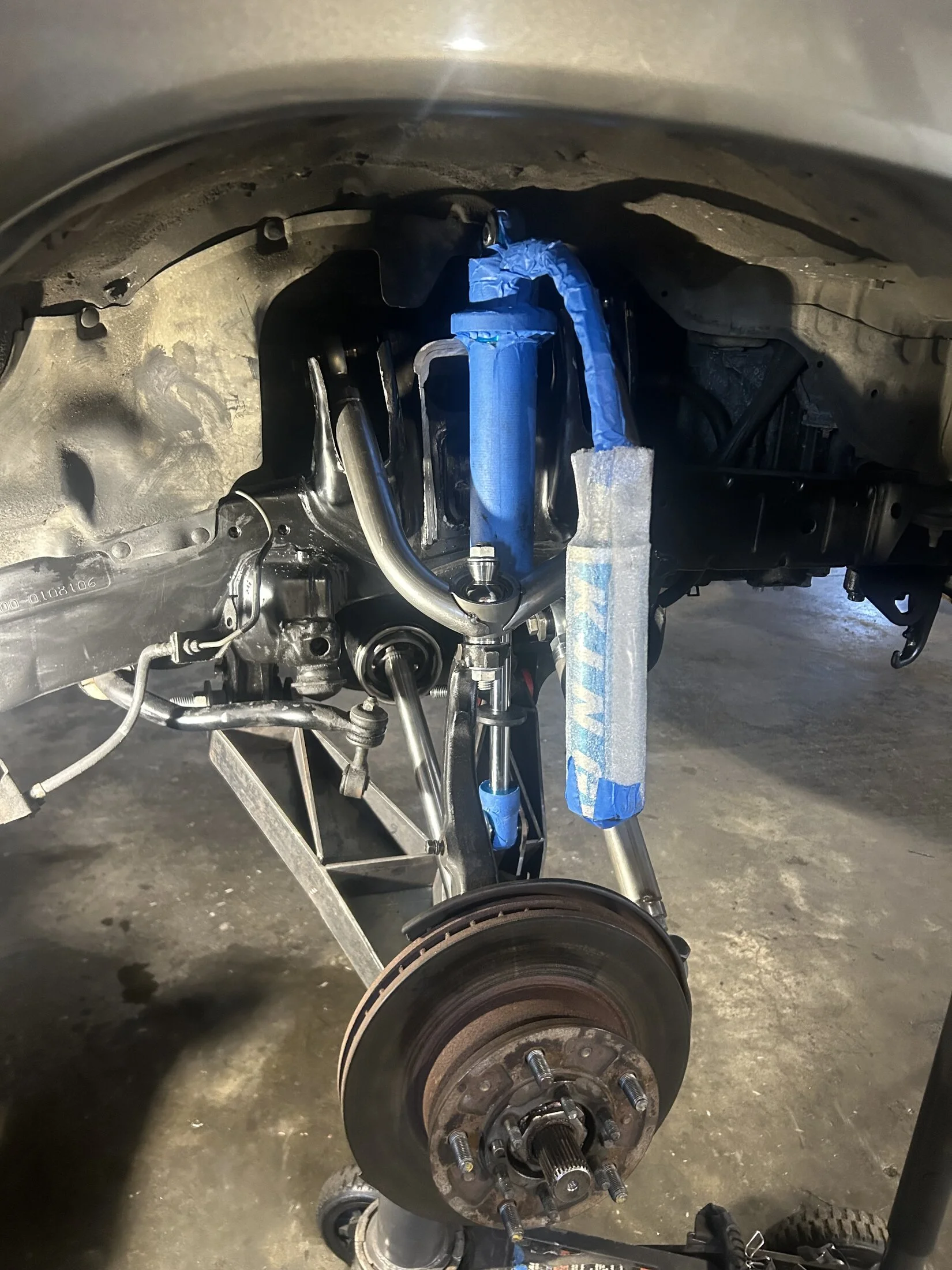

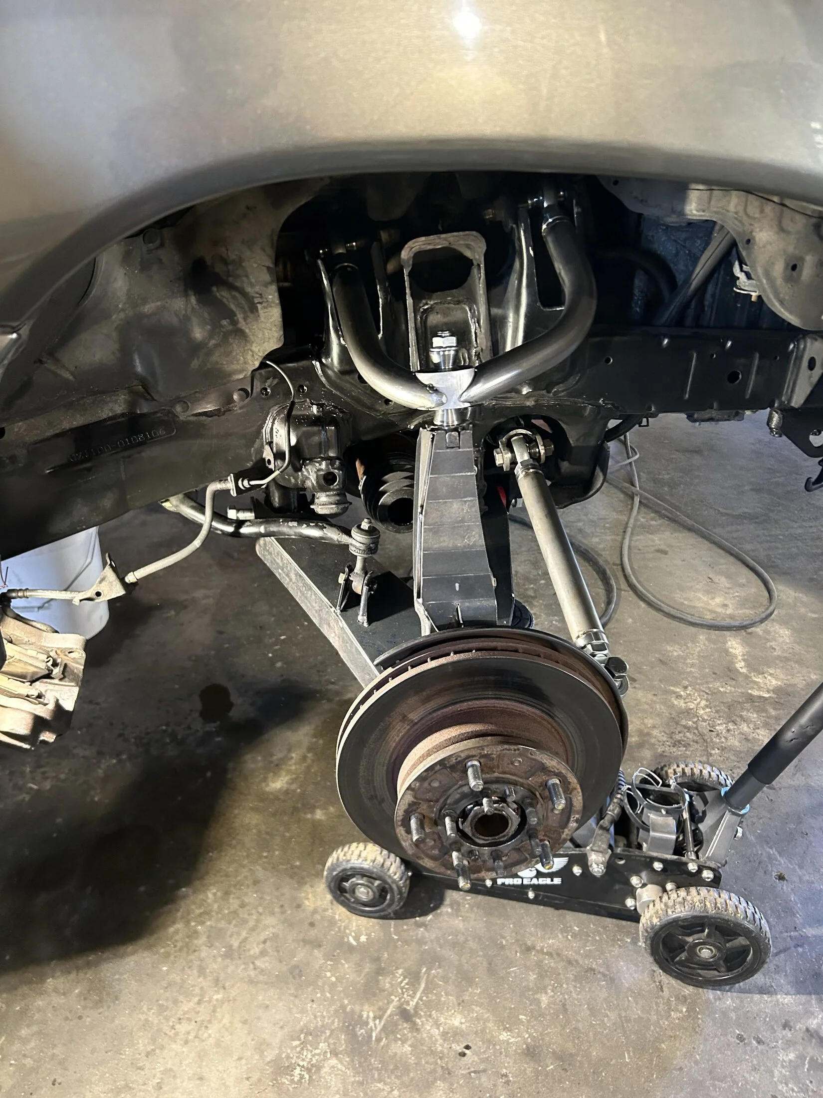

Things are looking great! Dave at Savage Fab is almost done installing the first kit on his vehicle and has been concurrently welding up parts for the other kits. So far, shock hoops, axles, and most of the small bits have been manufactured. Once his kit is installed and tolerances are confirmed (targeting completion of this by [Friday]), he will weld up the upper and lower arms for the remaining kits. I'll post the pictures that Dave has been sending me. While it has taken longer than we all have wanted, it has resulted in a much better product overall.

The first production kit was installed on Zach’s truck this past weekend. I’m heading up to Dave’s shop sometime over the next 2-4 weeks to get mine installed. I’ll post some behind the scenes pictures over the weekend.
