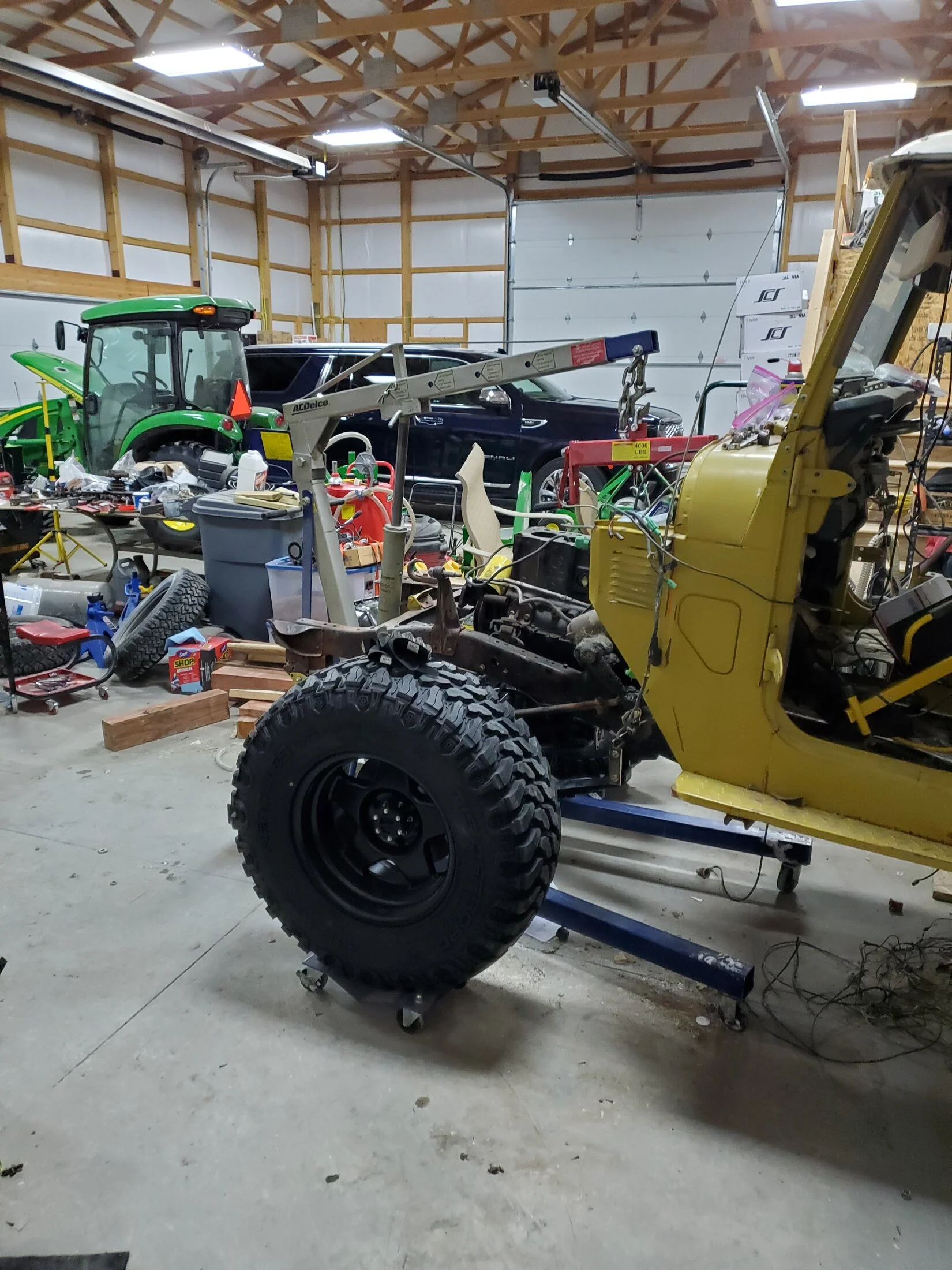

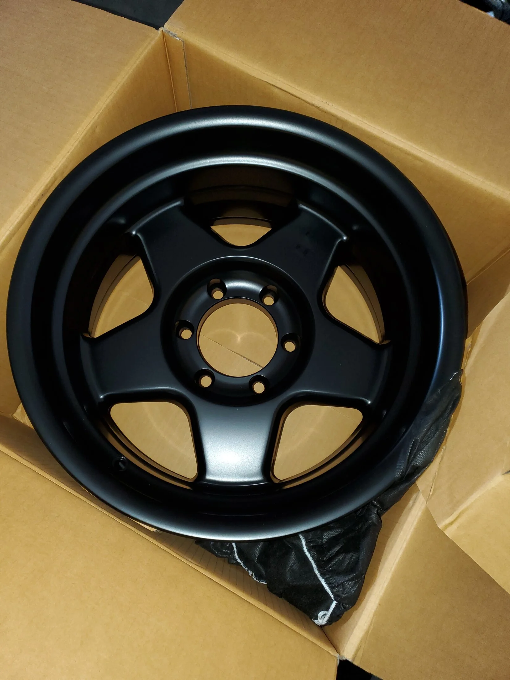

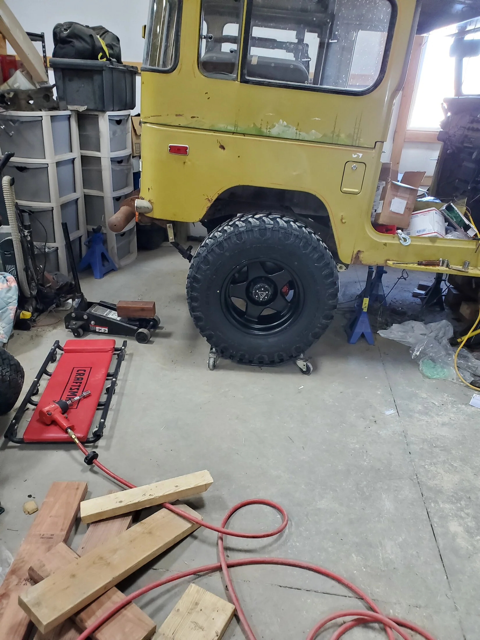

I bought a set of 17" rims from TOYOTA - https://www.stealthcustomseries.com/collections/toyota. They have the right offset for a FJ40 and I have 35 12.5 tires mounted. They also fit the hub diameter.
The minimum backspace is 3.75” for 15” rim. If 17”, they’ll go over the steering rod end, so there’s not anymore need to be that small backspace. Dipends of the tire and the mods, when they’ll hit the leaf springs or steering components.
Rear wheel wells are quite close to tires, so something like 3.75” (or less) would be good backspace because of that to prevent rubbing when flexing.
