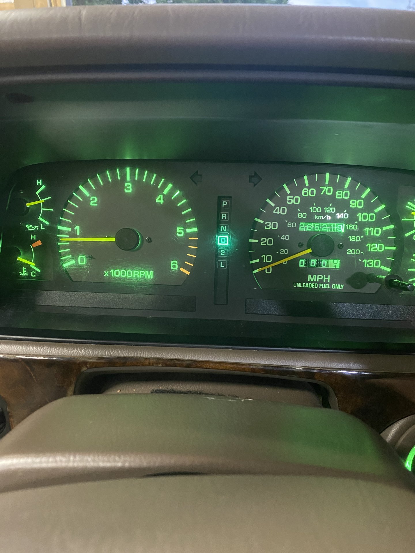

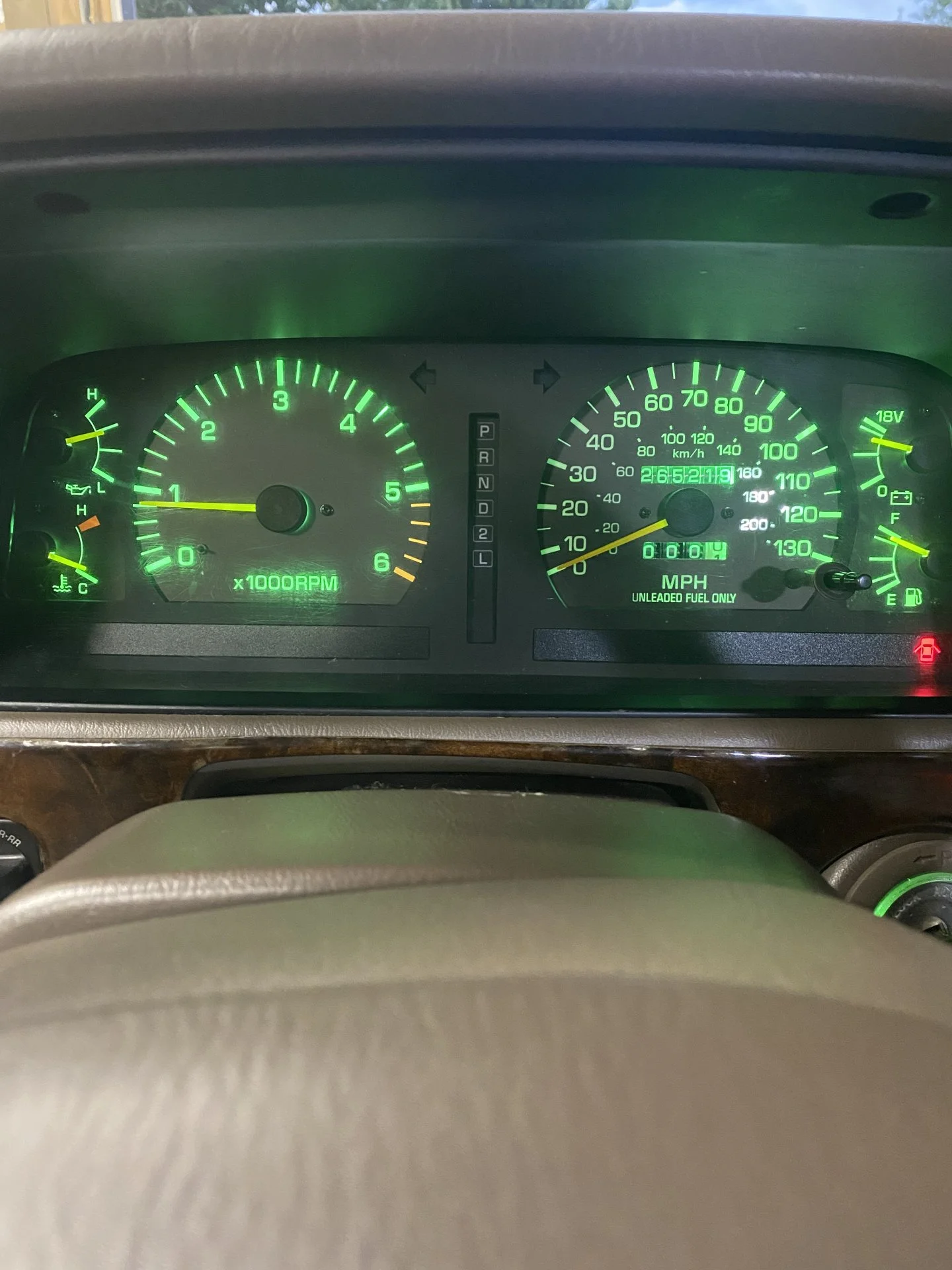

Be careful when taking the shift position display out its a white rectangle insert that holds the d light bulbs and others my was very brittle and I stole one tab there is two tabs that need depressing to take out. When you pull it out you have do push the bottom into the dash and kinda rotate down and out. Easy job takes maybe 30 min to get out and replace bulbs. I pulled mine to fix the oil pressure gauge and replaced all bulbs with led. The d light is on now but I wish I left it out like @BILT4ME said it’s nice to have dim dash lights at night. Also your center console shifter is supposed to be back lit, mine was not and since I was ordering bulbs I replaced that one also.
