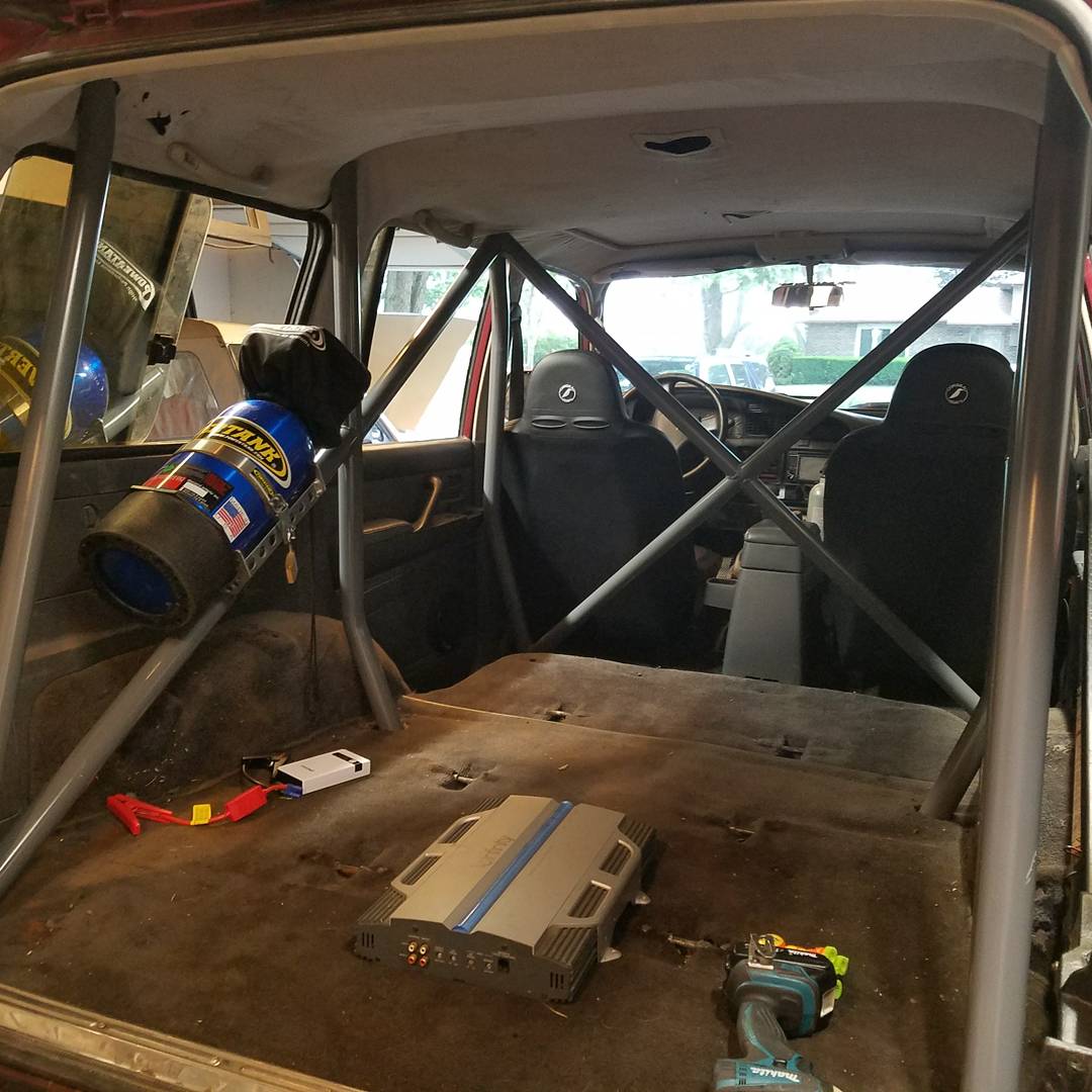

Any pics of the dash area? And why did you triangulate between b and c pillars?
B - C - D are tied together how they are to keep the cage from folding back since the sweep of the A pillar makes it the weakest point. Dash looks like a normal 80 dash, the A pillars are outside of the truck.
