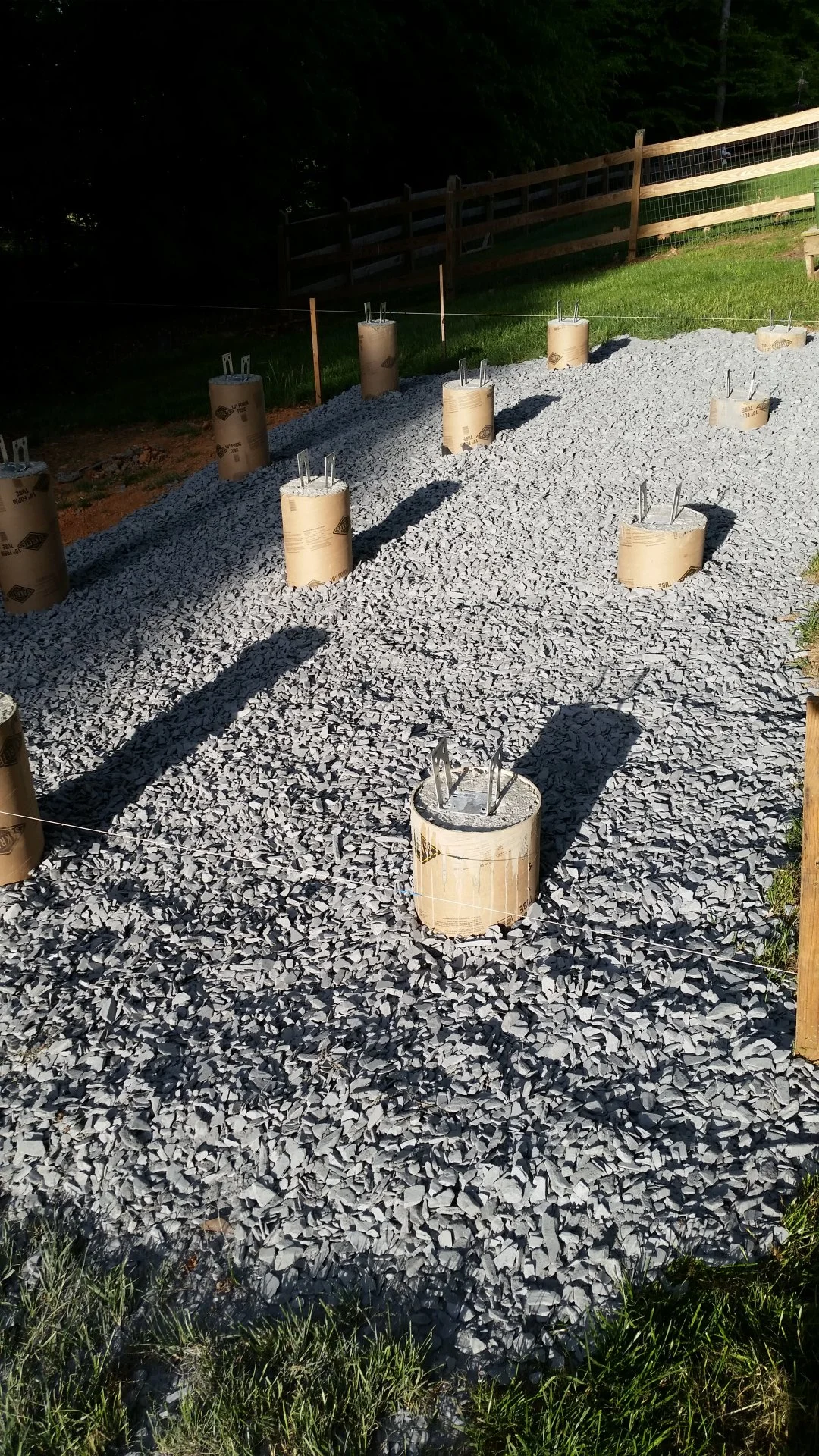

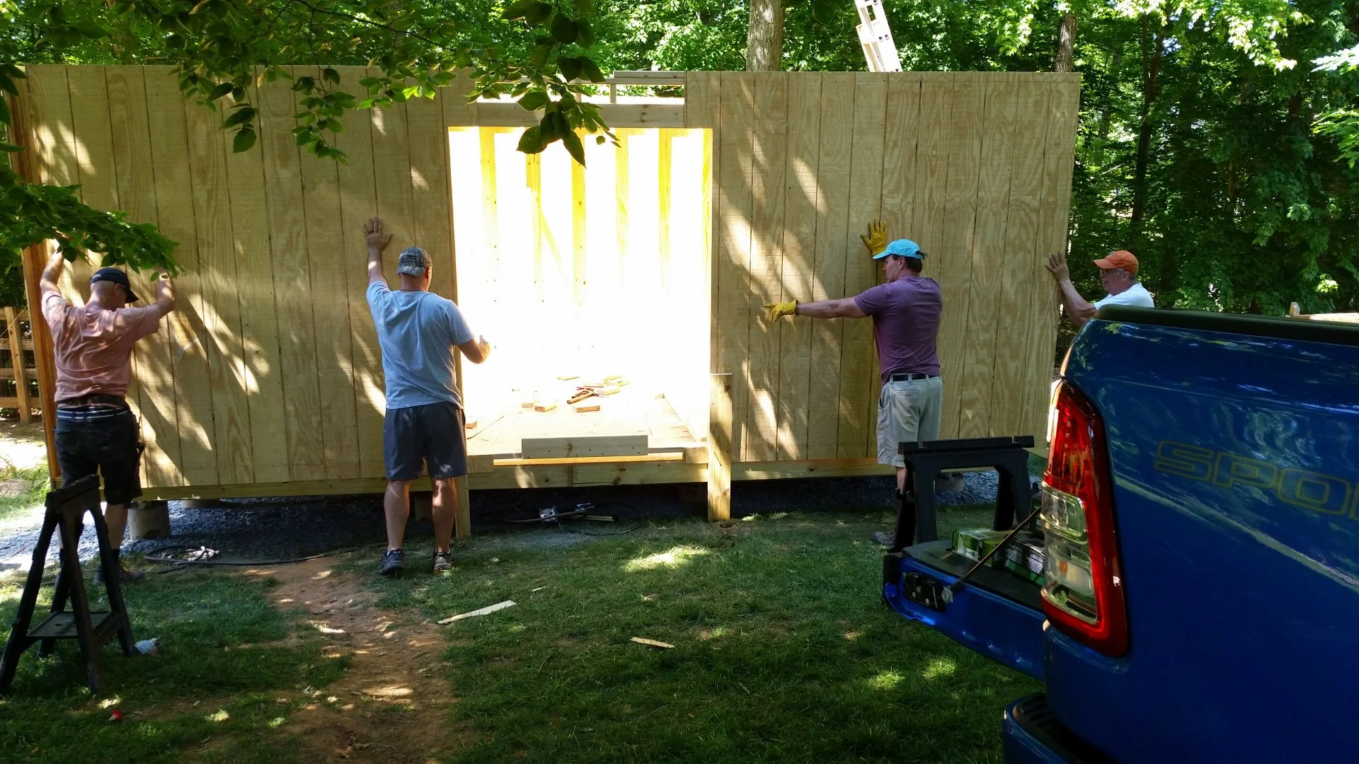

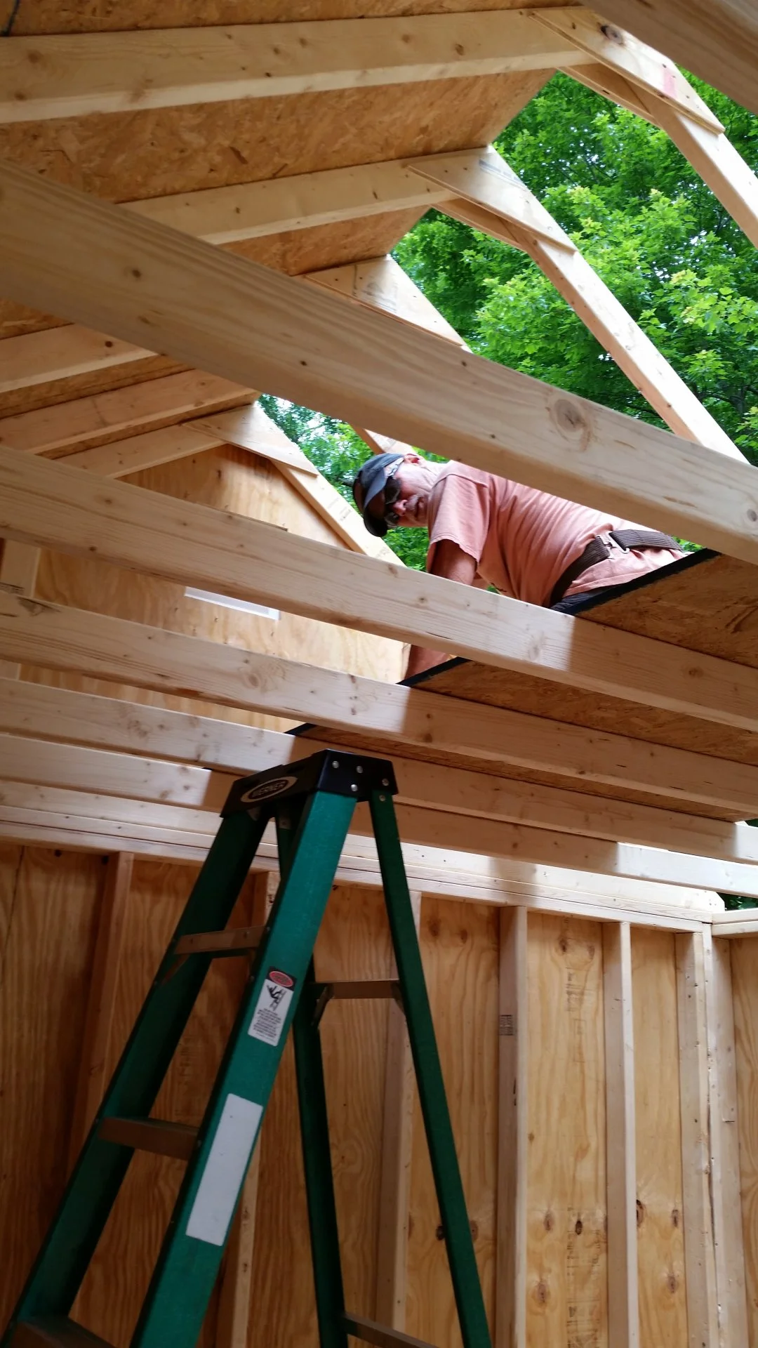

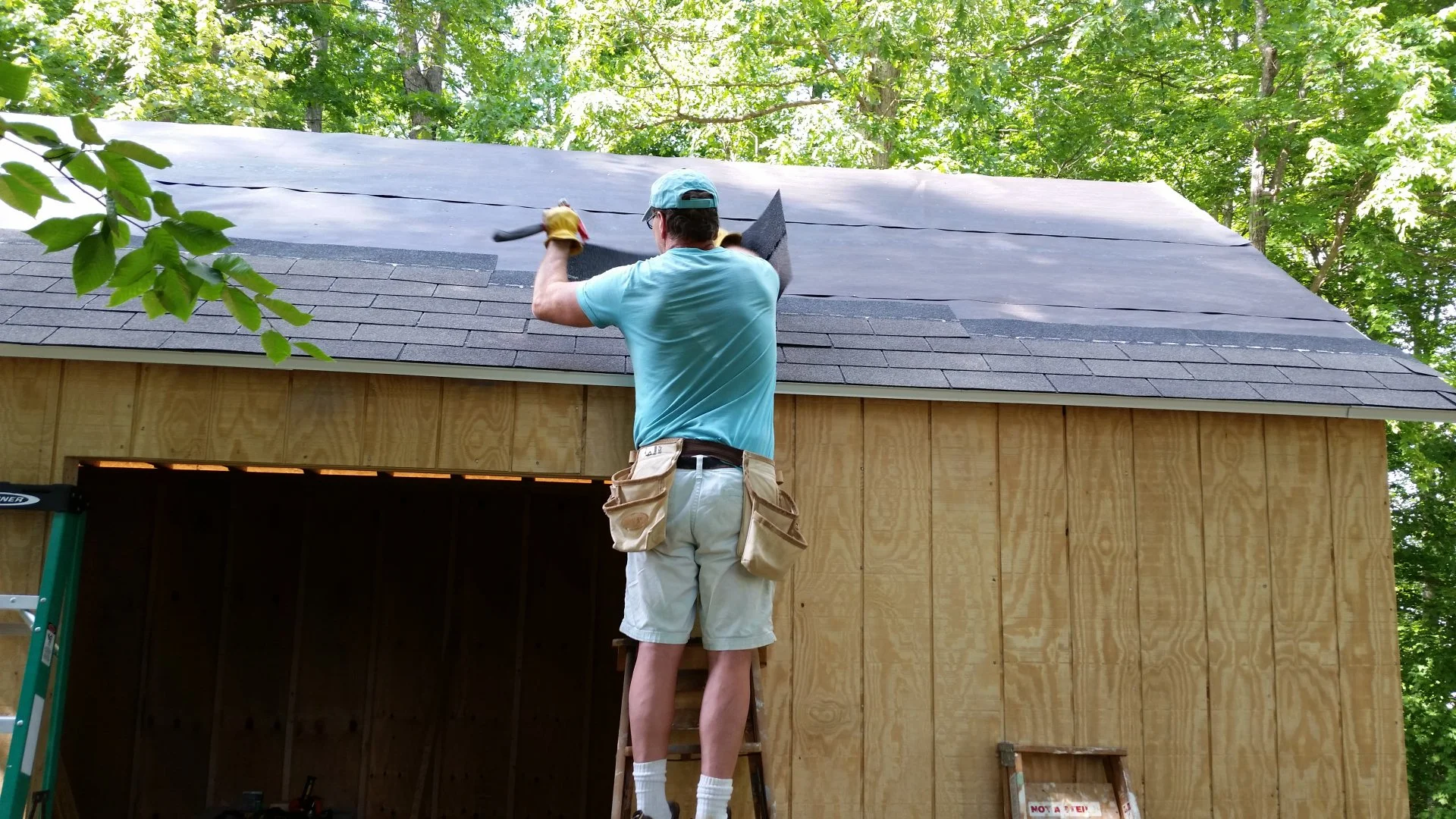

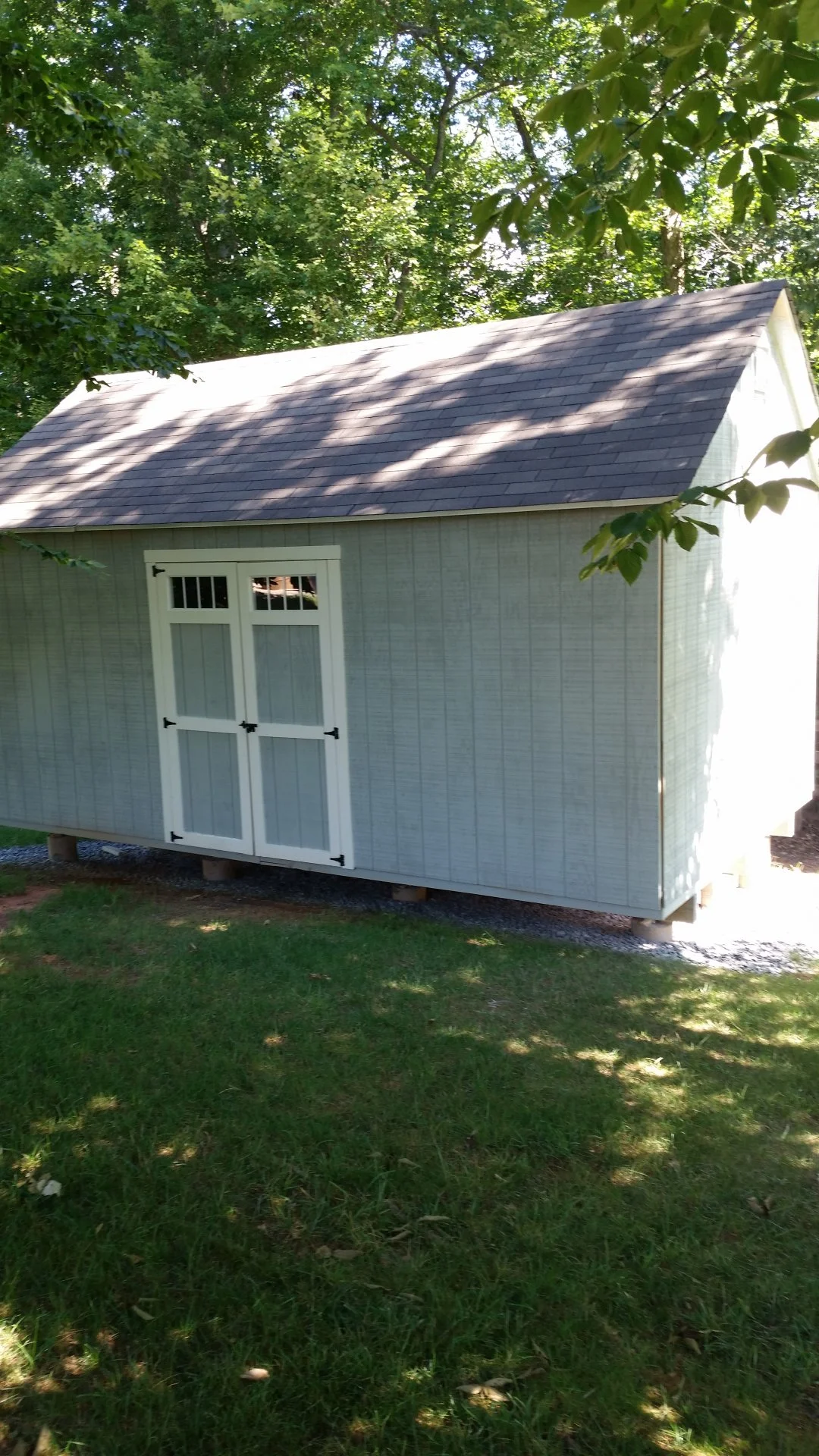

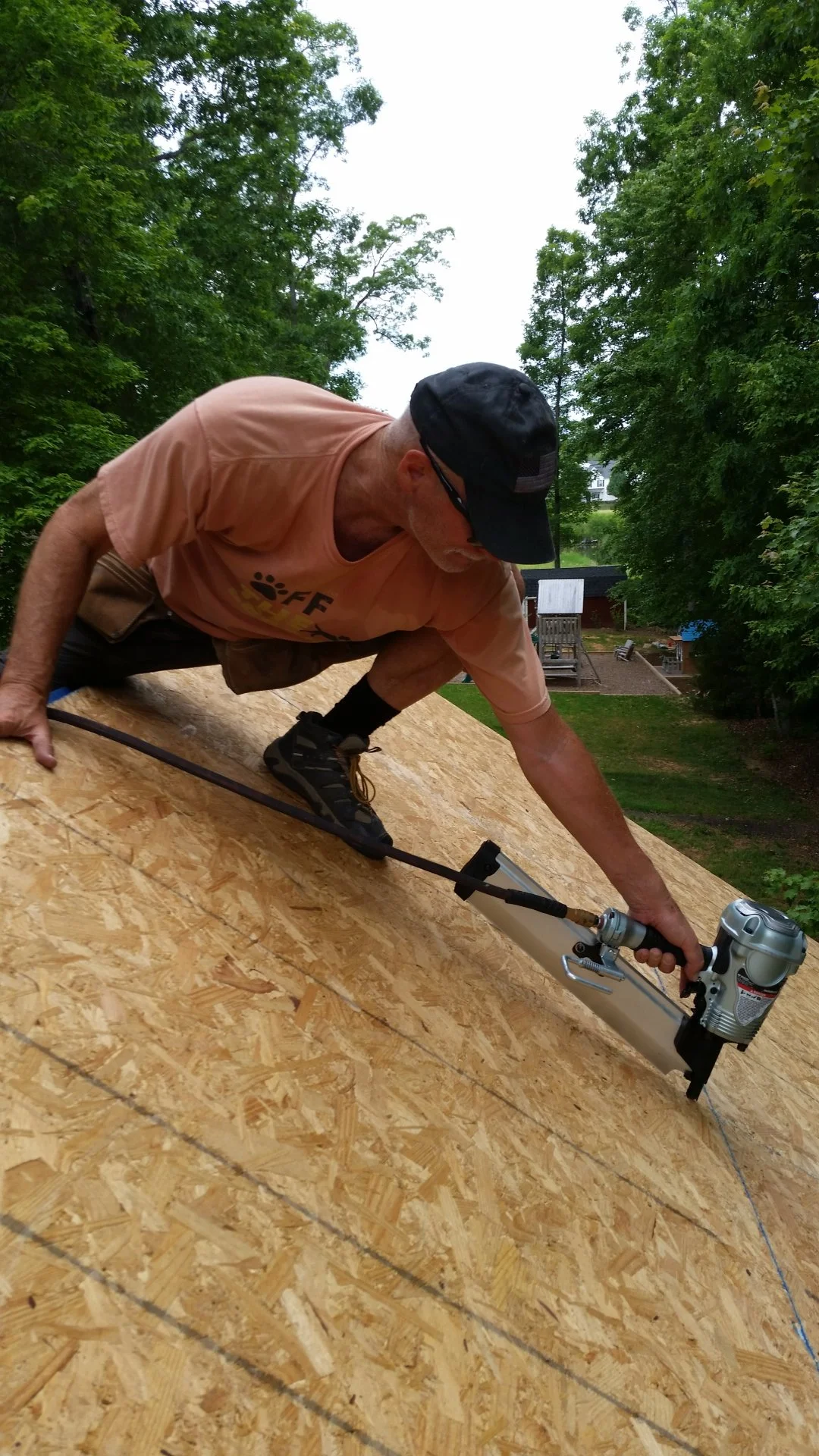

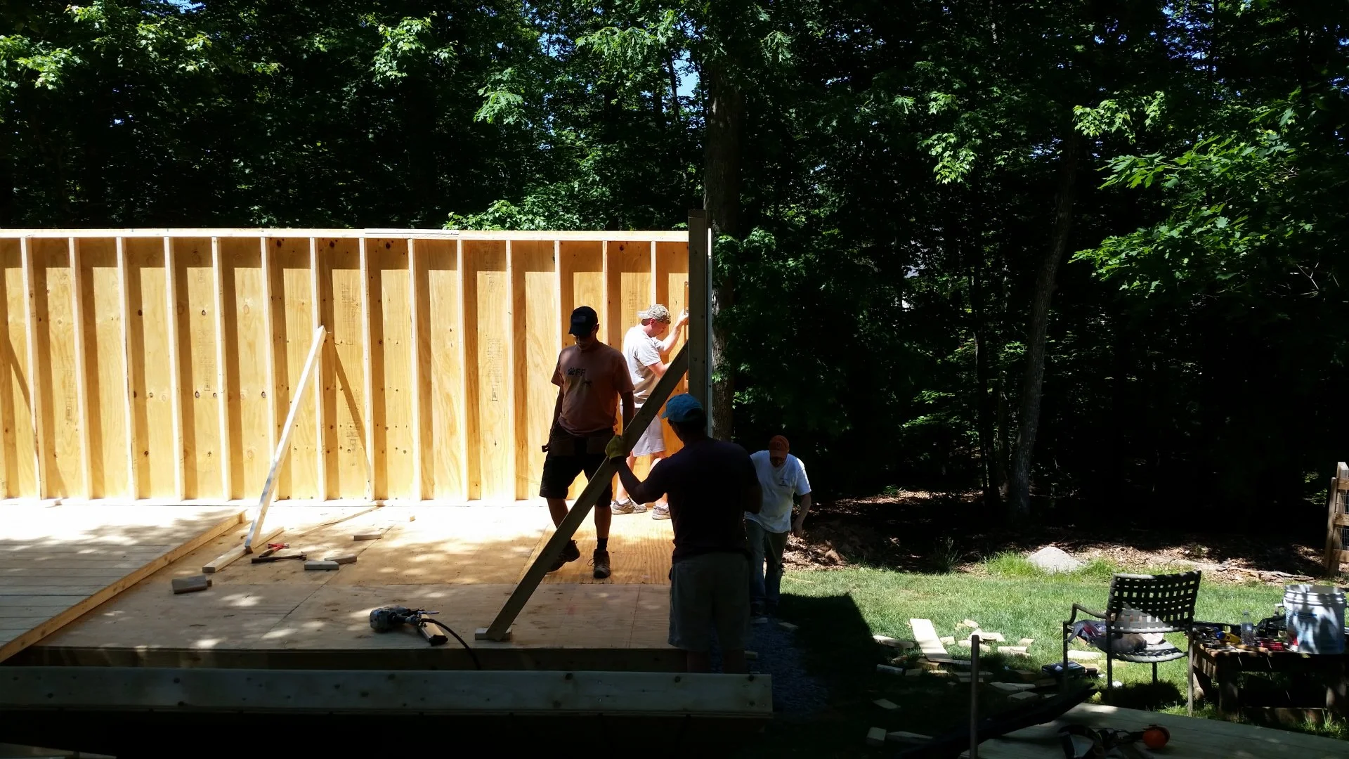

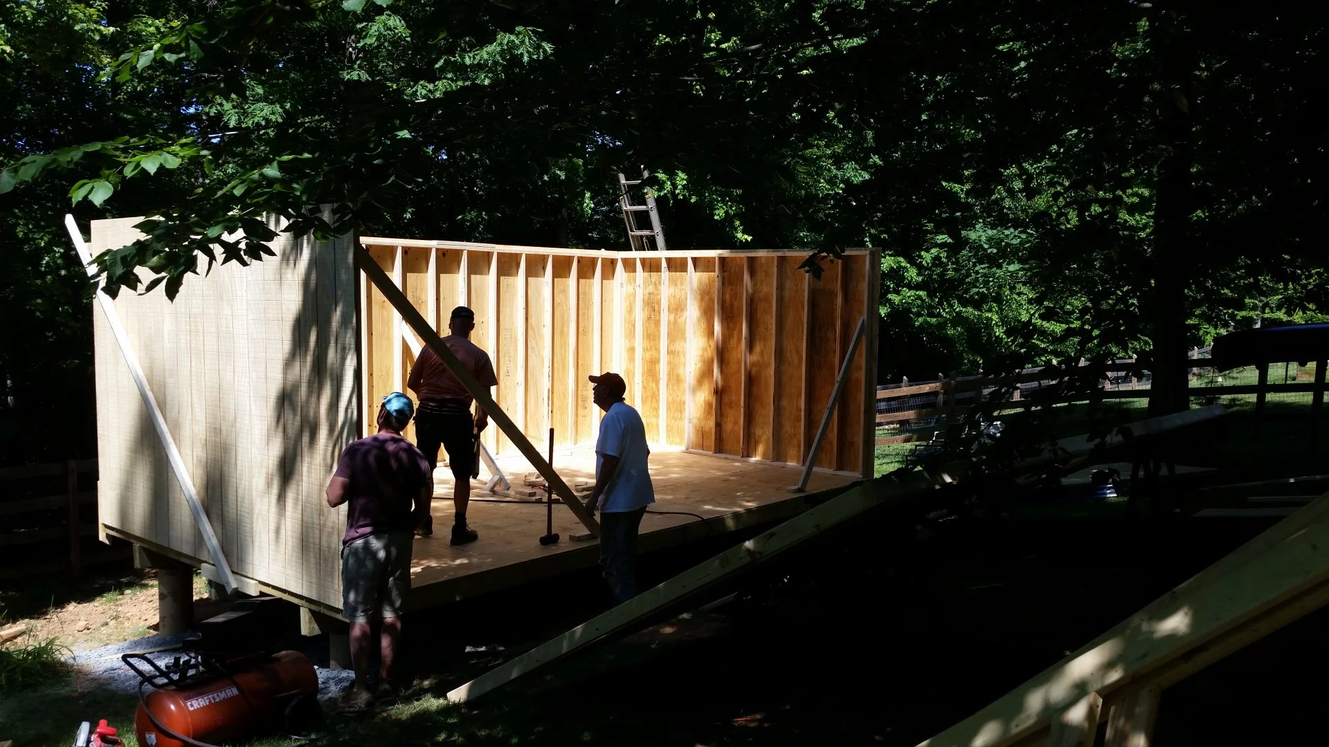

The shed is up and under roof. A 12x20 in under 5 days. The Metabo nailer worked fine. I shot 2-3/8x.120 nails for the floor, sub roof, and t-111 siding and 3-1/4 .131 for the frame. Only a few jams which where easily cleared by pulling the nails out of the magazine and clearing the offending nail. I'd buy it again if I had too. No pressure adjustments on the nailer. Had to turn the compressor down to 80psi for the smaller nails and up to 100psi for the framing nails.
They say pictures or it didn't happen. So here you go.

Nicely done.
