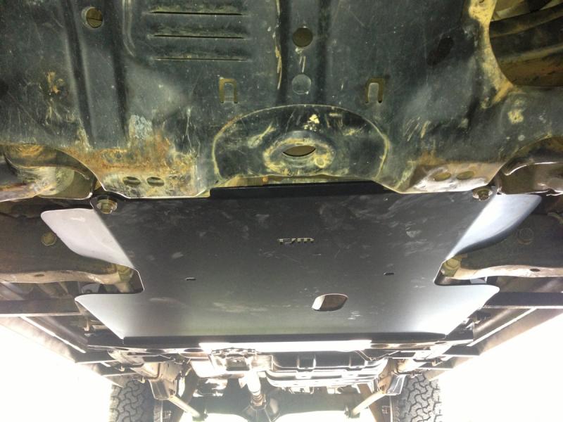

TJM Skids installed. For ~$230 from Jonesy's Offroad I could not be happier. Perfect alternatives to the skid plates available now.
