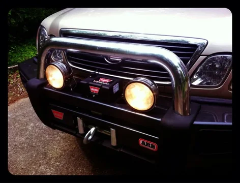

Installed these 6" KC lights that came from my Warn Transfrmer Brush Guard and are still working since 1995. Wish I could afford new but glad these work.

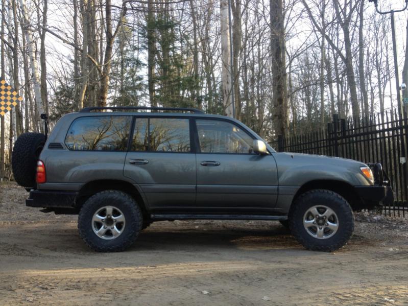

Here is my truck when I got it a few months ago, and now. I've only done tires, OME w Slee diff drop, and the rack is from my STi that got totaled. Next up are the WKOR sliders sitting in the garage. Glad I didn't wreck that little tow-light dongle. I didn't notice it until I got home. Also maybe I could use some license plate frames.

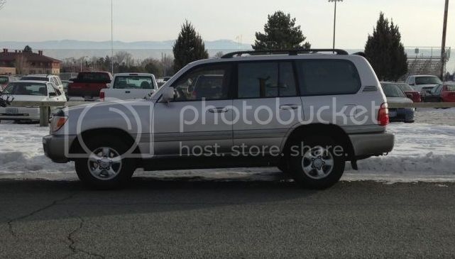

for today's small shipment, i received 80 series extended sway bar links; i think i can get my sway bar closer to stock since i've got a bit of a lift (2.5 inch). Also ordered some longer travel rear shocks that are meant for the 80 series. the hardware from my current rear shocks should swap over to the new ones and allow me to retro fit. I've been preparing for it this winter by extending my brake lines in the rear, welding a retaining clip to the rear springs (so no springs pop out if under full flex - this hasn't been documented before but better safe than sorry). It should prove to add a bit more flex and allow me to keep the rear axle better planted and reduce front wheel lifting. I haven't had a need for it yet but i'm curious to see how/if it changes the behavior and allows more track to stay on the ground.
Also picked up a trasharoo - i think these are cool for camping to keep your garbage out of the truck and away from hungry dogs:). The cruiser picture is before i have put on the longer travel rear suspension - i don't think the stance/height will be any different, but i'll post photos after as well.
I've been preparing for it this winter by extending my brake lines in the rear, welding a retaining clip to the rear springs (so no springs pop out if under full flex - this hasn't been documented before but better safe than sorry)..
That's pretty standard for using the N74L shocks. Lots of info on here.
okay, skill testing question. the n74 L shocks that are designed for the 80 series are known to fit the 100 series.. the only changes are swapping some bushings and hardware.. great. called up slee, ordered n74l shocks for the back.. problem - they dont' make them anymore and they are replaced with the 60071L shocks (all OME).. so what the hell, can't be that much different.. there is a bit of a shorter threaded top end to the shock on both the n74l and the new one i received.. i figured they would be the same.. so i went to work tonight on switching them out.. i recall doing the ome switch out last year and the rear was a major PITA.. no room for anything on the ps side.. anyways, long story short, i had to make some compromises to make it all work and i need your expert opinions to whether i'm making a major screw up.. the hardware stacked too high to allow for the nut to go on the top of the shock, so i ditched one of the washer plates that sits on top of the frame rail, underneath the top bushing on each side.. i figure the frame would act exactly like the washer and i have the rest of the washers in place everywhere else with thread going right through the top of the nut.. so its on there good..
is ditching the one washer (out of four) going to have ill effects?
thanks for opinions guys.. so far with the test run there is no wierdness.. i have to add 0,5 inch bumpstop extension to protect the shock, but that's a separate issue.. also threw on the sway bar extensions from the 80.. all seems snug as a bug..
Okay, decided to shave the bushings 1/8 inch per side to allow for washer that sits between frame mount and top bushing.

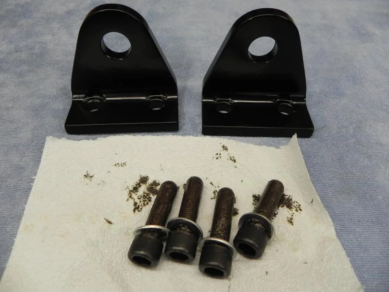

Made some front recovery brackets out of 1/2" steel angle. I picked up 4 pcs. already cut to length for $9.00 at my local Alro supplier.

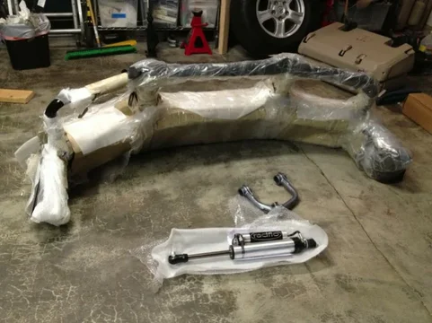

BIOR bumpers and sliders
That front bumper looks great. I really like the look of it on your truck.
