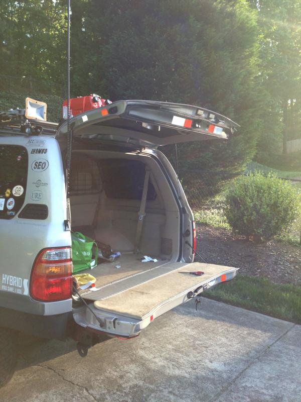

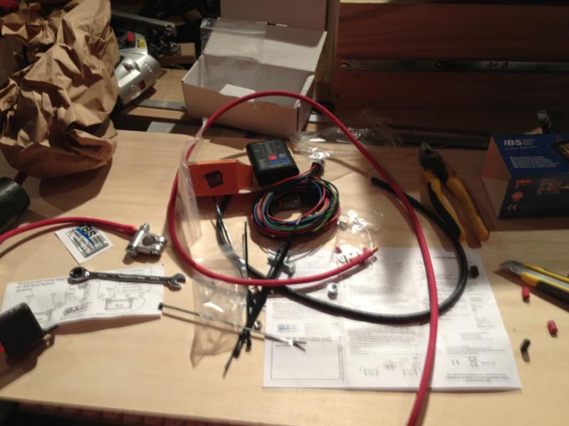

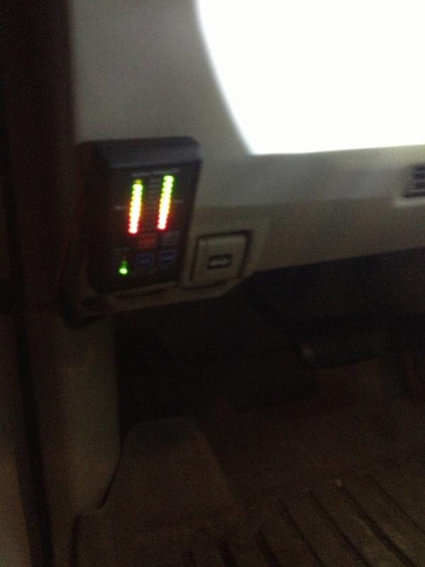

Got to try out the new toys. Worked all week to build out what I'll call a "light duty expedition setup." Includes rear cargo storage, installed IBS DBS, wired for electronics, installed TJM tent and awning... More details to follow in a future thread...

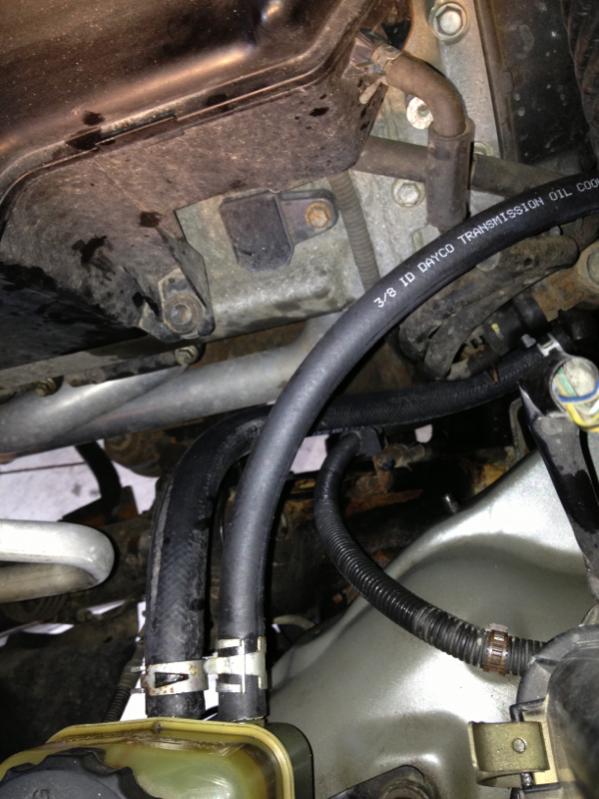

Replaced the power steering supply and return lines. I used 3/8" and 5/8" trans cooler lines with OEM constant tension clamps.
Good idea. Mine persistently leak.
My OCD grew tired of seeing mine leak, so I finally swapped them out. I swear mine started leaking when I flushed the system over to Mobil 1 ATF, but more than likely it was from disrupting the original hardened hoses.

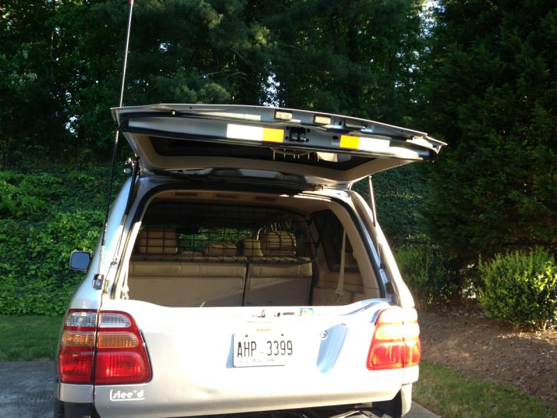

Almost had another truck hit my tail gate when it was open. It sat idle for a bit so all the lights turned off. So I added some reflective tape.

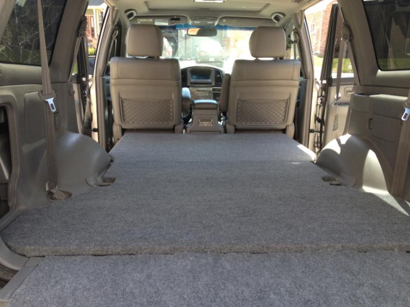

I removed the 2nd row and built a place to sleep. Bolts in and out in 2 minutes so I can use it as needed. I just leave the cargo piece in place now and added a bunch of tie downs for fridge and gear.
