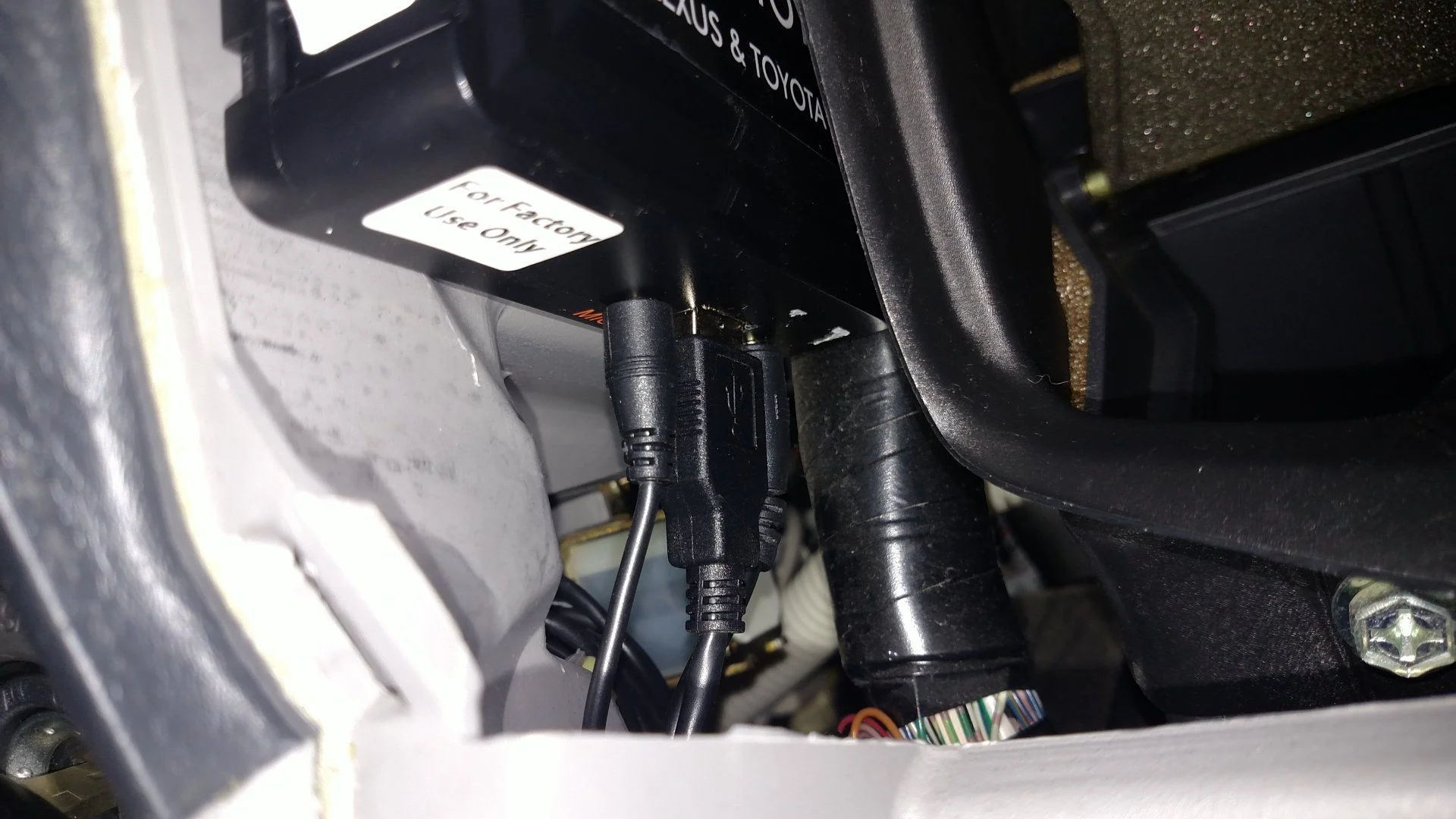

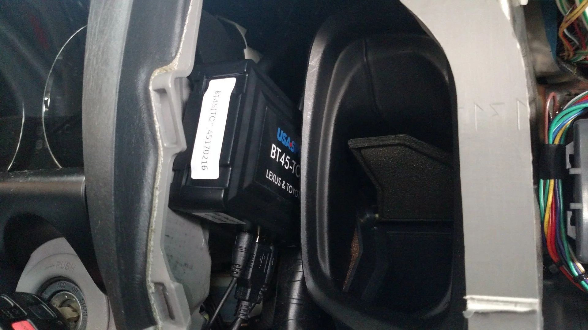

Installed my BT45 yesterday.
Went pretty well. Took me a few minutes to find a god place for it but it fits perfectly next to the driver's side vent. Easy access for USB, aux, and mic cables.
I was disappointed by this factory rat's nest. Didn't expect that in a Cruiser or anything from Toyota really.

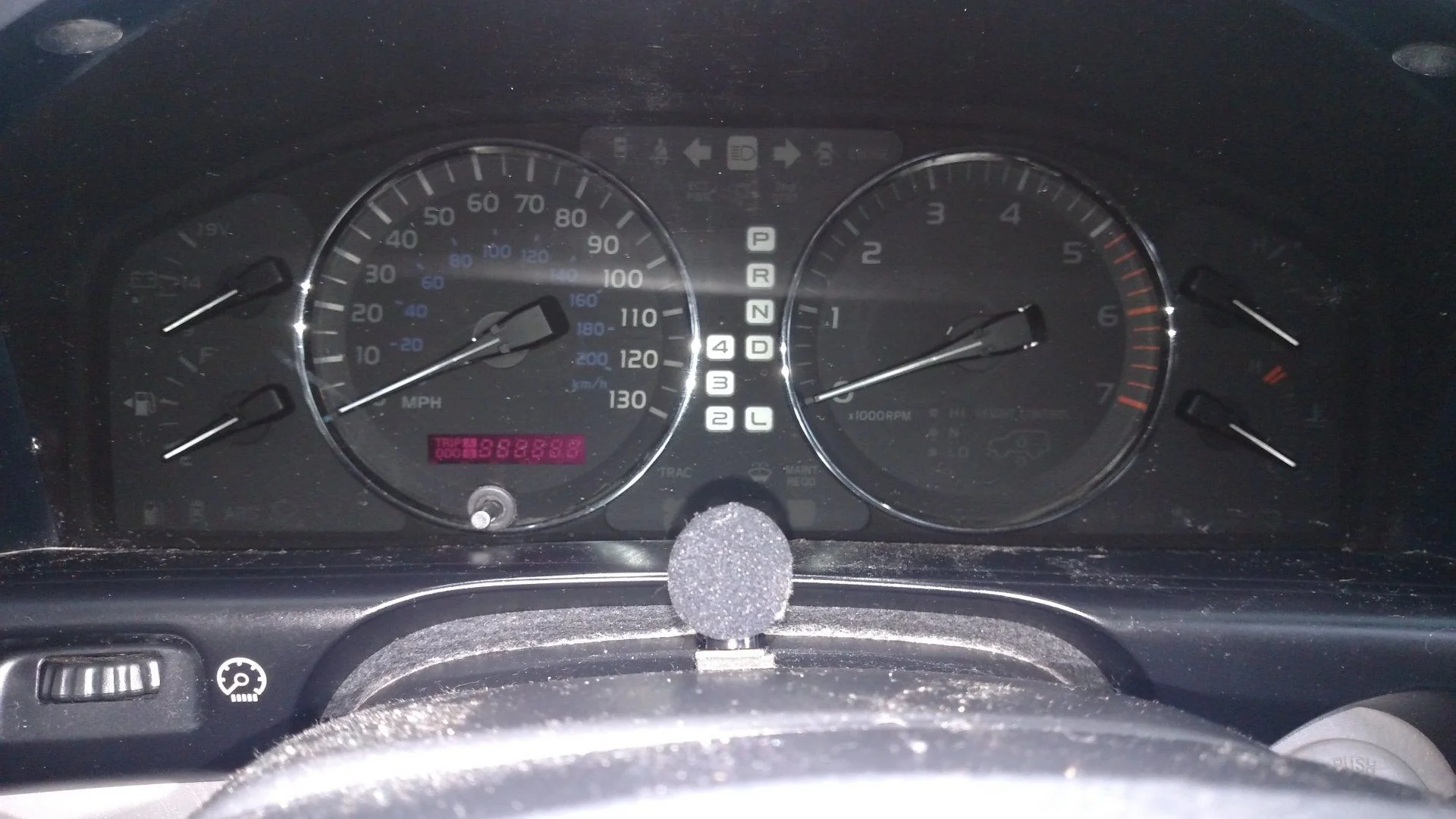

Put the mic centered on the column

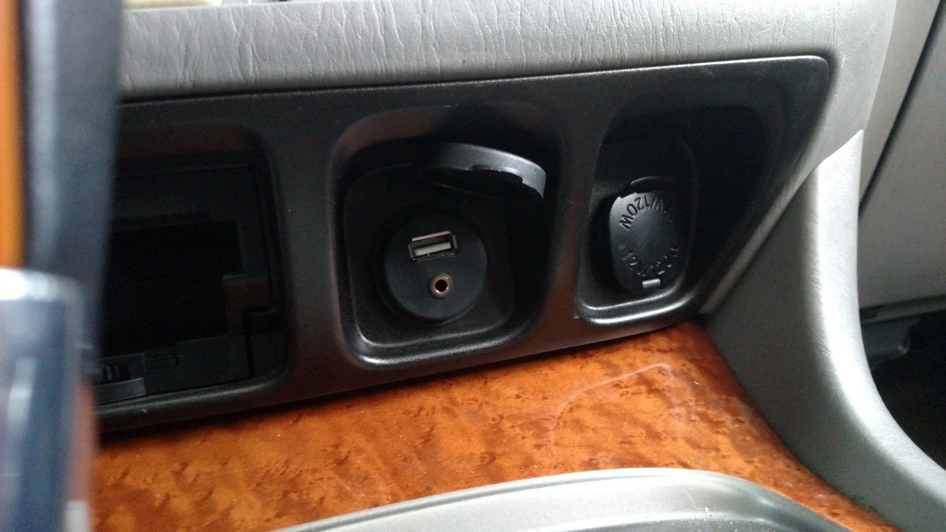

Replaced the cigarette lighter with a USB and aux port. Fits like it was made for it.
