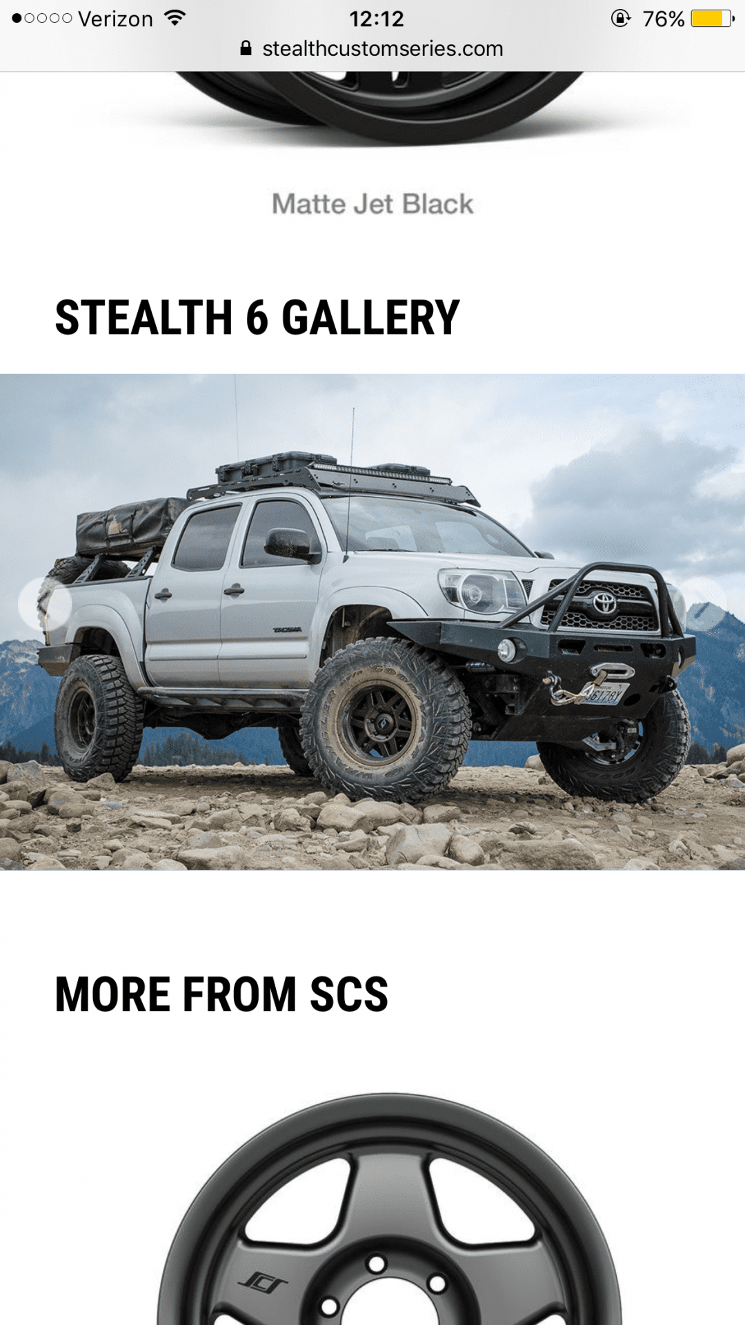

Anyone ever seen a Hundy with these wheels? The (stealth6)
There is a member on this forum here with these wheels, they look great. I wish they made them in an 18". That and I can't bring myself to throw away perfectly good wheels. His truck is either blue vapor, or thundercloud.
If I had seen these when I bought mine, they would be on my truck.

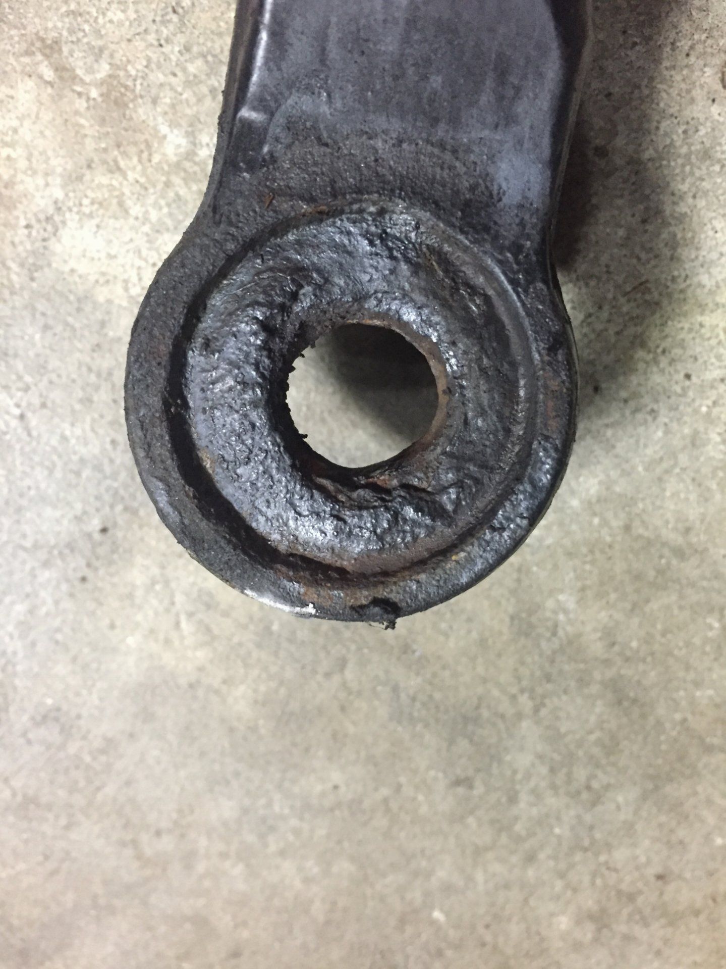

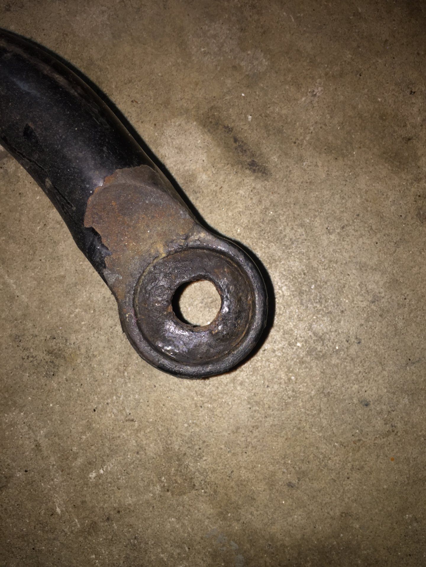

Installed some extended front stabilizer bar links fabbed for me by @reevesci. Also installed a new front stabilizer bar ( the holes where the links go through were oblong instead of round)

^ could be my imagination but the front end feels tighter, slightly flatter turning(less body roll). Could be the new stabilizer bar, or the combination of both extended links and new stabilizer bar.
I've only driven it 15miles, but so far it feels worthwhile. The links now sit upright vs being pushed over.
Not sure why this mod hasn't been addressed earlier(other than a couple of inmates doing some R&D). Seems to me when you lift the front 2" you need to adjust the stabilizer link height at the same time( same as the rear)

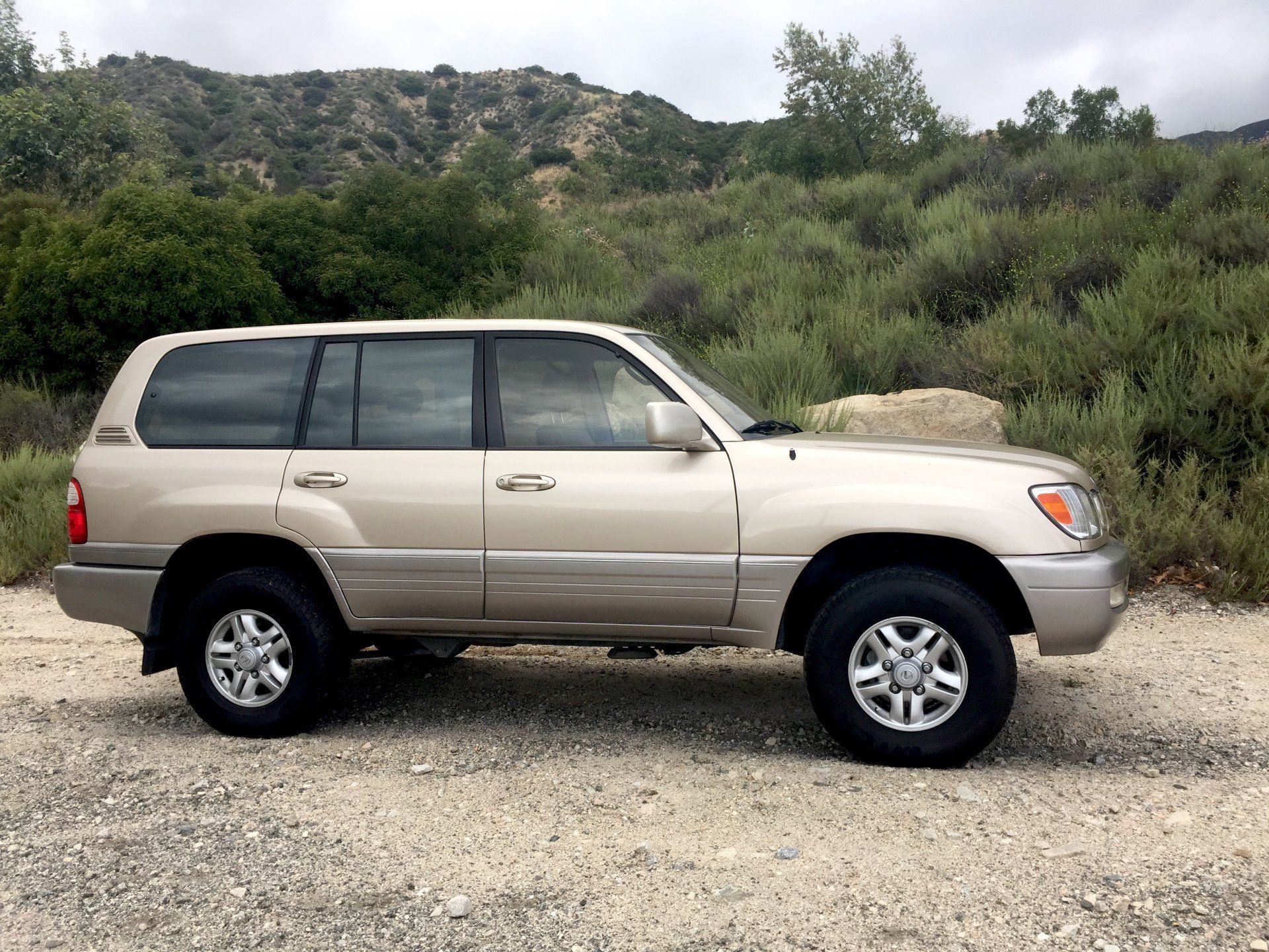

New to me LX470 and first modification. Took off the running boards. Very happy with the results. Seeing everyone's work is very inspiring. Love these trucks!
Before:
After :
Looks great, you also removed the roof rack... how did you cover the remaining holes?
I covered mine provisionally with tape until I receive the plastic covers
Hi, The rack was removed when I bought the truck. I don't think it ever had one. There are some plastic/rubber strips over the location of what would be the mounting locations. Let me know if you want pictures.

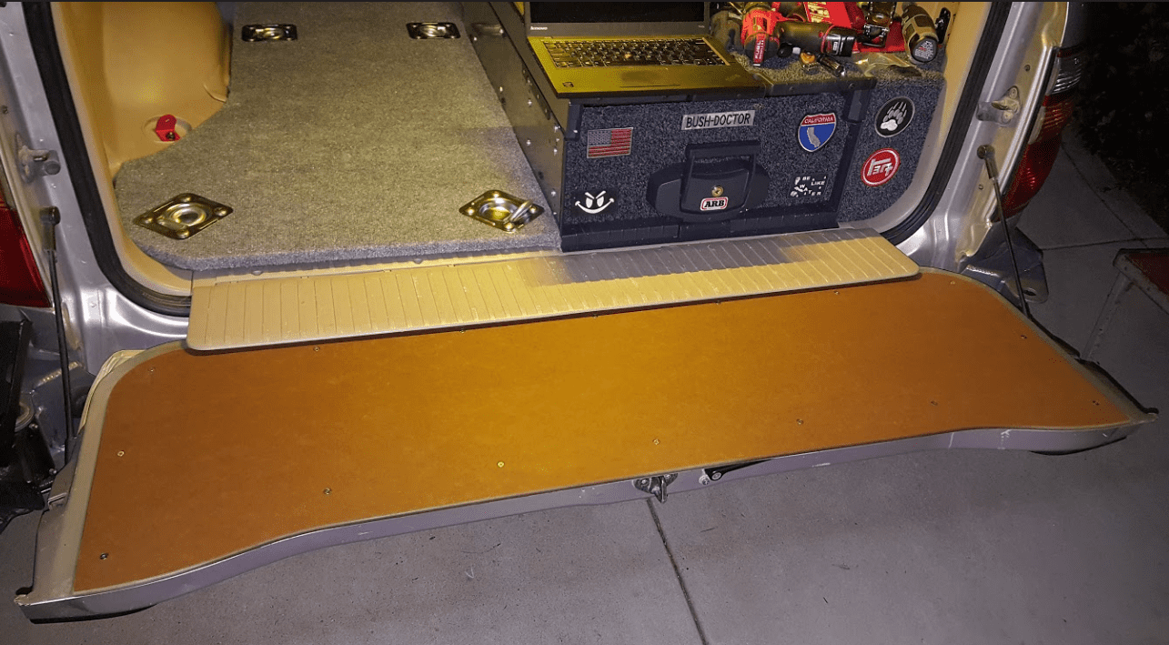

Tailgate refresh R50 Richlite thanks to @TrekboxX
